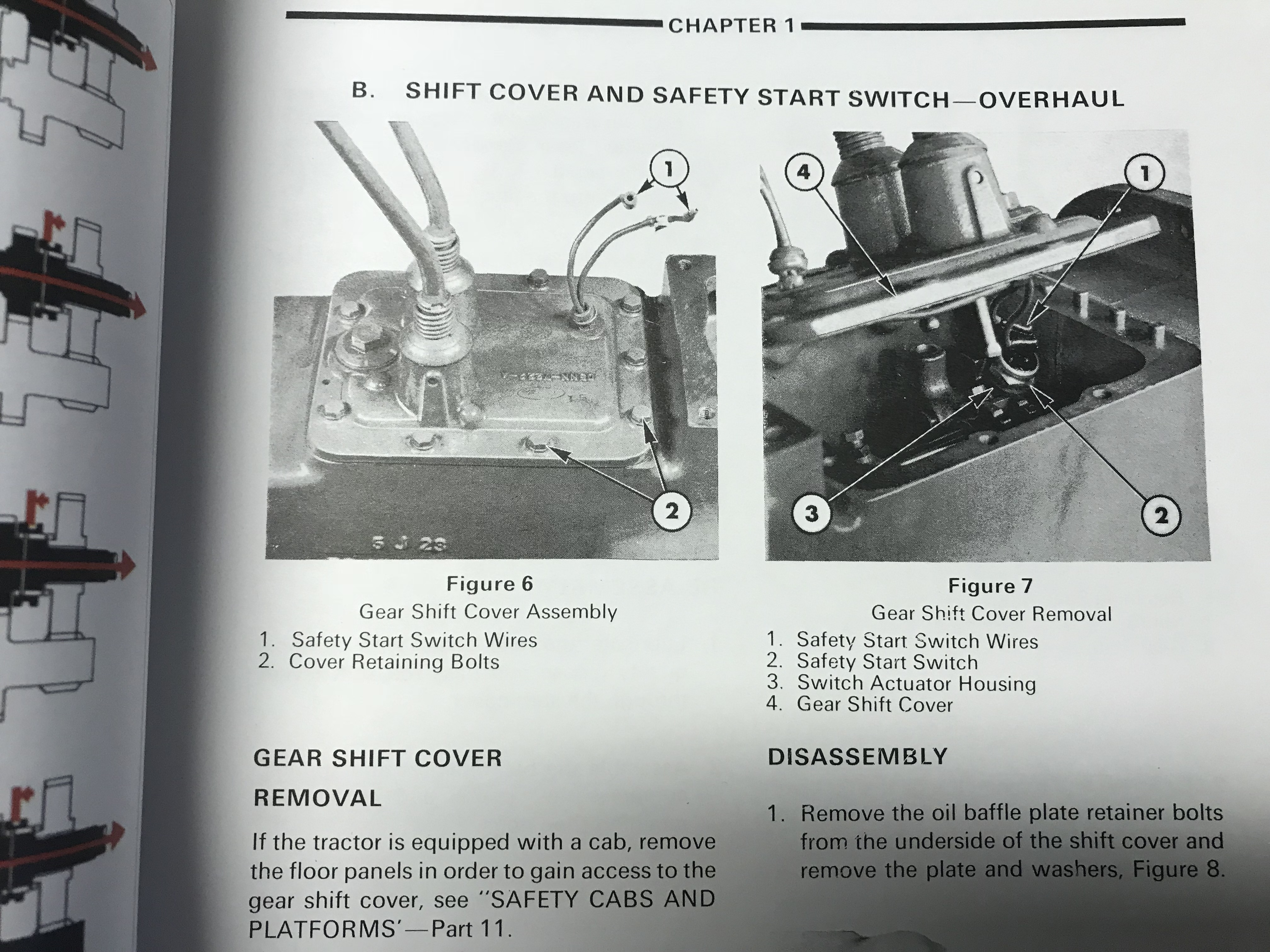

Ok I found my manual. I don't really like there manuals. Using them is like working your way thru a maze.
Anyway 2 pictures regarding the transmission safety switch. One picture shows the cover with the switch wires extending from the cover. You can disconnect those wires from the wires leading into the tractor. Connect a continuity tester between those 2 wires. With transmission in neutral you should have continuity. If no continuity then switch is bad or not aligned properly. If you have continuity the problem is not the switch and you have to look elsewhere.
Page two give minimal instruction on switch installation and adjustment. You really have to look inside to see what is going on.
All this is if your tractor is like mine. The manuals I have cover many different tractor models. That is why the manuals are somewhat confusing and A mazing. Lol.
Hope this helps.
