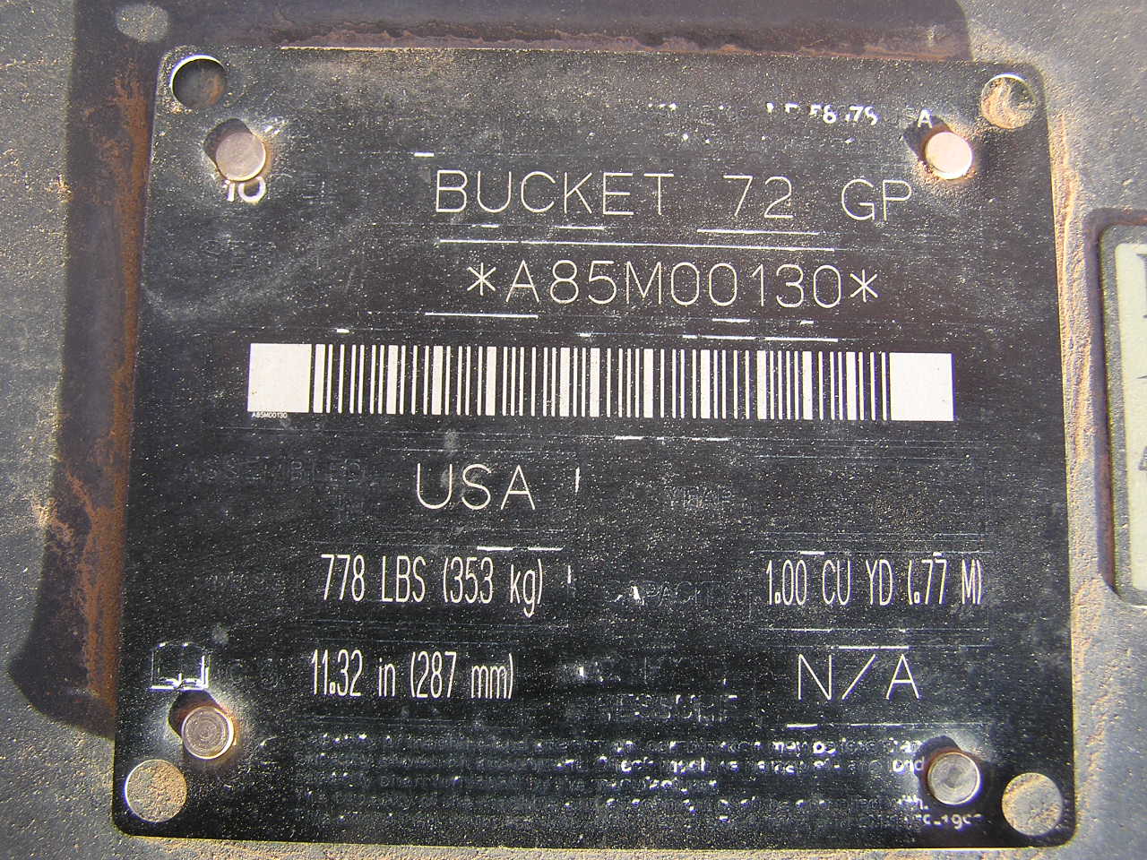

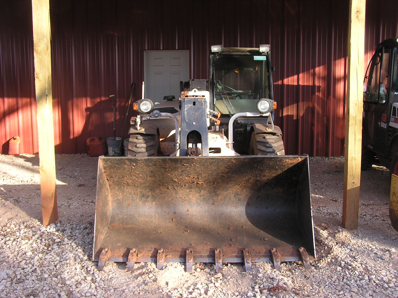

Call a Bobcat dealer and ask if they have a 72" General Purpose Bucket, part number 7140706.
6' wide, 1 cubic yard, SSQA.
The Bobcat dealers around here have rental skid steers.
