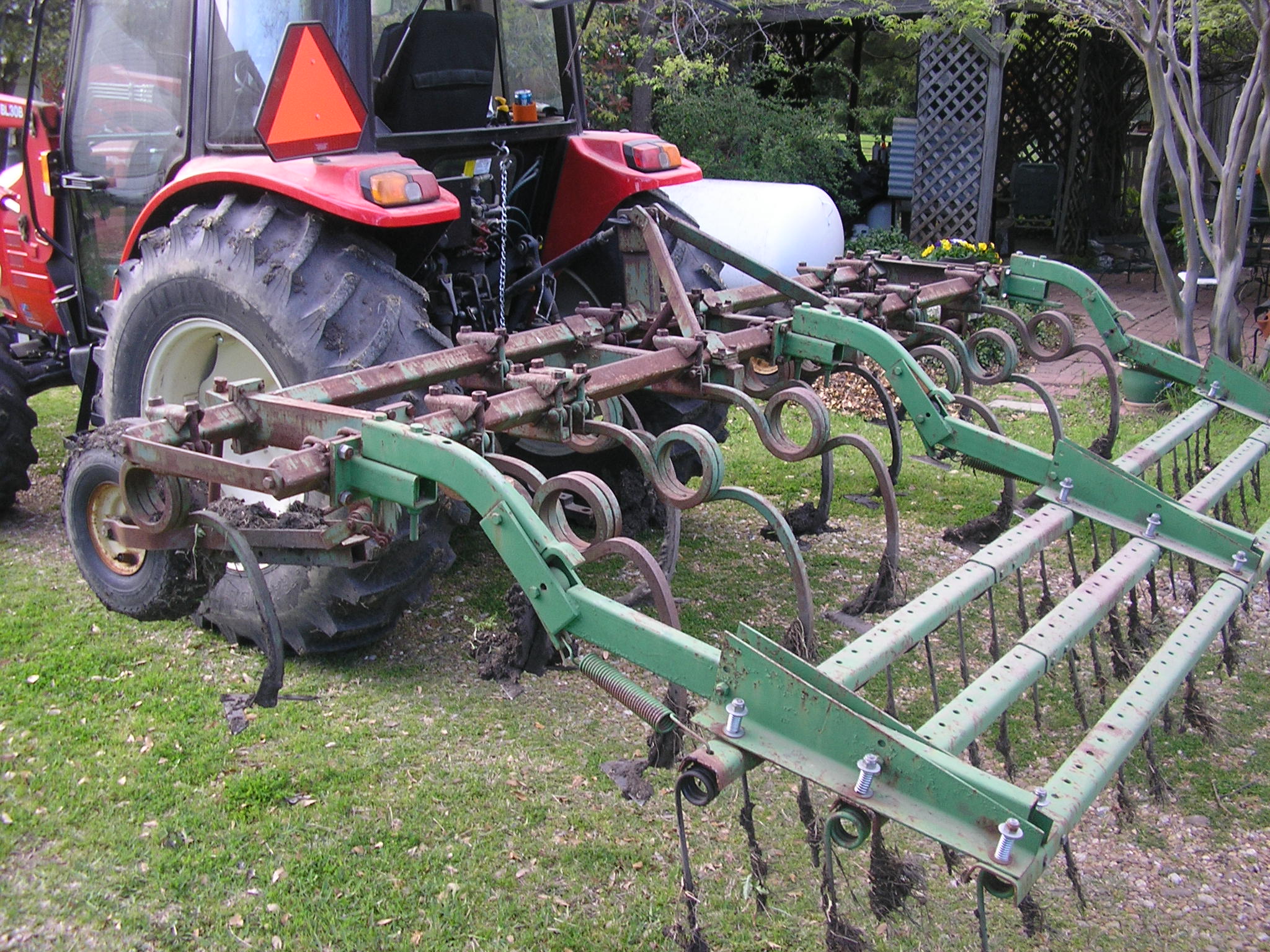

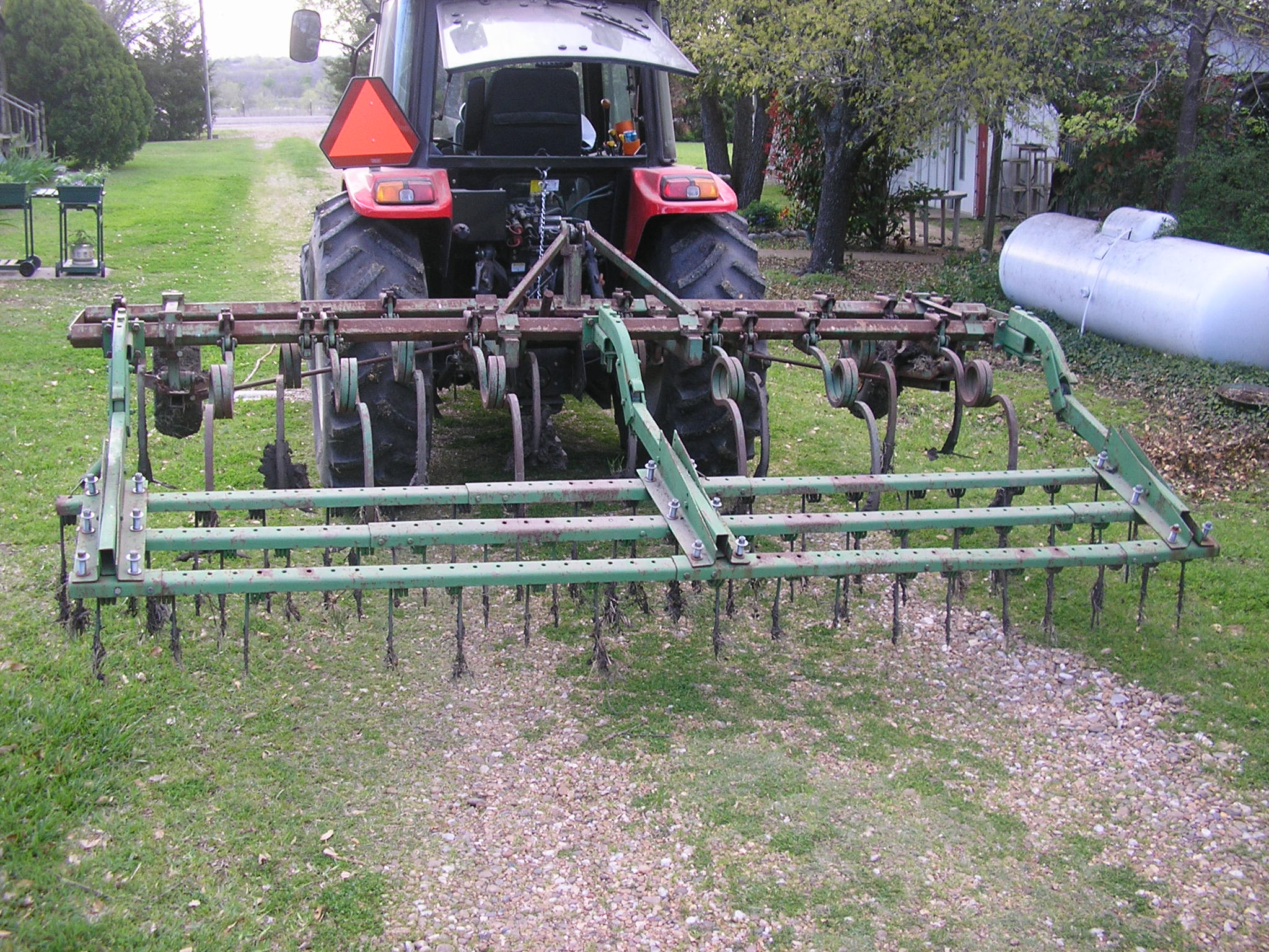

For many operations like soil tillage, fuel consumption is significantly increased when operating in 2wd. This is because a lot of power is wasted pushing a "dead" axle thru the ground. If you ever want to check this out, notice how much more throttle it takes to pull a disk when you are in 2wd than it does in when in 4wd. Most folks here realize that fwd lets a smaller tractor do the work of a larger 2wd. Smaller tractor, same work=less fuel. If you have fwd the only time you should not use it is on the road. As fuel costs have risen, the popularity of 2wd has decreased, especially for ag operations.
My Branson is my first ever 4wd vehicle. In a tractor I noticed a lot of smaller 4wd tractors being used around here. I had a 100 PTO hp JD. My Branson is 57. I have one instance where I can pull a cultivator assembly with the Branson that I pulled with the JD and just as fast. I run B1 or B2 out of a range of C4 gears @2600 rpm pulling this with only 57 PTO 4wd. Not bad. When I forget to engage 4wd when plowing it only takes a few feet to realize I forgot it.
I totally agree that the extra drive axle makes a big tractor out of a little one and my little one is much better on diesel.
Mark
