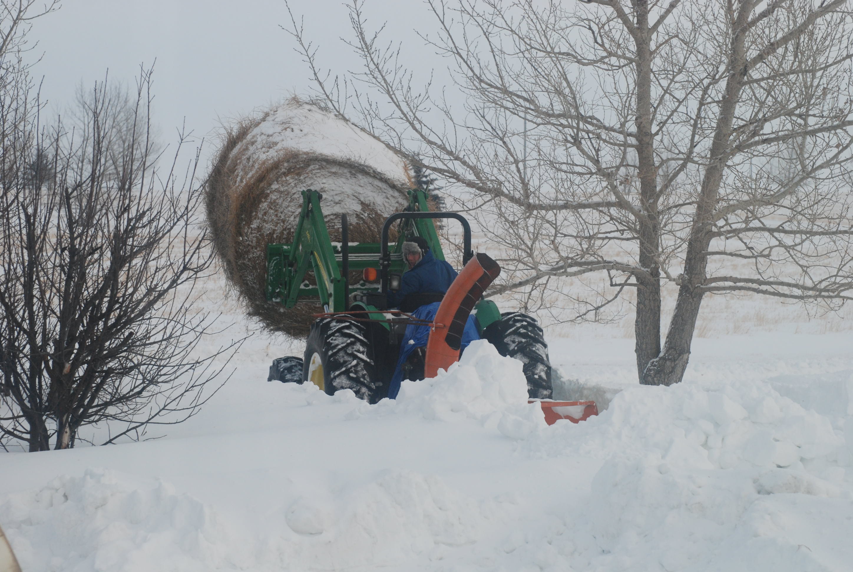

One thing I haven't seen mentioned yet is the number of gears or speeds in each direction.
I have a nearly antique rear mount v type fan snow blower:
I think the v plow requires more traction to push the snow into the fan so I had to grab a bale with the loader.
Backing is a bit of a literal 'pain in the neck' but what I find most problematic is having only 3 available speeds in reverse versus 9 going forward. It makes it hard to balance keeping the blower nicely loaded for maximum throw and overloading the machine by going too fast.
I only have to use the blower about once every 3 years for exceptional snows or drifts so it's not worth converting it, but I would much prefer it hydraulically driven and quick attach to the loader.
