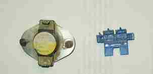

Anybody out there have a picture (or, would be willing to take a picture) of the top of the fan temperature switch that shows the text/numbers on it?
Mine's gone missing (the top of the switch, that is) and I want to replace it. While I could go directly to P/T, I've found their spare parts for pass-through items (i.e., "no value added") to be quite high! I'd like to bypass the middle-man on the commodity items, here. But, I need the info to get the right part. So, any help out there?
I searched the forums and found only a few references to this switch. "Woodlandfarms" had a posting ("What is this") where the first photo was of the switch, but it was from the side and I can't read the text.
Thanks for any help anyone can provide.
/ PT-422 Fan Temperature Switch #2
Not the best picture, but it's something. I believe this is a clothes dryer temperature switch, but it closes when it gets hot.

BobRip & frischtr:
That identifies it...White-Rodgers Therm-O-Disc Snap Action Fan Control switch, Series 60T, model 3F01-120. Closes at 120F, opens at 110F.
Now, to get one and do the replacement!
Thanks so much for your gracious help!

I talked to the manufacturer of the switch today. The switch being used is not rated for DC. They do have a switch rated for DC, but only one amp. The fan pulls about 5 amps. I would recommend that if you care, put in a relay that is driven by the switch. The relay then controls the fan. I am at 850 hours and have replaced the switch once. I would say that's not too bad. I will continue to replace it. It does not cycle much so it does not wear out too quickly.

I have the same switch on my 1460, and I just ran a current clamp on it, and it pulls 7.4 amps DC. I guess I should look at a new solution, or expect to be switching this thing out a lot. I will give Terry a call and see what he thinks.

I know that, I was just stating the amps of the fan on the 1460, that's all. The higher the fan current, the more trouble the temp sensor will be. If people are having trouble with the 5 amp fan on the 422, I am probably going to have trouble even sooner. It is a very easy fix with a relay, so I think I will go ahead and get one.
