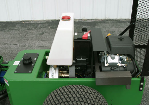

I have two pumps bolted together in front of the engine with exhaust outside the engine compartment from the front of the engine. I have tried to attach a picture (it is the same configuration shown on the Power Trac website.

Looks almost like my 2005 PT-422, except my battery is on the floor of the tub instead of in front of the exhaust manifold. From the looks of it, your engine tub must be about 4" longer then mine.
I think the Kohler ECH749 (26 hp EFI) would be a nice engine, and Small Engine Warehouse has a couple for $1600-2100. Specs on this state it is 2.3" longer than the Robin EH72, so it might be a bit crowded.

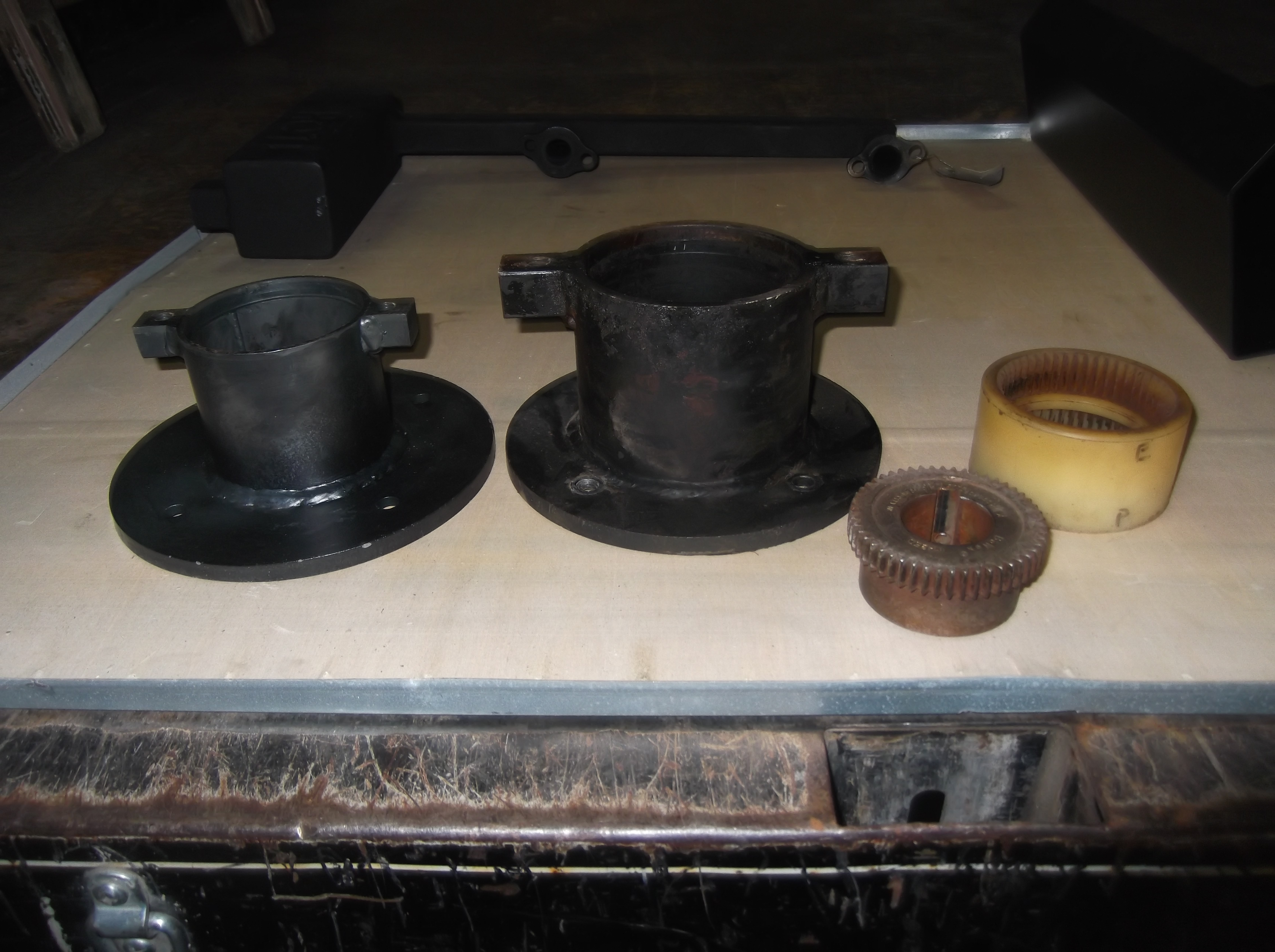

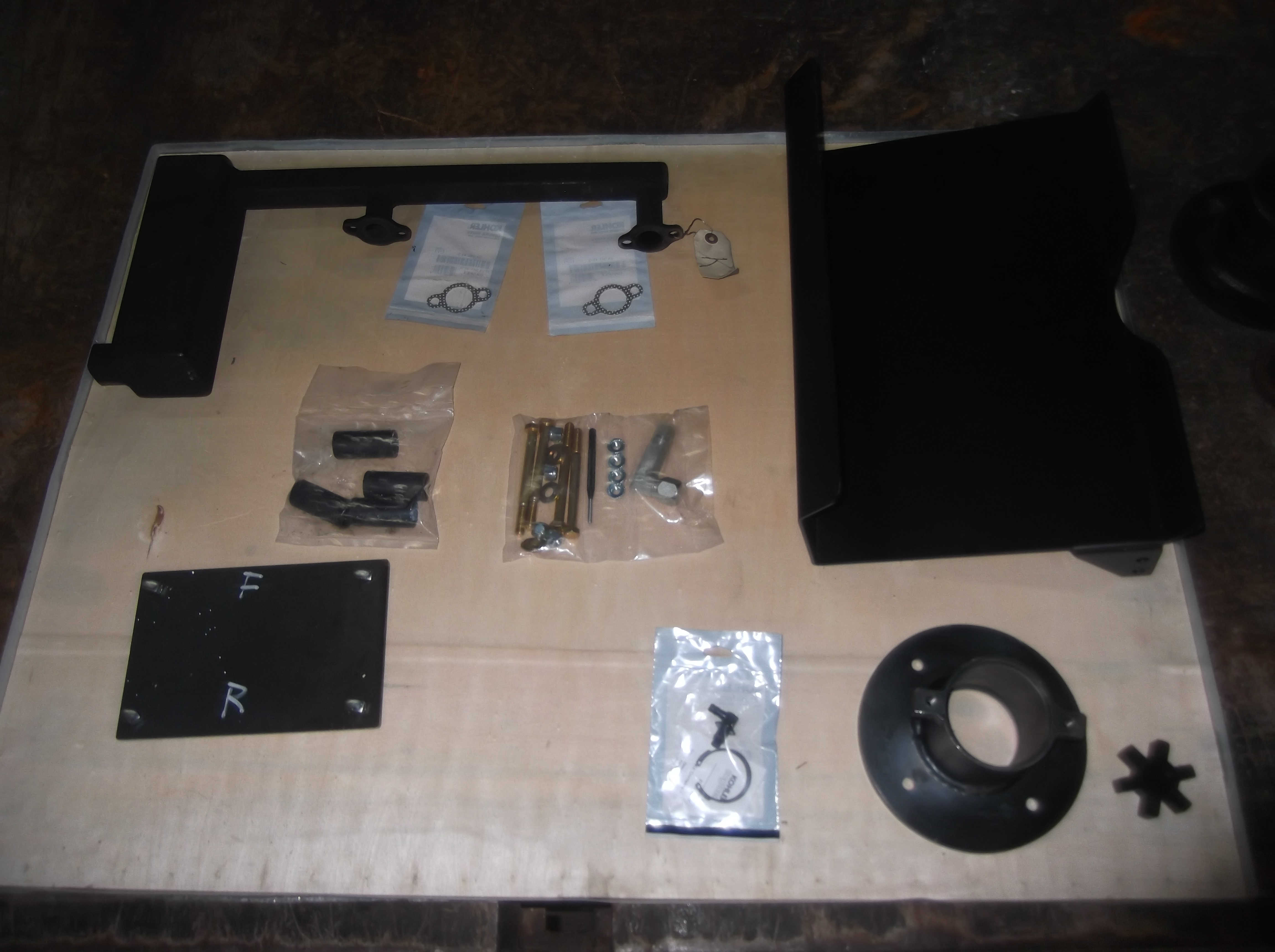

I finally got around to pulling the hydraulic pump out of my 425. Dragging my feet on this project has paid off.
As you may already know, the Robin EH72 engine has been discontinued. Power Trac now sells a conversion kit that allows you to drop in a Kohler CH730-3208 engine.
The kit costs about $300 and includes muffler with gaskets, heat shield, new mounting spacers with bolts, a fuel elbow, an oil drain elbow, pump adapter, and a pre-punched steel plate to convert the existing mounting plate in the tub of the machine. I have included a picture of the kit below.
The existing pump adapter on a Robin engine will not work because the engine side pilot (ie the flat part inside of the outer rim) of the adaptor is only 6 1/2" instead of 7".
As it turns out, my machine is one of about ten that was build with a spline connector between the engine and pump. Seeing how much heavier built mine is, I feel I got lucky. I have attached pictures of my pump adapter/spline connector next to the standard love joy style. Mine is on the right. The round housing portion of my adapter measures 4 1/2" across vs 3 1/2" across for the standard style. In addition, the ears to which the pump bolts to are 1" across vs 3/4" across on the standard style. The guys at Power Trac said they have sold 3 or 4 conversion kits so far and will now ask people to confirm which connector they have between the engine and pump. They happened to have an adapter for my connection style on the shelf and are sending it my way.
The other differences I see in the parts I received vs what I have is that the heat shield is about 1 1/2" taller and the pipe spacers used to mount the engine to the machine are about 1" deep.
The engine is on order and the pump is in the shop. I will snap a few photos when I start putting things back together.
