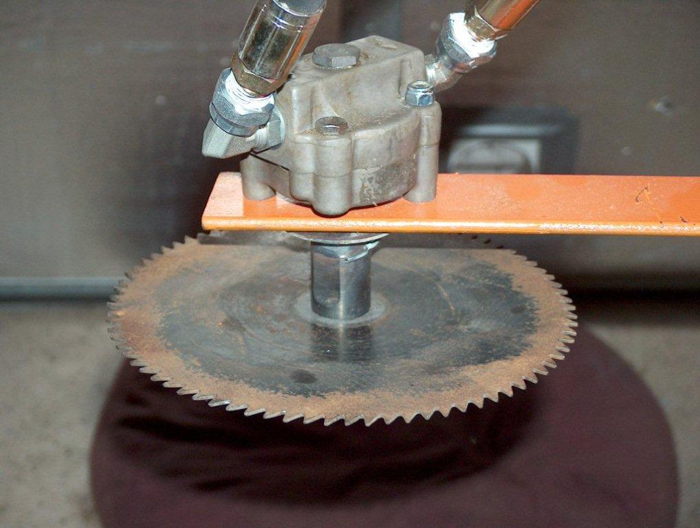

mlhunter,
This is about as simple as it gets.
