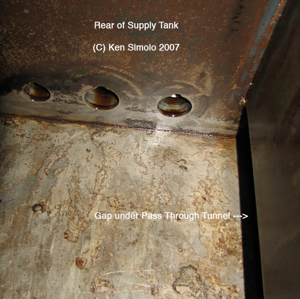

Also, I don't know how my tank is designed. Is the bottom open all the way across? If so, you would need two oil sensor cause of slope work. one on each side of the tank..
Thoughts?
My recollection from cleaning it is that it is connected.
Ken
Edited: Checked my pictures at home. There is a gap underneath the pass through tunnel. See attached image.
