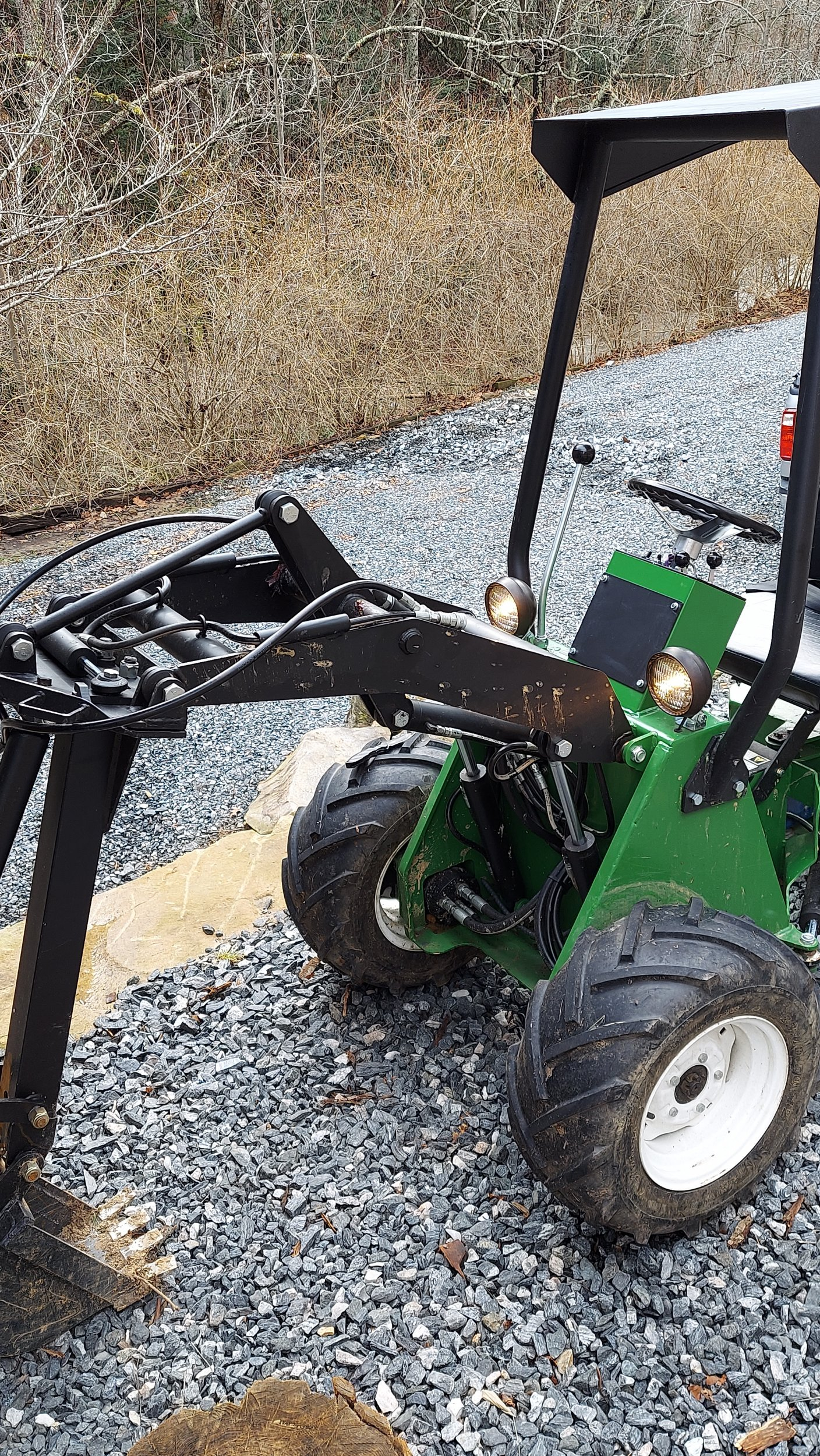

What are the plans for the mini-hoe?

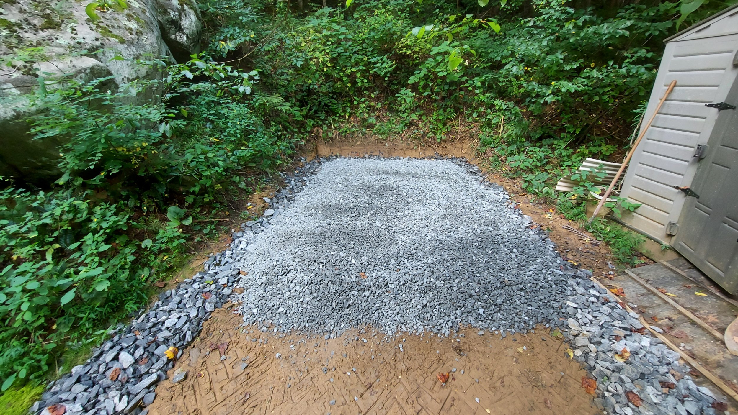

As for the mini-hoe, so far I've used it to make a French drain around the grading I did with the 4in1 bucket so we could erect the garage tent for the PT. The mini-hoe will get a lot of hours in the next six to eight months... my wife and I have are building four glamping sites on the side of the little mountain we live on. I'll use it grade footer locations, dig more French drains to redirect water runoff, and whatever else we can dig into.

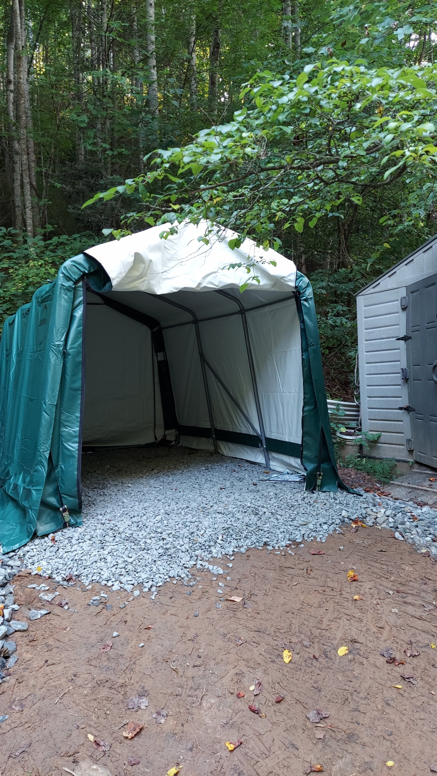

Attached some pics of the tent progress...

What is the life span expectancy of the tents?

We have a ShelterLogic shelter as well. Even in the Californian sun, and a high wind site, the basic cover (PVC) versions have lasted last seven or so years. This last time we went with PVC; twice the cost, three times the rated lifetime (we will see...).

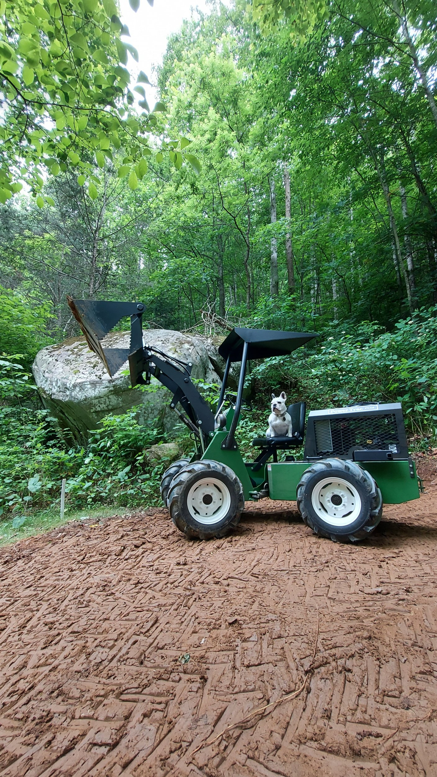

Cute photo with your dog.

I really like the Shelter Logic so far. We've had 12+ inch snowfalls a few times this winter and it holds up great. I have to loosen and re-tighten all the ratchets to try to get the cover repositioned and taught over the skeleton inside. It just doesn't look as clean as the pictures shown on the website.
Saby's a cool girl. She's Canadian. My wife and I adopted her while we were living in Winnipeg MB.
That PT1445 looks like an awesome machine. What are you using it for? What attachments do you have?

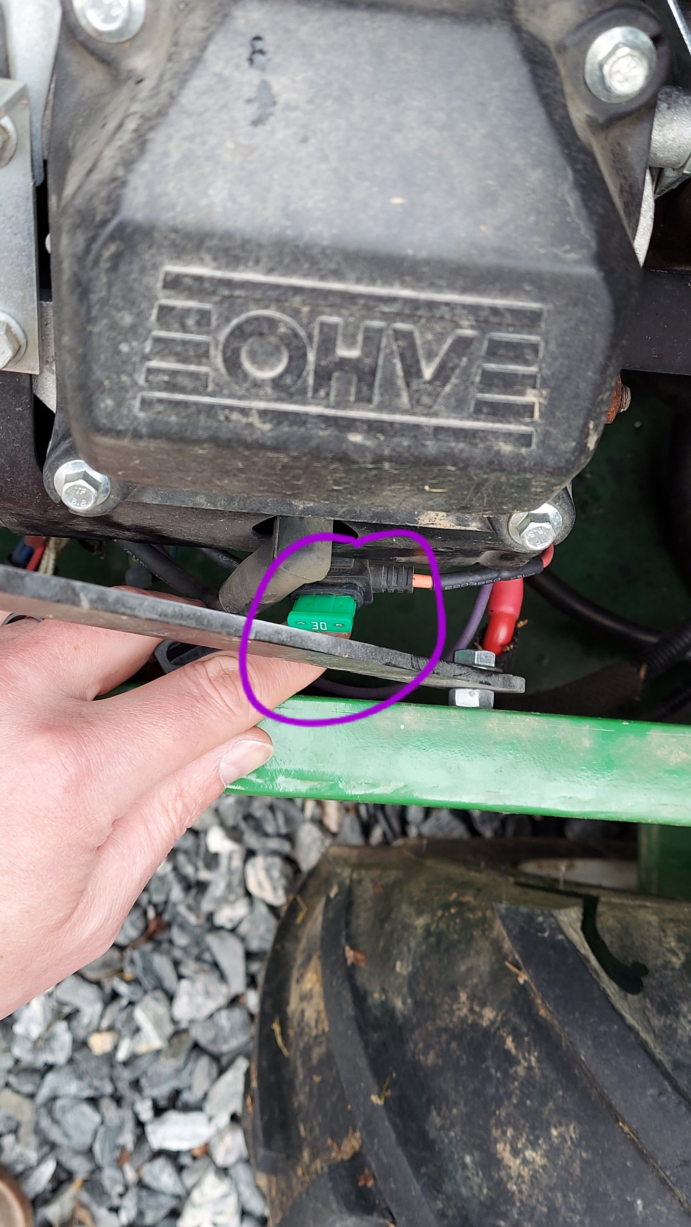

Got it figured out last night. The Kohler engine on the PT425 has a 30A fuse in place for this type of screw up. No breaker to reset on this lil puppy. Pulled the fuse and it was blown. Went to Napa today and put the new fuse in... she started right up. Napa had the bulb I needed too.
Pics of fuse and bright lights attached.
I also gave Terry a call this morning. He's sending over a new bulb and housing along with a 30A fuse. Great guy.

@plottamus I have found that the crossbars that are in the sleeves of the cover fabric to be the cause of all of our wrinkled covers. I now leave the end straps tight, have someone else stand outside on the cross bar (on the cover, carefully, with tennis shoes.) at one end of the bar, while I quickly loosen and then tighten the bolts on the crossbar. For the middle bars, don't forget to loosen bolts on both sides so the crosspiece can slide freely down. I start on one end and work my way to the other. I do whichever side has higher crossbars, and I would wait for warm weather.
The full list of attachments is in my bio, but I use the 1445 to build and maintain everything here on the ranch(ette). I don't have the minihoe, nor the sweeper, though I badly needed the latter recently. Digging up water pipes (digging up a broken main water line with the 4N1 in wet clay was one those "this just paid for the tractor" projects. The wet clay soil here is 70+lbs per shovelful, and it sticks to the shovel as if it was magnetic.), laying them, fence building, terracing, mowing invasive species (thistle, poison hemlock), rototilling invasives(hemlock), making a foundation for the cattle sweep and ShelterLogic shelter, maintaining the garden & arena & access road... Yesterday was tree trimming the trees in the driveway and chipping the limbs (clearance for fire trucks, and reducing fire risk by chipping).
