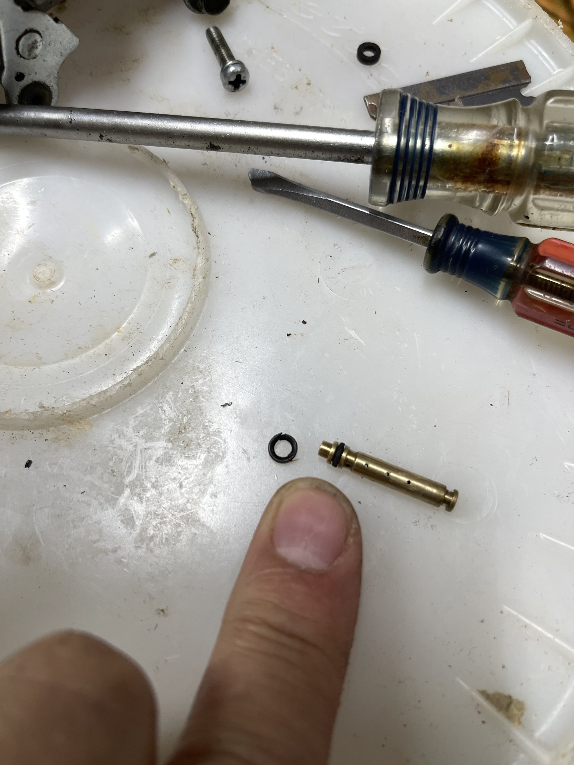

Couldn’t find a small enough replacement o-ring, so now I’m waiting on a new carb to arrive. (And the snow and cold to moderate 🥴)
Just out of curiosity, how small is small? (I think the new carb is a good idea, I'm just being inquisitive...)
All the best,
Peter
   / PT425 towing mode??
#32
All the best,
Peter
Hmmm…let me attach a pic and see if that helps…

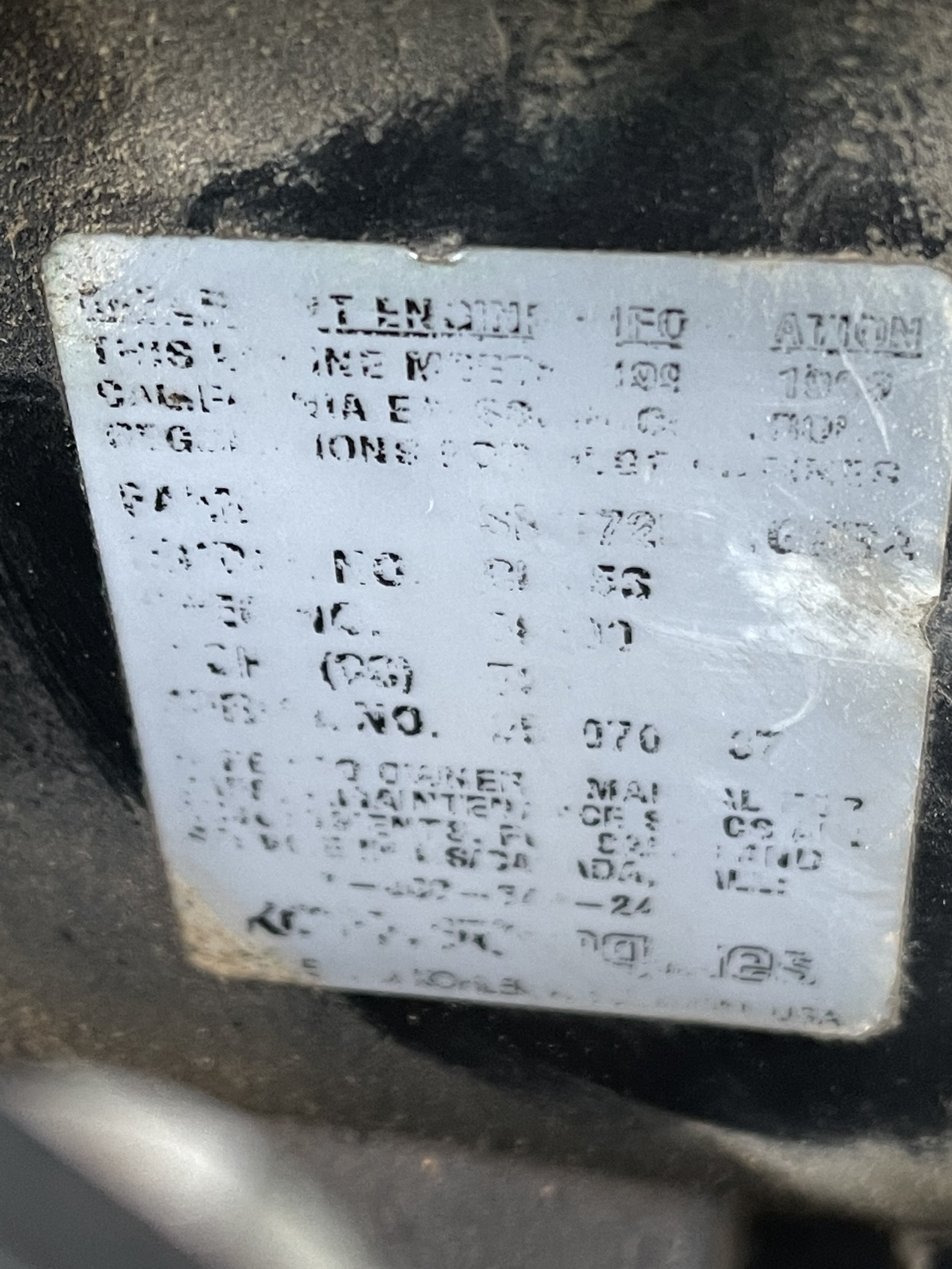

Here is the spec tag which over time has become illegible but I think it is a CH25 and maybe an S added to it ? EDIT: closer viewing, could it be “725”?
REVISED EDIT: upon more investigation, I now believe the “725” part is from the FAMILY line, and on the next line I can make out “CH25s”

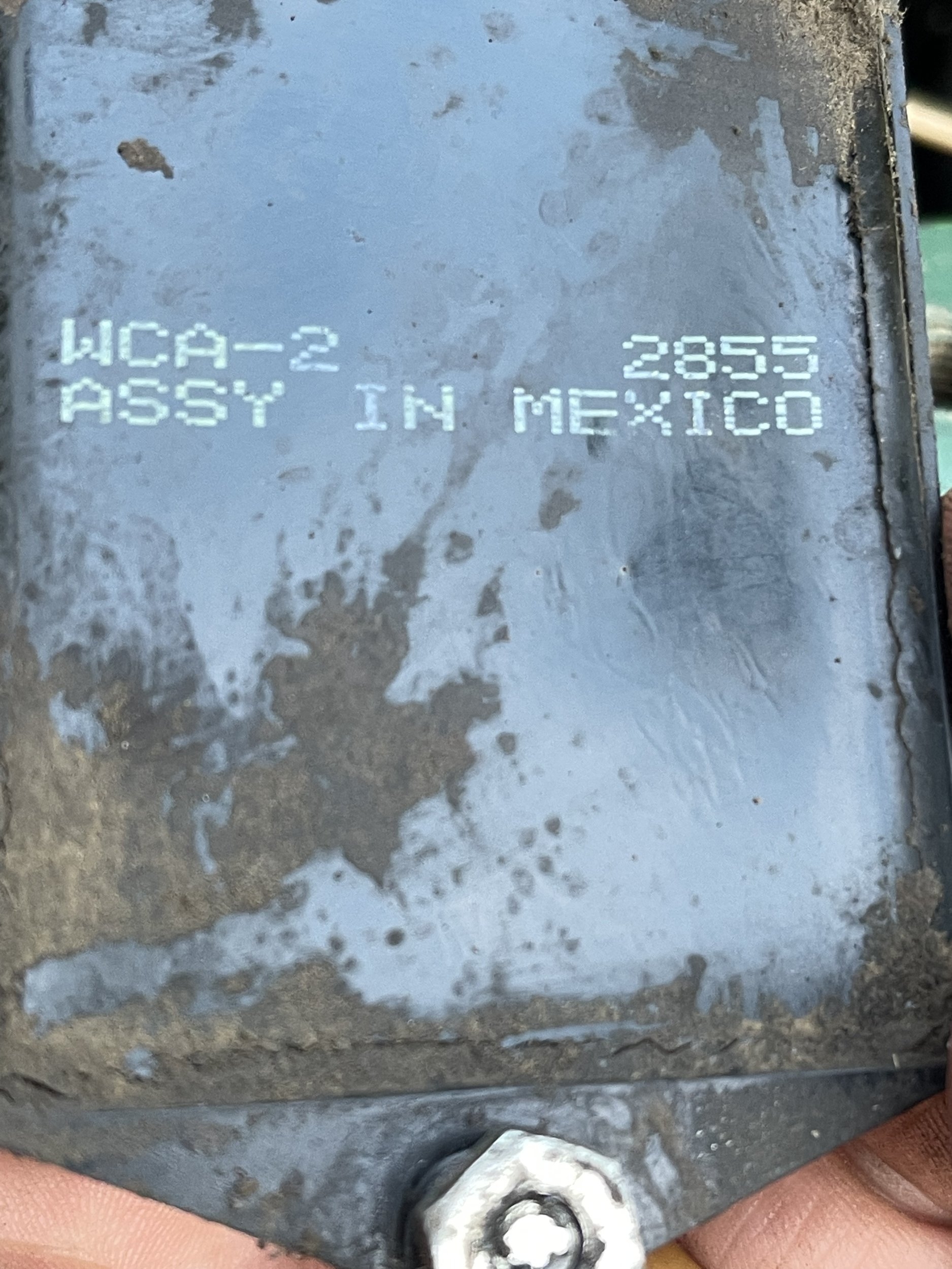

And the ignition module backside showing numbers.

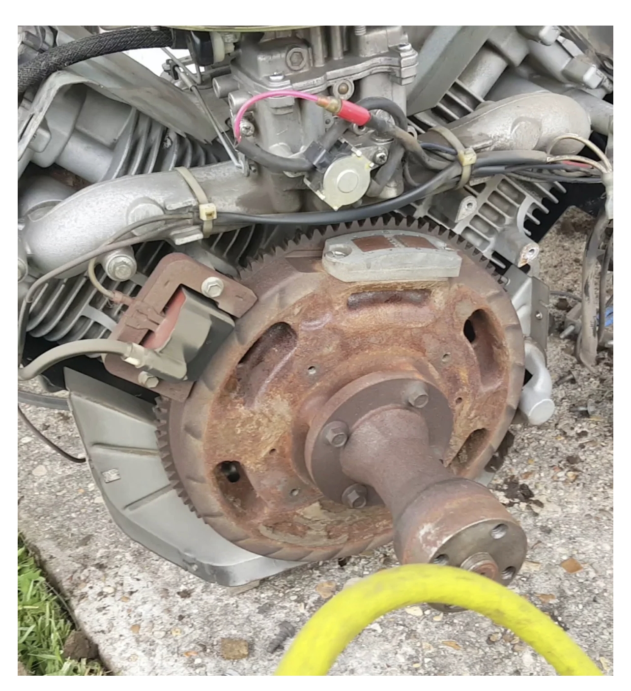

Here is a pic I grabbed off the net (not mine) but looks just like it. This pic doesn’t show the second coil unit on the right, and…my coil units have two spades/ two wires each…
