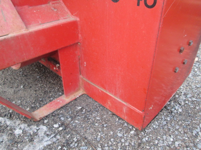

I can’t tell from the picture if your blower has a cutting edge, but my blower without a beveled cutting edge would also ride up on snow. I used it this way for a few years riding on the housing steel, then got tired of it and had a nice edge welded on. It now doesn’t ride up, and works much better.

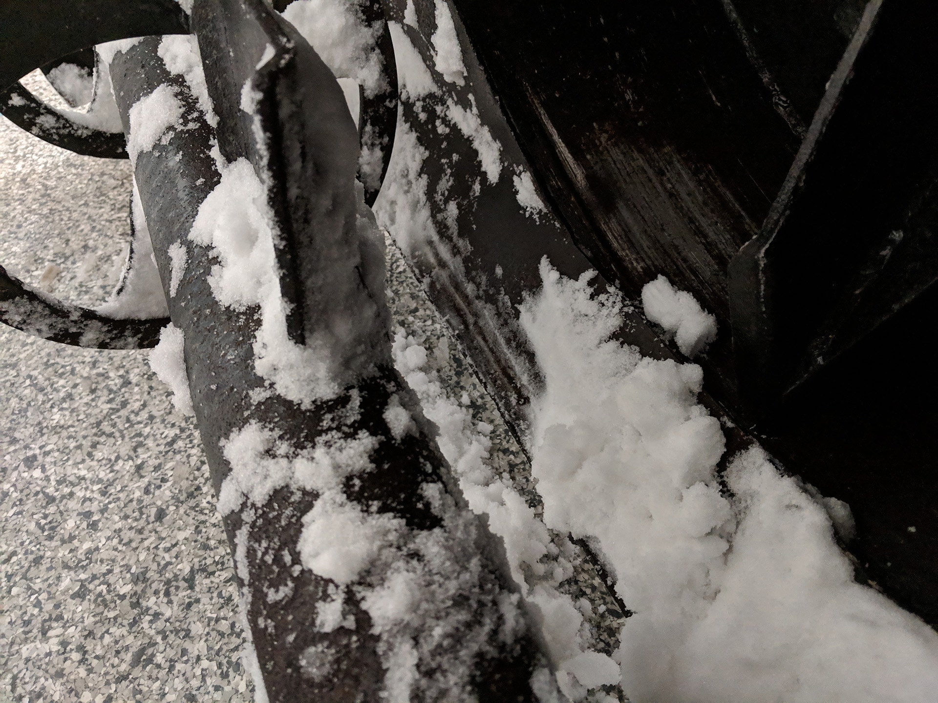

Ok, update after trying to wrestle with it some more.
Added a bunch of photos

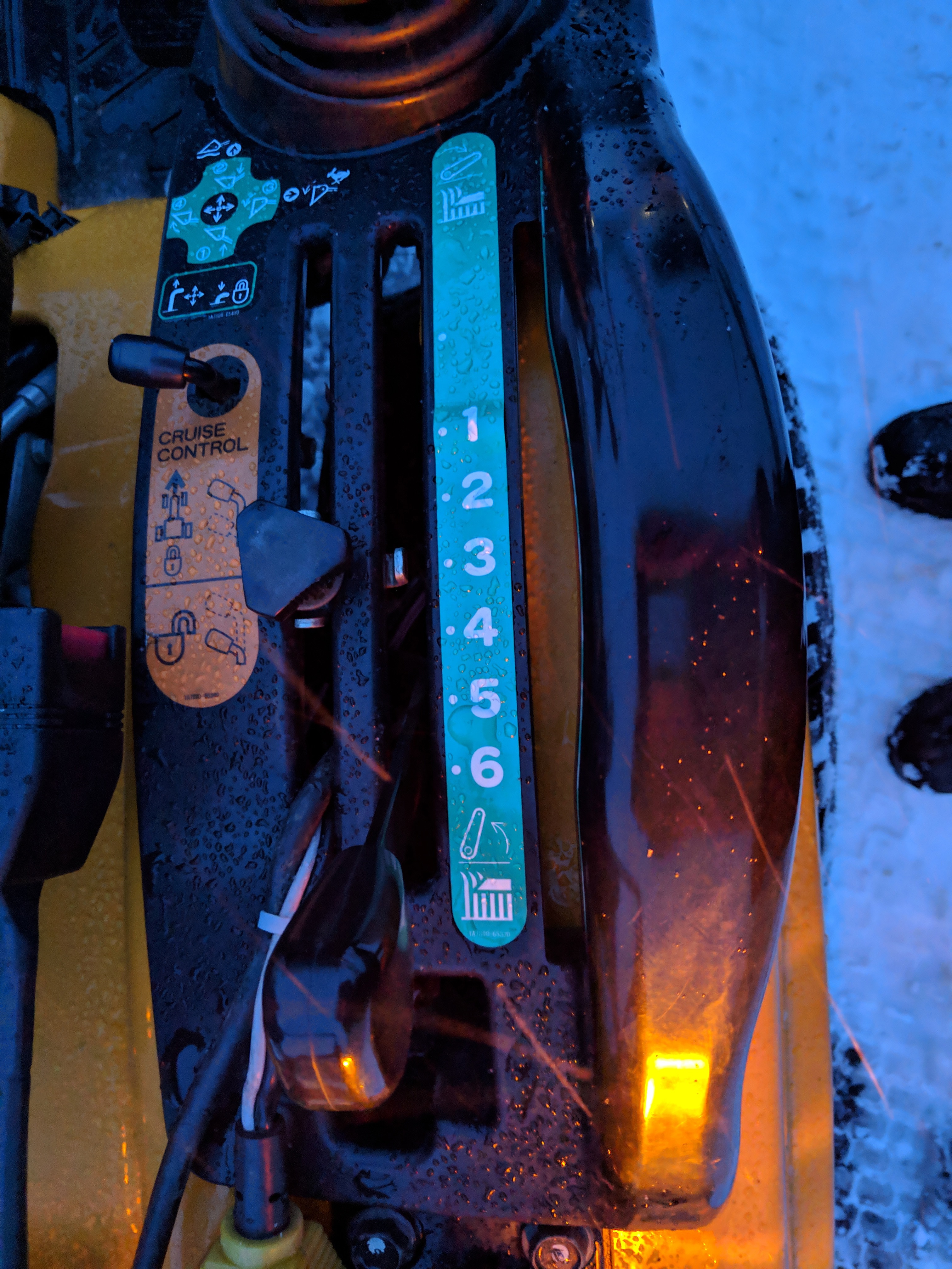

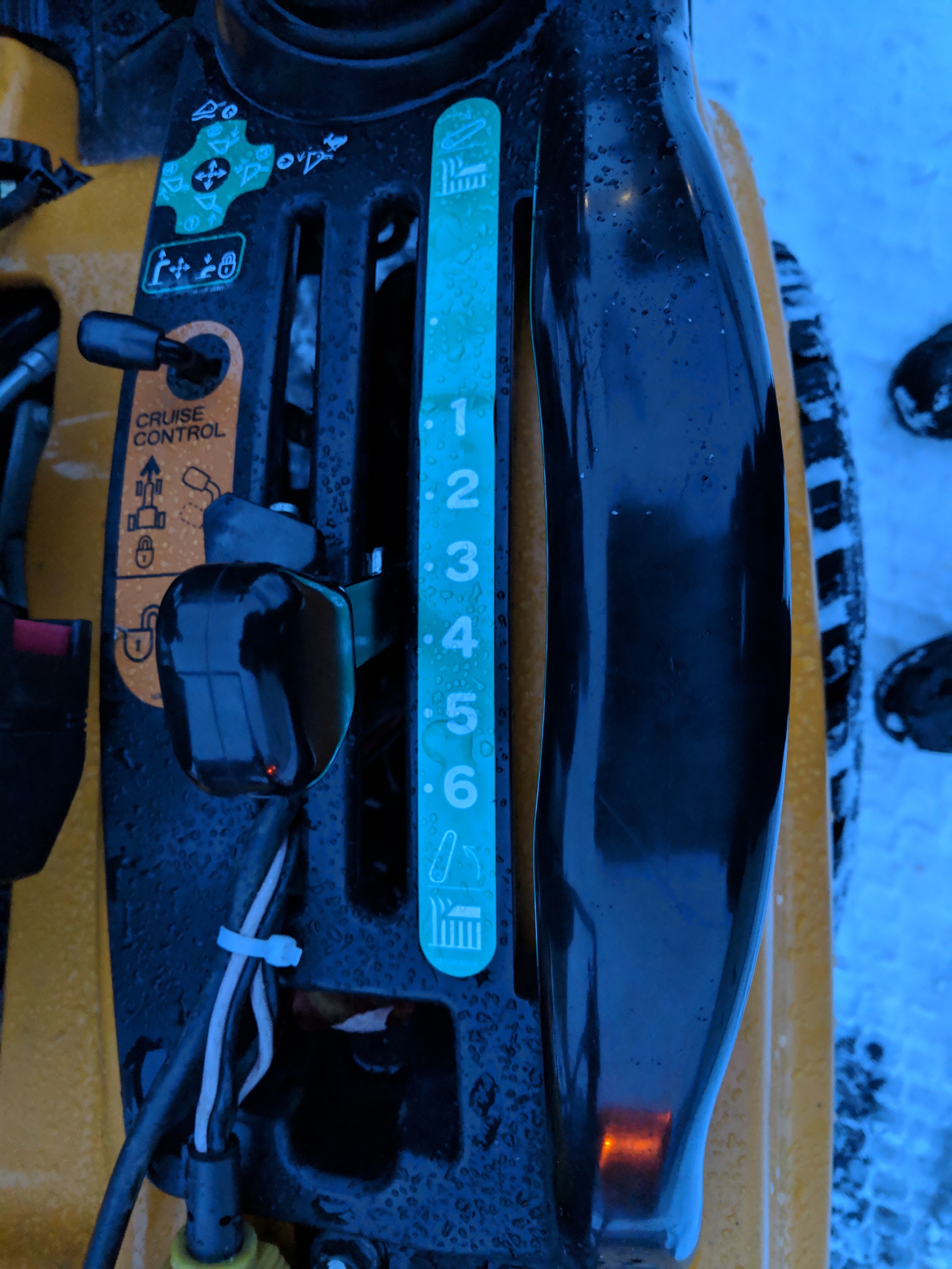

- blower in upper position and when it first hits the driveway
- handle positions for each of those two photos

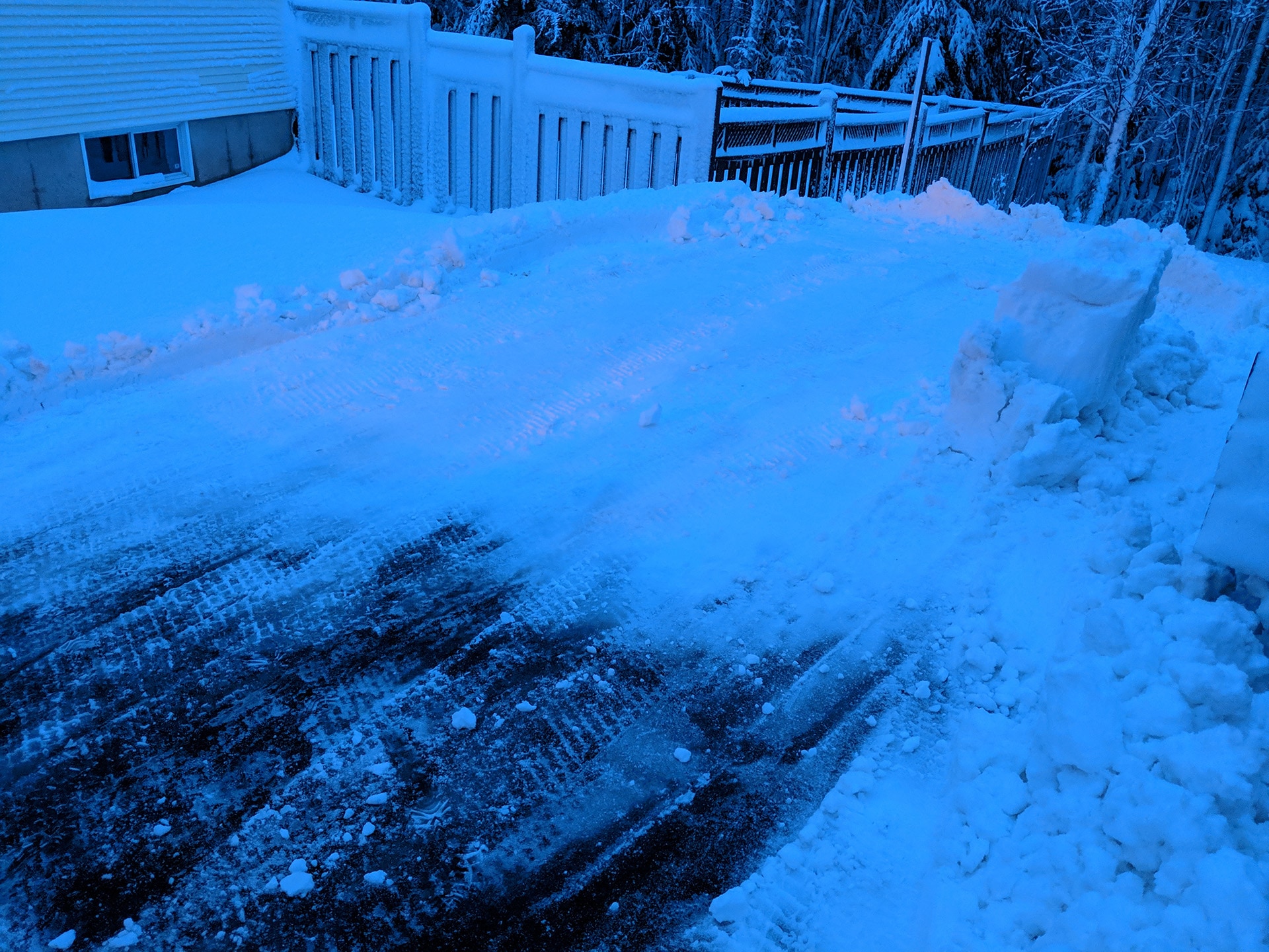

- driveway photo evidence of how it floats
- hole i dug with my boot to show how badly it floats
- close-up pic - there is no cutting blade, it's more like a horizontal strip of metal that runs parallel to the ground

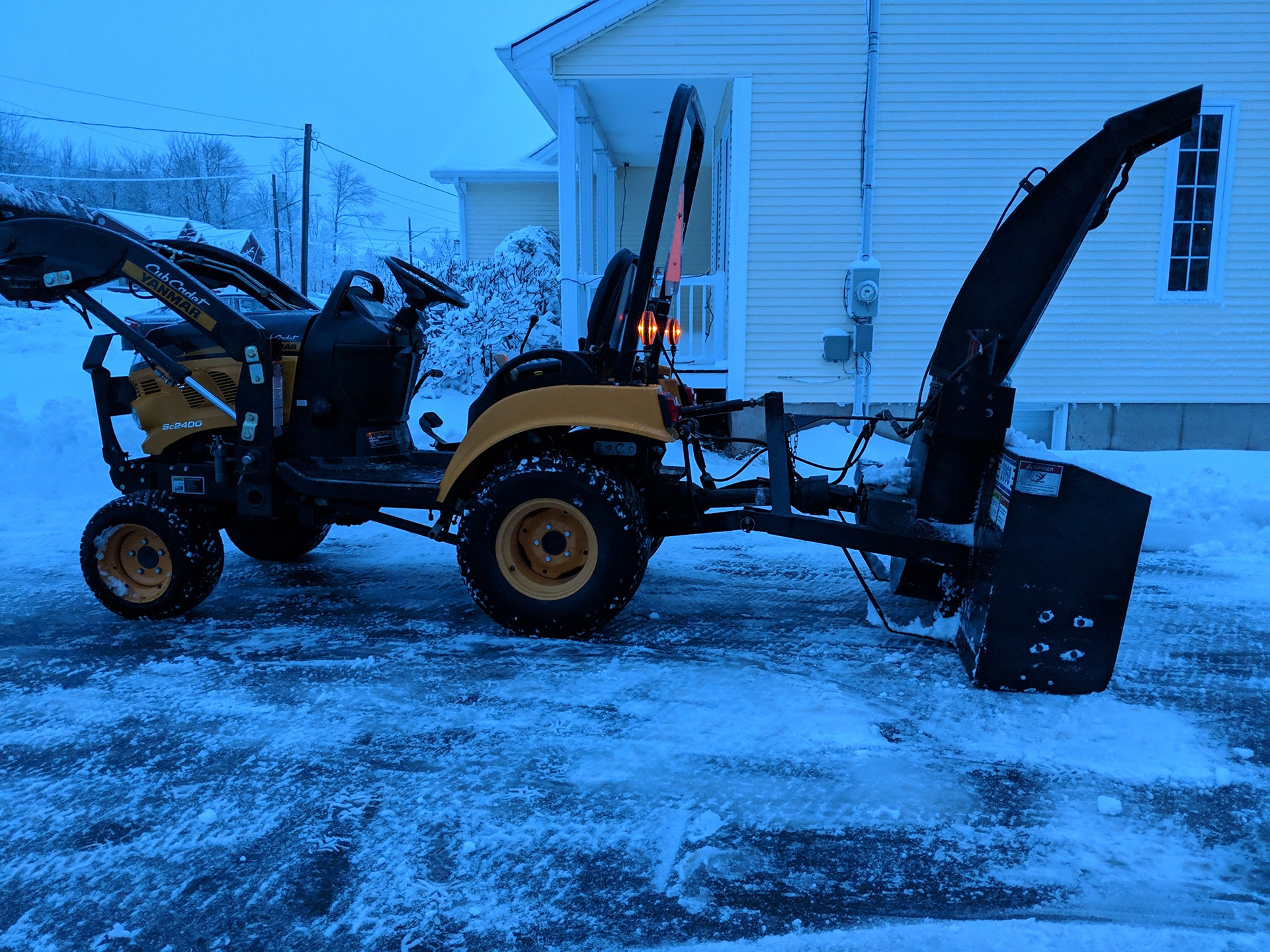

- garage pic - the 3PH vs PTO angles look pretty bad to me, are they not? The PTO doesn't sound very good if I have it turned on while in the upper position.
Also: Added (as safely as I could) a 200lb person standing over the skids and it had no affect whatsoever.

It looks like your blower is tilted way from the tractor too far. The big supports going back to the blower should be almost parallel to the ground. You should be able to drop the 3PH arms down more. That will require shortening your top link a bit. I can't quite tell if you already have the top-link screwed all the way in or not. Tilting it more towards the tractor and getting the arms level will increase the attach angle of the cutting blade along the bottom.

Loosen the adjustable stop for the 3 pt level so you can push the lever down to position 1. At position3-4 you may still be crying the blower on the 3 pt arms so as the snow gets left behind tractor tires rise, blower gets higher, etc.
Looks like you have the top link way to long but fully understand that this was an attempt to get the blower to cut

Angle is too aggressive, start with the blower flat on the skids and make small adjustments with the top link from there.
The numbers beside the lever looks like a height setting for a mid mount mower. The lever should go all the way forward to the end to full lower the 3pt.
There may be enough play in the lever to shift it past the stop, without loosening the knob at the "3" setting..
Yes, I had it much more level before I had taken those photos
The lever on this tractor controls the 3PH and mid-mount mower at the same time. I can put it all the way down past 3, it just doesn't have any affect on how it rides up the snow.
One thing mentioned earlier was about the height settings. On this tractor, it doesn't matter if it's in float position or in a set position (eg "3"), the 3PH still raises up on the snow.
