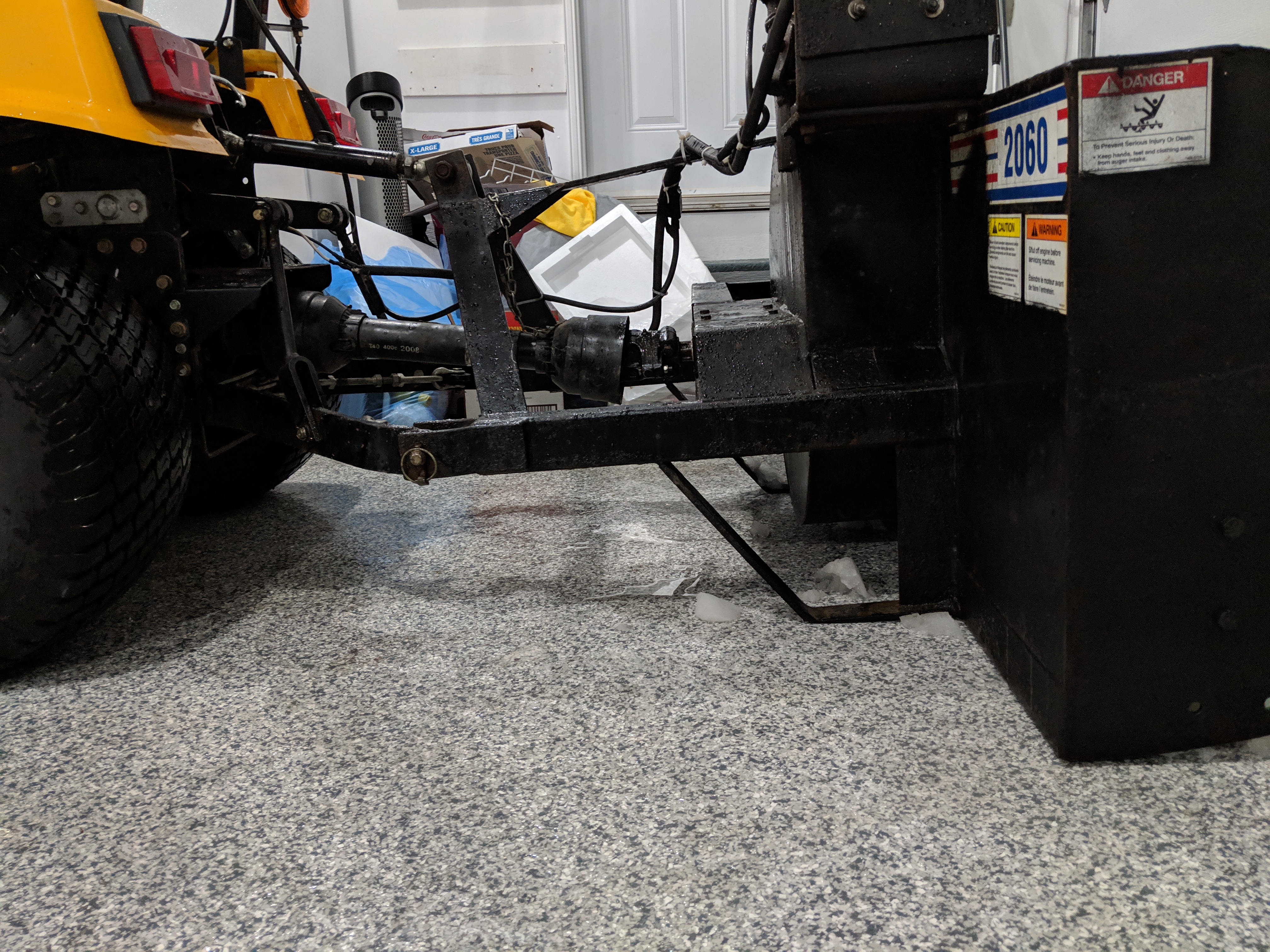

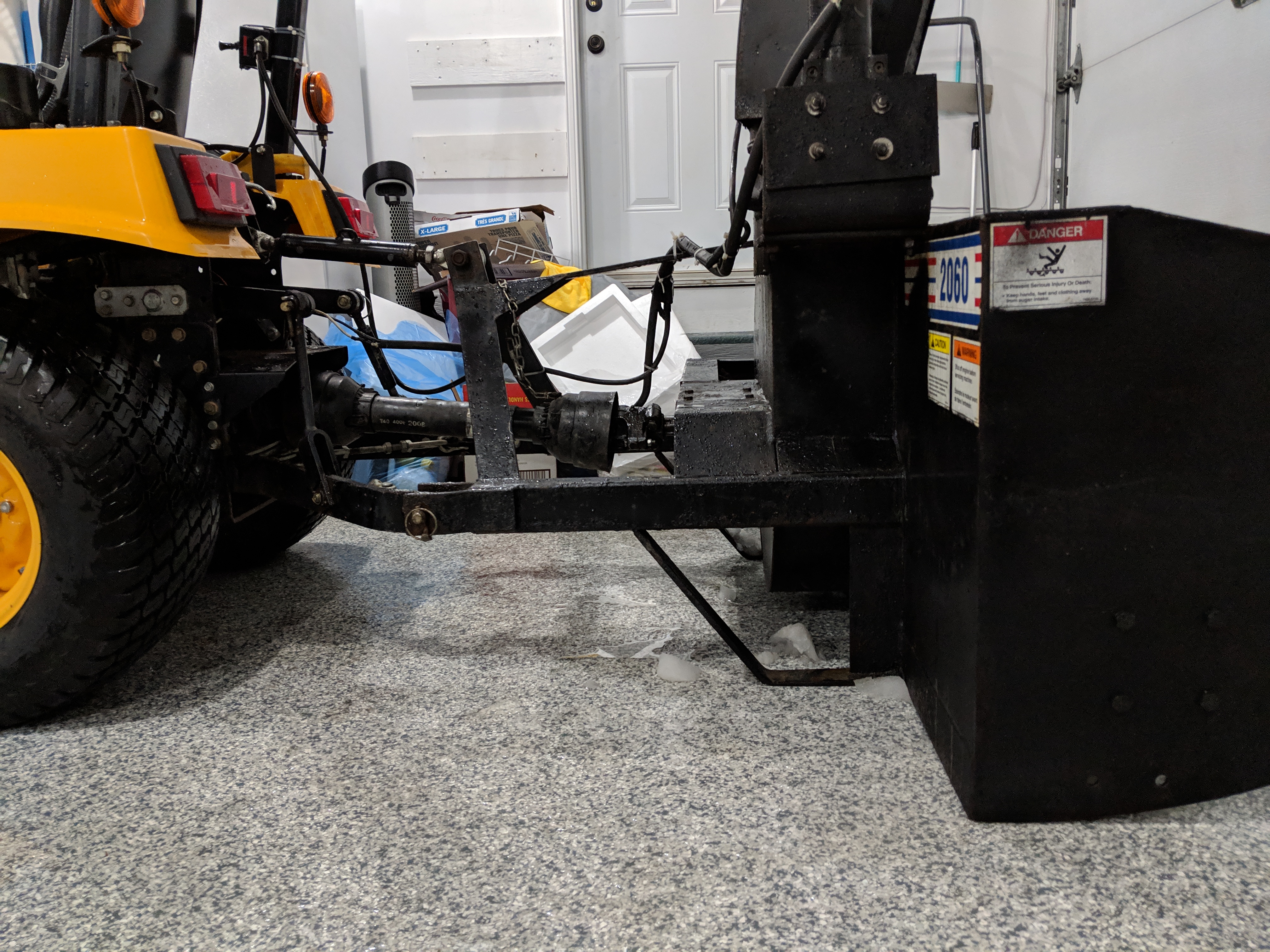

More photos attached
I was able to bring in the top of the hitch easily to the point where the blower started to tilt back on its heels and point upward. I adjusted it again and made it level.

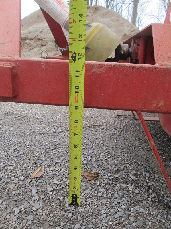

In the third photo you can see there is no real cutting edge, just a lip of sorts.
Even with the newest angle settings you see here, the blower is still starting to touch down when I get between the 2 and 3 marks on my 3PH lever. Is that another indication that this blower is too large for my tractor?
I'm still trying to figure out if this can be tweaked or if I need to be looking for a new piece of hardware.

When you lower the blower fully, is all the weight coming off the tractor? What is happening to the 3pt lever? Is it staying stationary or moving up?
   / PTO Blower making my life miserable! #30
This looks a thousand times better. It won't make a difference which number its on, put the pto on the lowest setting, it can't push down. Once it touches the ground thats it.
