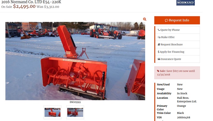

The optimum position for the blower is sitting level on the skids and aligned with the pto being as straight as possible. If your cutting edge is not at or below grade, the blower is going to rise. I can not tell if you have a an adjustable or replaceable cutting edge from the photos. If neither, I would consider welding or drilling and bolting a cutting edge that extends below grade when level and if too aggressive, shorten the top link to raise the edge.

I think you are right. it's hard to tell in the last photo I posted, but when the skids are level on the ground, there is a gap of at least 1/8", maybe more, between the garage floor and the lip.

I have that amount of gap on my blower and it doesn't ride up. At this point, without raising 3-point, try making the top link longer by a little bit, to angle it downward -- will that close the gap? You probably can't totally close it but get rid of it mostly.
   / PTO Blower making my life miserable! #36
How I set up my rear blower was to lengthen the 3pt top link so the blower was level with the three point lowered to the ground. This forces the cutting edge [ the part that scrapes the drive ] down onto the ground. Earlier in the season, I would tilt the top of the blower a little by shortening the top link, this would raise the front of the blower/cutting edge up so it would tend to ride a little onto the snow... and not dig into the soft ground. As the drive froze, I would lengthen the top link to again force the cutting edge down. You can use a level on the horizontal arms of the blower that the 3pt lower links attach to. Normally, the blower is made to be pushed with these parts level, with the back wall of the blower also being vertical, and the bottom of the blower flat on the ground.
