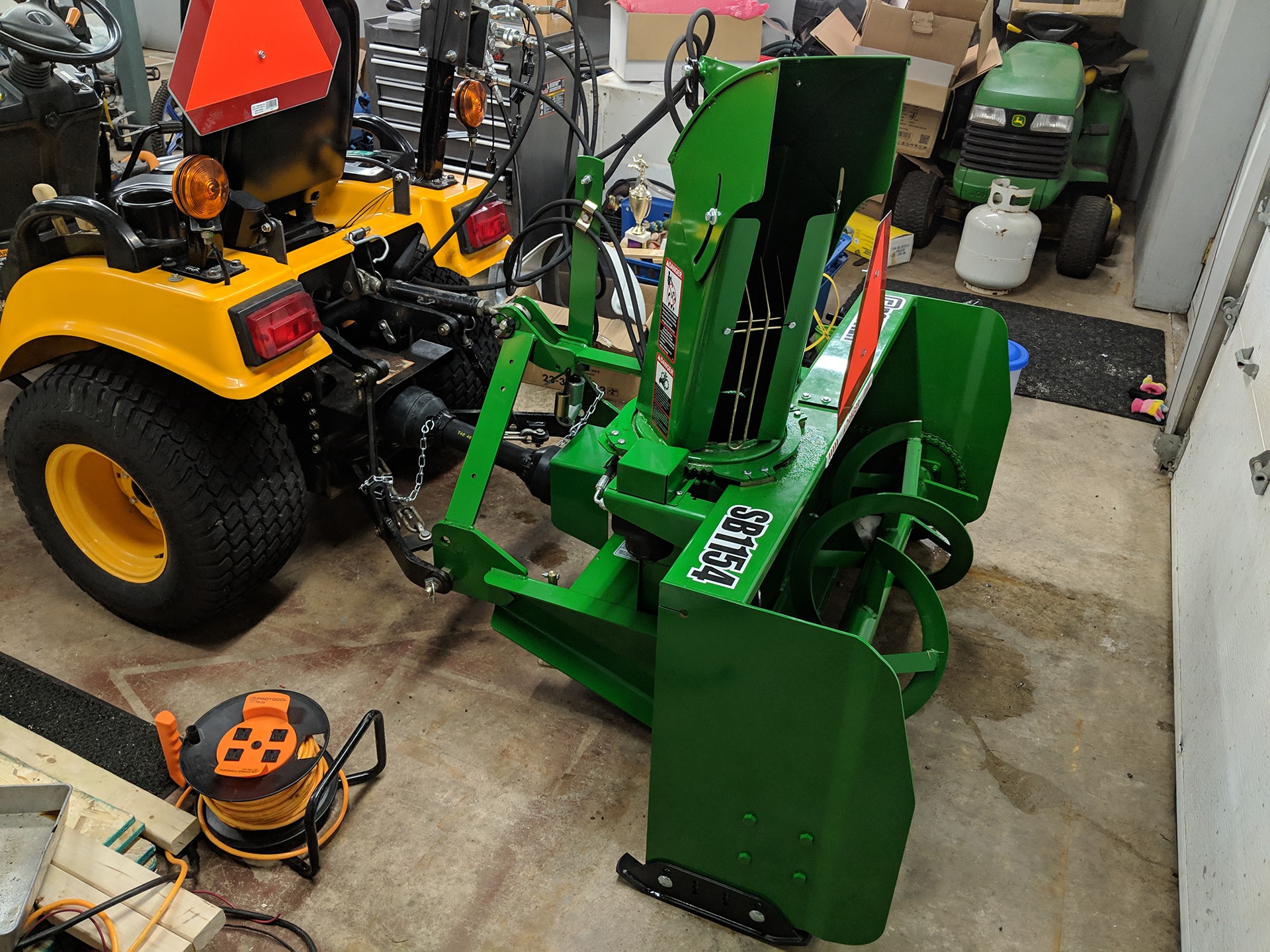

Hi all, I lost track of this thread for a few weeks but wanted to update you on my situation.
I ended up spending some money. My first stop was to a local Pronovost/Normand dealer and I was literally turned away because they were only willing to sell me a blower if it was attached to a tractor, regardless of the fact that they had inventory sitting around. I couldn't believe it. Apparently they have a hard time selling tractors in the winter if it doesn't come with a blower, so I guess business must be good if they can tell a customer with cash-in-hand to go take a hike.

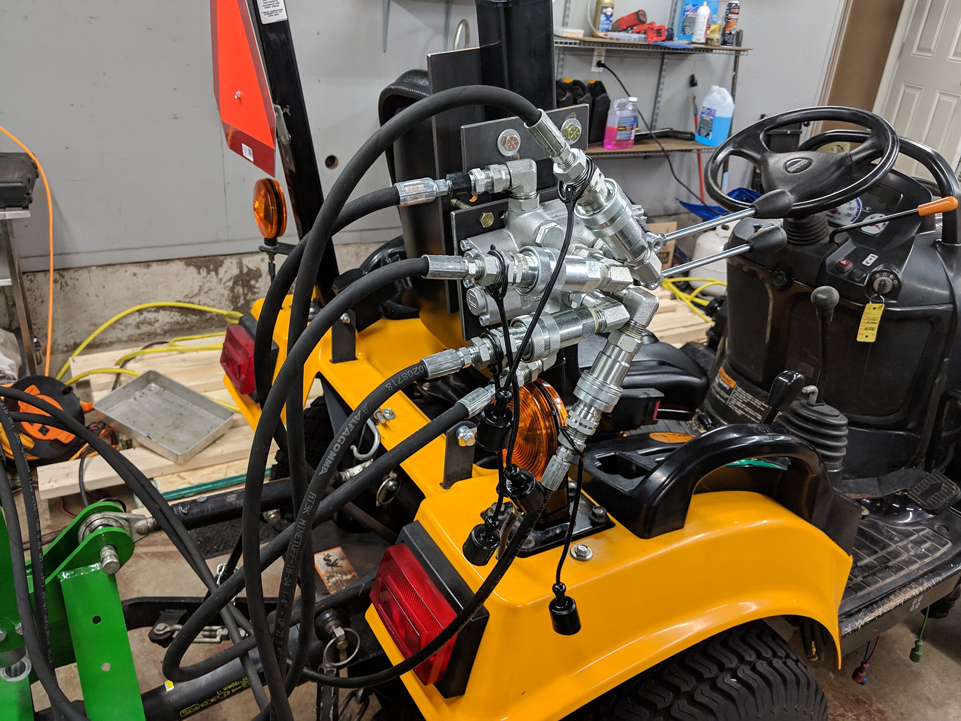

Next stop was John Deere, they have a big local presence here and lots of stock, and happy to help. I ended up purchasing a new Frontier SB1154 (sold as a JD unit). I spent about an extra $1k (Canadian funds) to get the hydraulic model and purchased/installed my own plumbing for the rear end.
This blower is a little lighter than the other unit and is 6" narrower. When you look at it side by side is doesn't look a whole lot smaller, but the chute and auger are still quite substantial. It's working really well. No riding up on the snow whatsoever. And of course, the hydraulics are making it a pretty fun toy to play with.
My conclusion out of all this is that the old blower was intended for a taller tractor. While the hitch pins were are sized correctly (believe it or not), the lower arm height on my tractor was allowing the blower to lean back. No amount of adjustment on the upper arm was able to fix it for me - It would have taken so much length on top that it would barley allow me to pick the blower up off the ground when raising the rear end, and that was a no-go in my yard.
The Frontier blower has multiple mounting points for the rear arms and proper skids, so that may also have been something that is helping on this model.
The new color scheme makes it look a little funny, but I'm definitely happy with the performance now.
