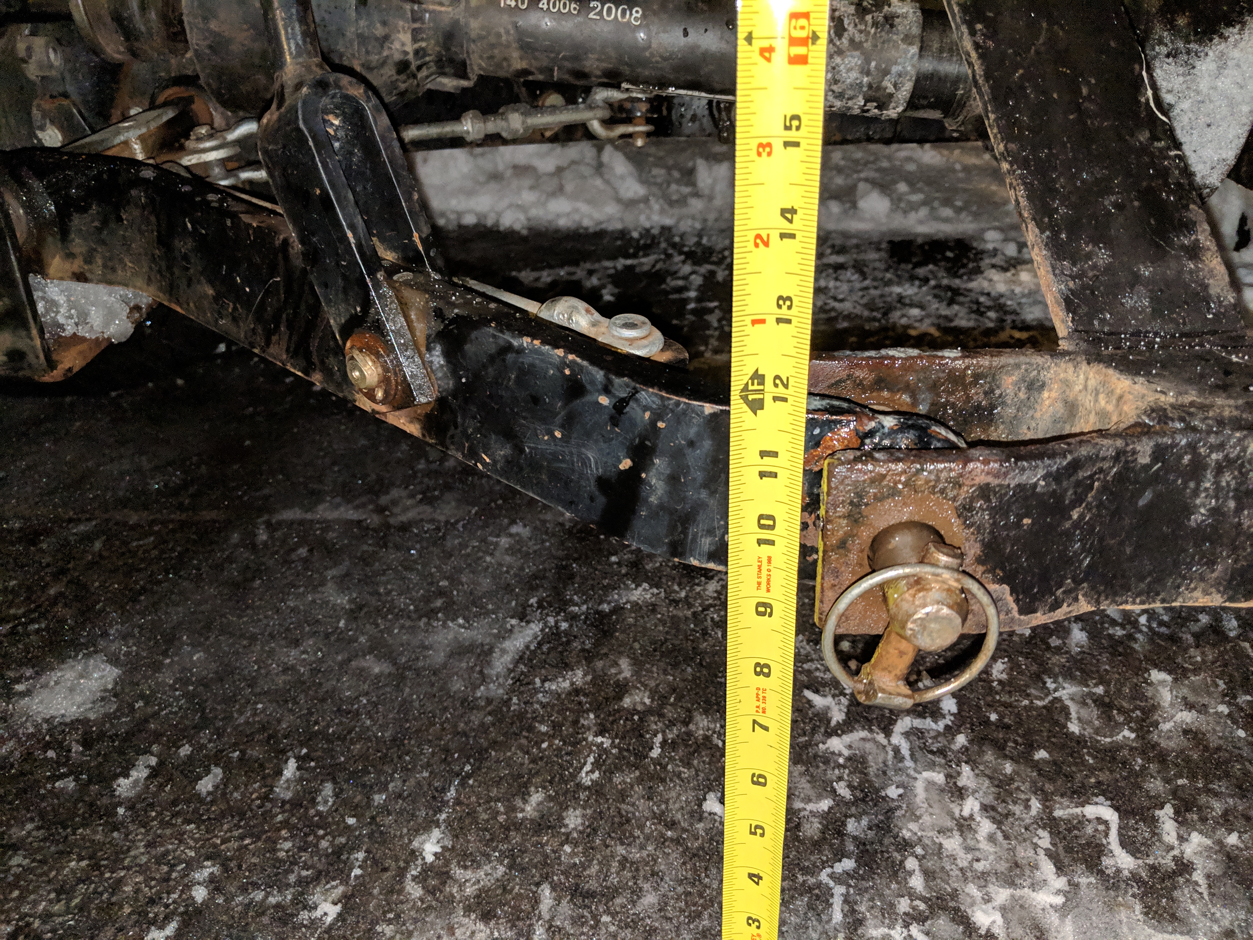

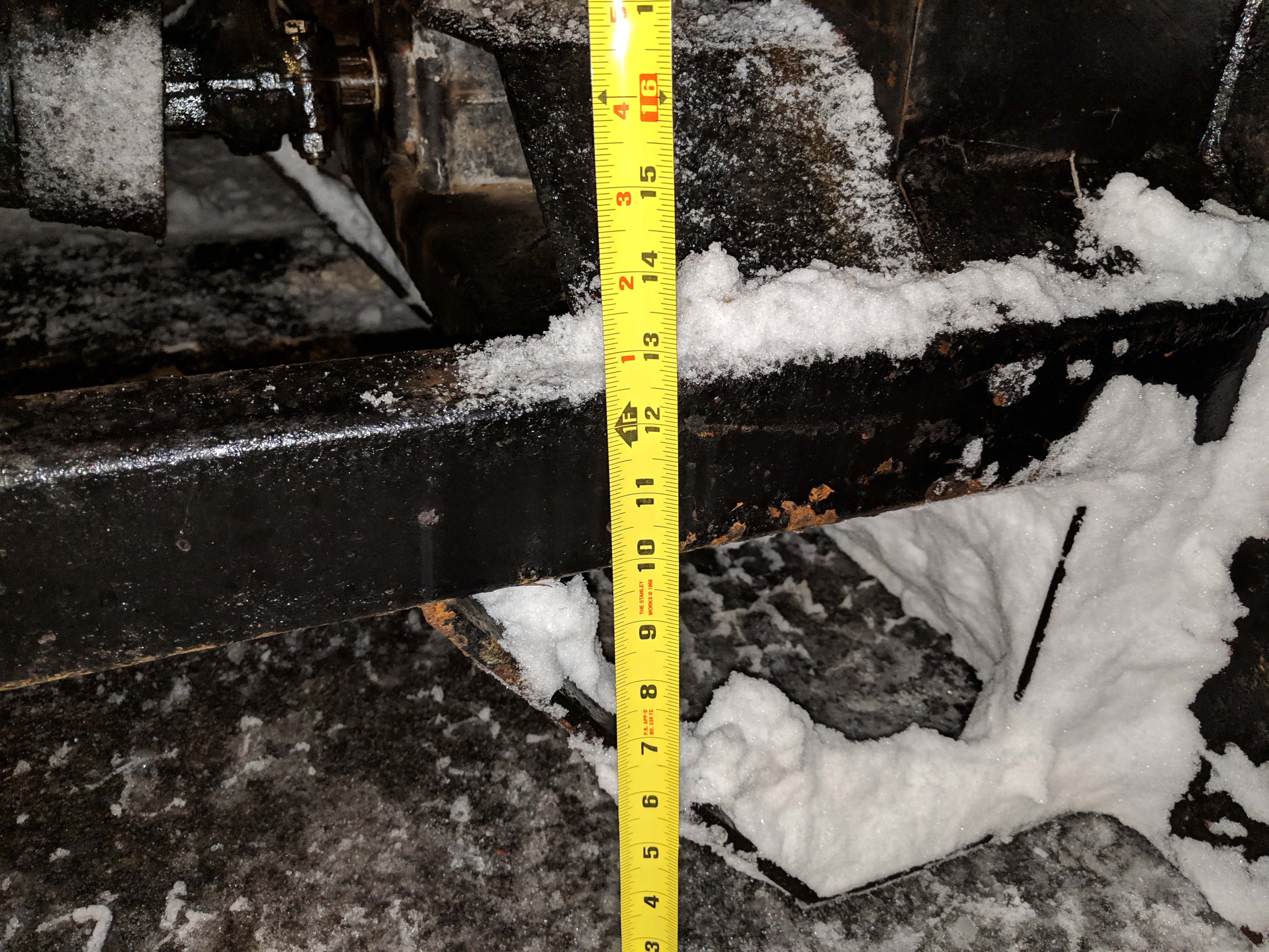

Just to follow up and confirm:
lower tractor arms are sitting at just shy of 11 3/4" and the blower is a little more than 12 1/2" near the skids.
So it looks like I need to replace the blower.

   / PTO Blower making my life miserable! #53
If you make the top link longer, that will push the top of the blower away from the tractor and lift the lower tractor arms. If you put a level on the blower, you lengthen the top link until both the places you are trying to measure will be the same measurement. There is nothing wrong with your blower, your top link is just too short. :)
I wish you were right, but I think there's too much evidence now:
- The difference in the arm height
- The manual calls for a max 3PH lift weight of 661lbs, and thanks to DMW's post today, I know that a) the smaller blower by the same company aligns perfectly, and b) the blower i have (with the winch added etc) is right at the maximum weight allowed
- The 3PH height adjustment has always felt off to me - basically from "level 3" all the way down to float position, their is hardly any difference made on the blower.. makes sense now if float > 3 is just making up the difference between the tractor being smaller than the blower

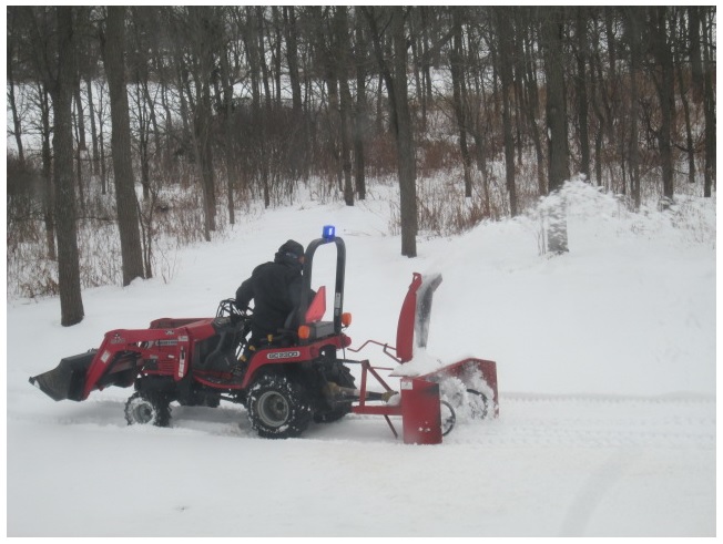

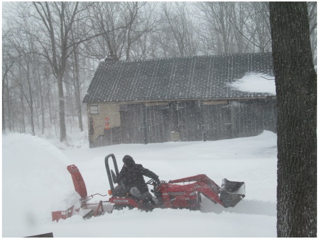

torch2k, before you throw in the towel, may I suggest something. Level the snowblower using the top link on the floor of the garage with it fully down, no weight on the 3pt arms. Ensure the turnbuckles on the 3 pt arms are tight. Take it outside (doesn't matter if the blower is turning or not) lower again, does the angle stay the same? Reverse the tractor with the 3pt lever fully forward, lower than again in the 1 position, again in the 2 position. What happens to the angle of the blower? Specs for tractor say it has 3pt position control. When you go to a higher number does the weight from the blower start shifting onto the tractor?
Just included a couple pic of my blower, the best I could find,so you can compare angles.

Something not adding up here. If the blower is lifting, then the lower links would be moving upward, yes ? If that's the case, the links are getting help and or direction from the top link. Remove the top link completely. The weight of that blower ought to keep it down while riding on the skids if the lower links are level. I'd try putting a chain in there for a top 'link'. It will allow you to raise it when you direct the lower links to elevate. That blower looks pretty heavy. Mine only has 2 links with a bar going from the top of the blower mount to the lower links. Can't tip mine unless you raise the rear wheels.
