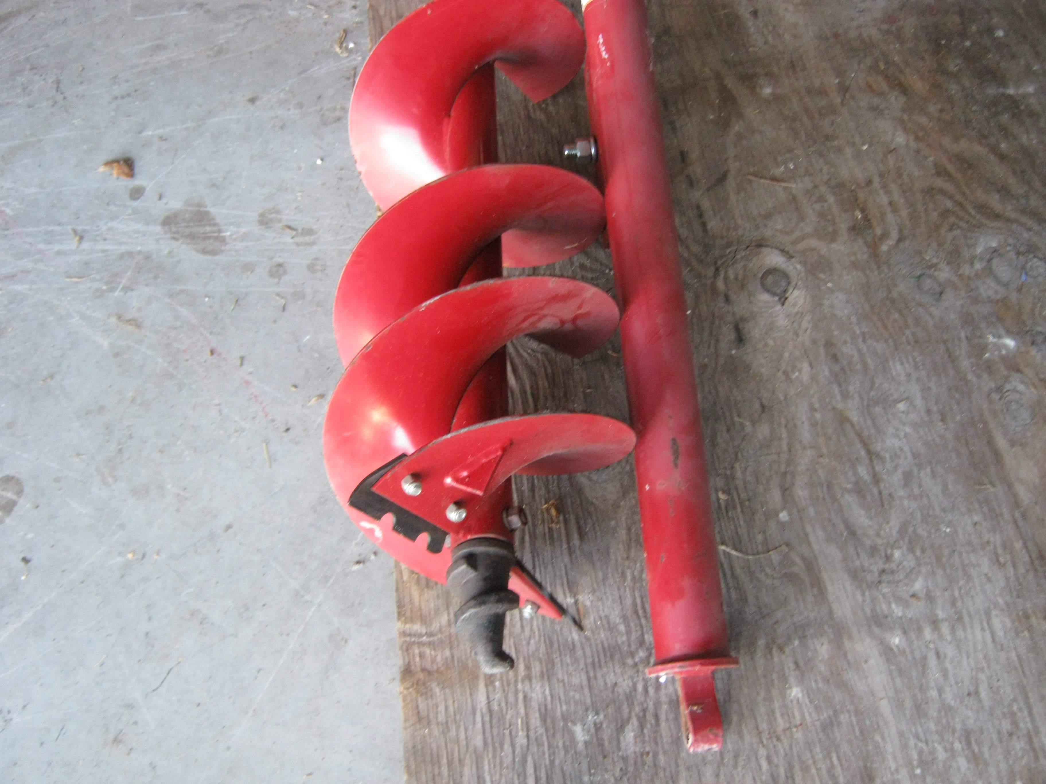

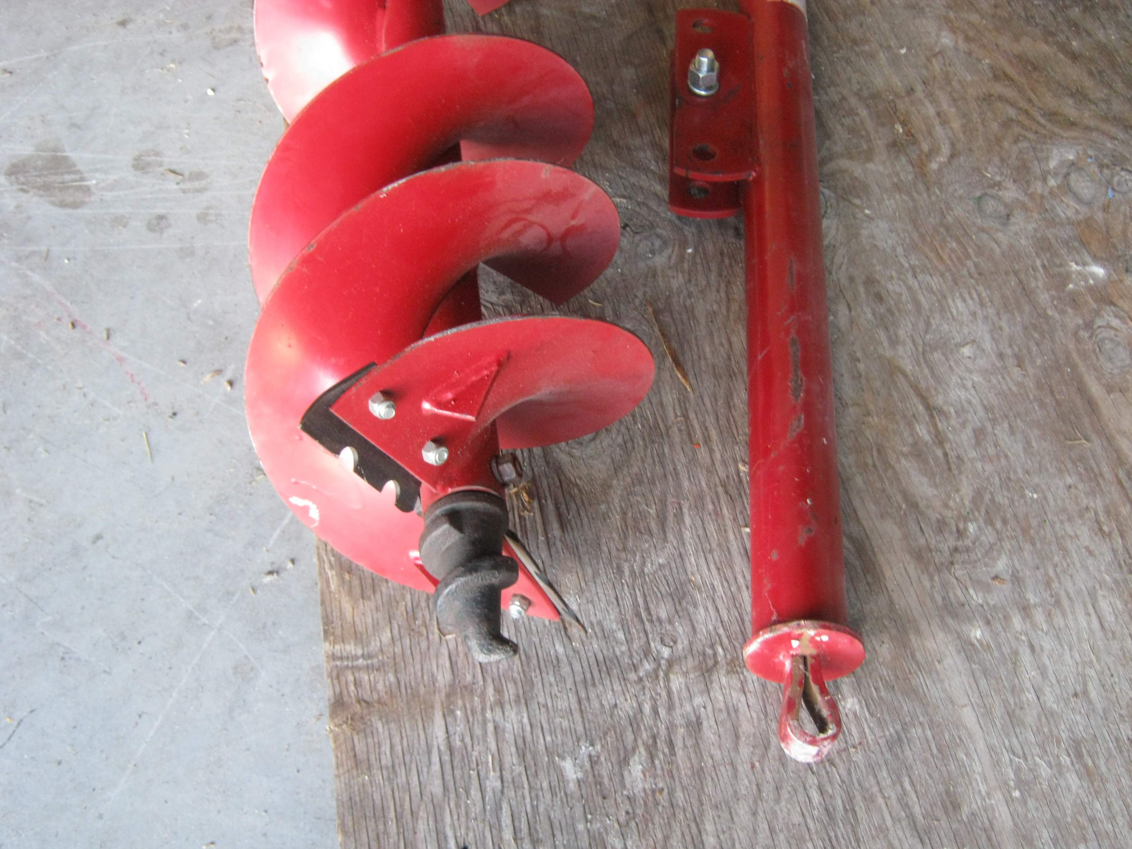

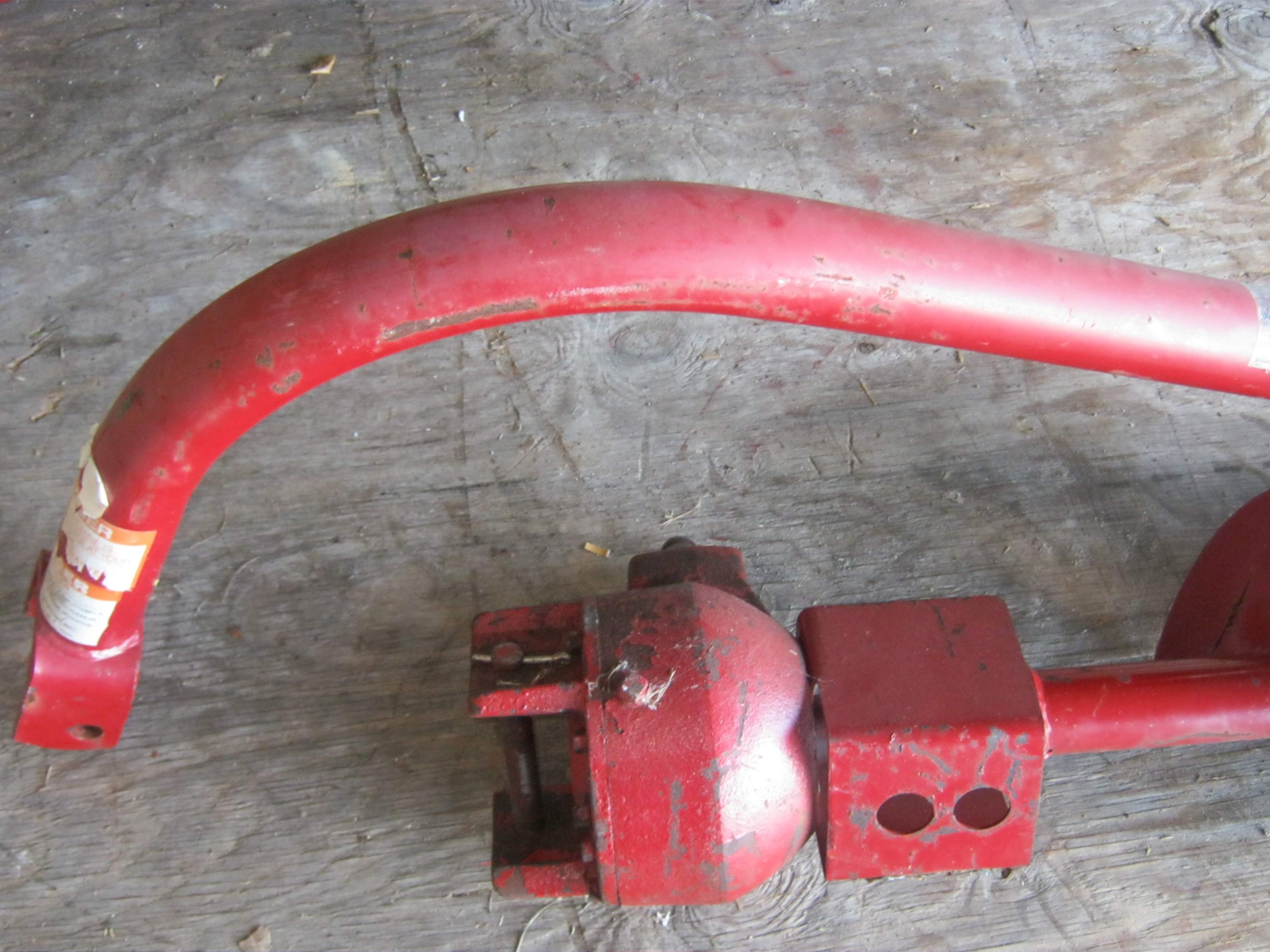

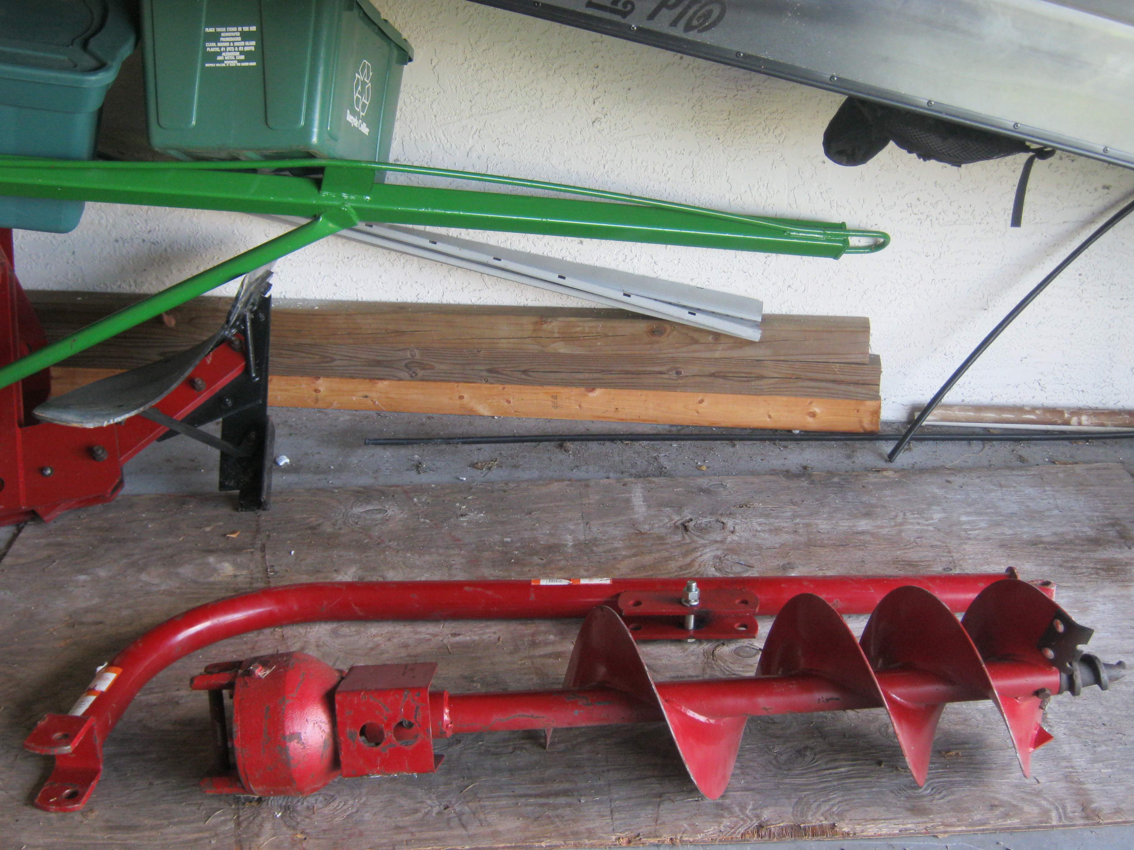

Heres two I own.Red one is a International(World Ag Corp) 12" auger.
Yellow one is a Speeco(6" auger).
Have to agree Leinbachs are good especially 8000/9000 mdls(thats where they start getting pricey)IMHO.Of course Bushhog,Woods make good stuff but seems to me lots of PHD's use Comer gear boxes.Not that there bad.Which I could be wrong but might be made in China.Also its no secret Danuser considered one of the best.I believe all Danuser components made in good old USA or at least they use to be.
