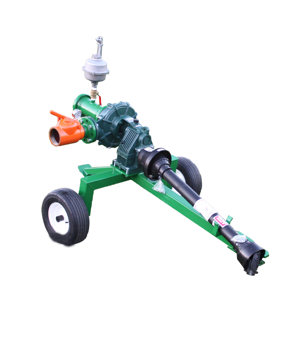

The only system that will be useable for you is a liquid manure pump mounted on wheels used
to pump and agitate manure in manure lagoons.
The folks at Conestoga Manure Spreaders can help you with this as you do not have a big pumping need.

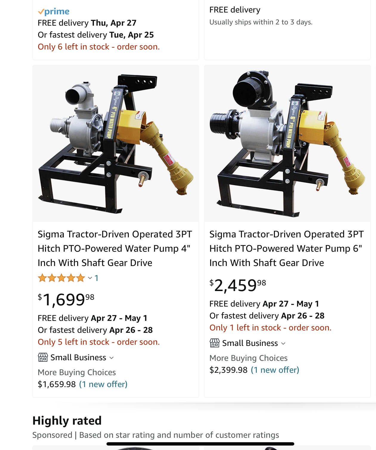

There is an easier way other than pumping all the water out and removing the sediment or running that sediment through your pump. Use a dredge style nozzle and a small water pump.
/ PTO Driven pumps #10
I have the smaller one to pump out a duckhole, 30 hrs to drain 5 acres 6”- 18” deep
/ PTO Driven pumps #11
What are they and how do they work? I'm not familiar with either one.
I think I'm looking at about a 3" pump and a 20 foot lift out of a rock & gravel shallow stream bottom.
