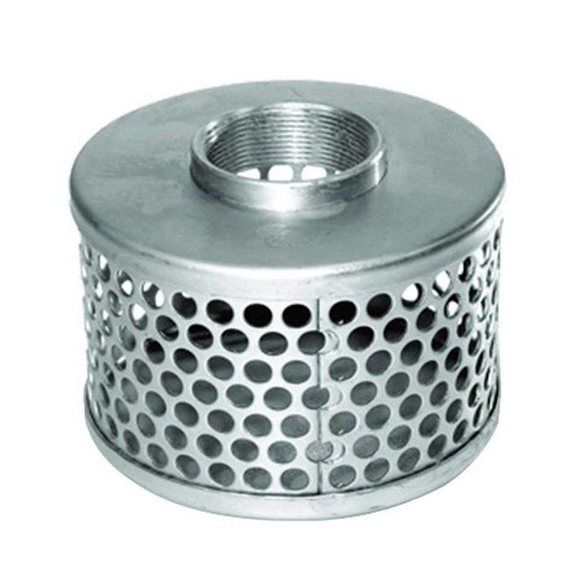

Yes - to pump water, silt, sand, pebbles and small rocks - a trash pump. Be sure it has a screen on the end of the intake hose. You don't want large rocks fouling the intake hose nor damaging the pump itself.

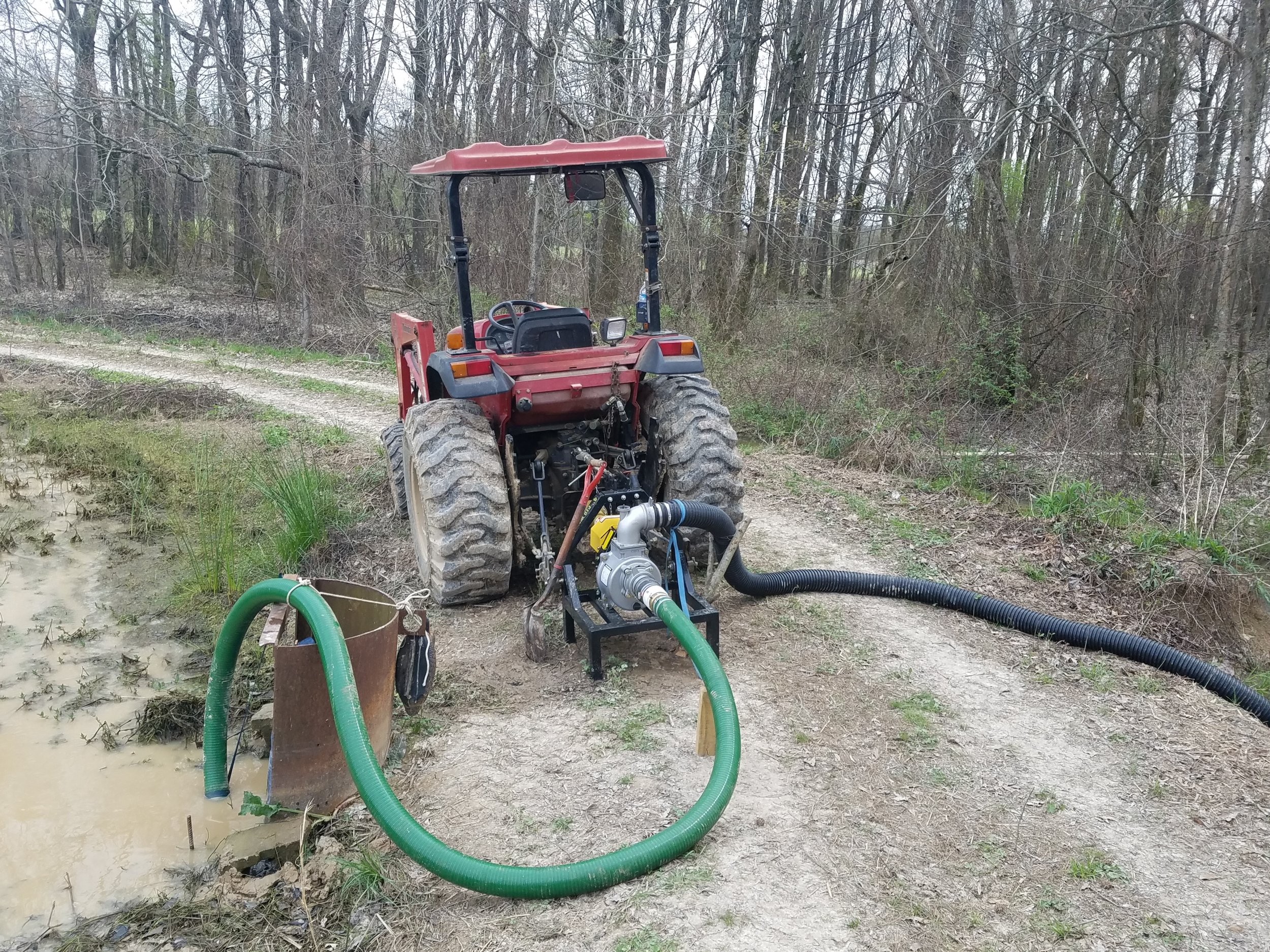

One of several on market place.

I have the smaller one to pump out a duckhole, 30 hrs to drain 5 acres 6”- 18” deep

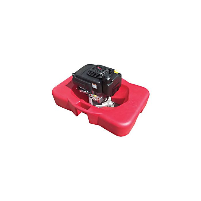

A dredge nozzle works using water to drive water just like a jet pump for a water well.
In your situation a floating fire pump will be of the most help to you to feed your PTO pump.
The Absolute Water Pump folks sell the self contained CET floating fire pump which is made in
Canada for fire fighting in the bush but there is no reason it would not work for your needs.
The image shows a CET floating fire pump from Absolute Fire Pumps. It has a static head pressure of 92 feet.
It has a 3 inch inlet and 2.5 inch inside diameter discharge hose and it has a capacity of 260 gallons per minute/15,600
gallons per hour at 3,600 RPM and it would flood the inlet chamber of your PTO pump adequately to keep
the volute seals of the PTO pump lubricated.
The CET brochure is incorrect in stating the floating fire pump requires a foot valve as the centrifugal
pump volute and suction screen is below the water line and it does not require a foot valve.
