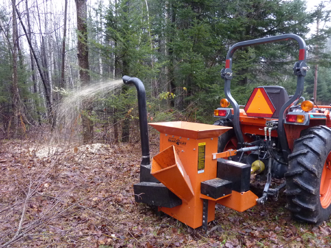

I have a BearCat Model 554 5" chipper/shredder that I bought used about 6 years ago. I am very happy with it. I have never used anything else so I can't say how they compare. I have a mile of road to maintain and chip all the roadside trimmings. It is through the woods so I use it quite a bit.

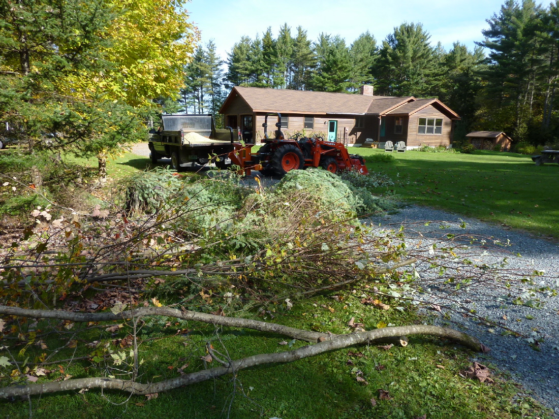

I've had the BX42 for several years now and my only complaint is that the chute will jamb up every now and then when small dry twigs make up most of the mix-other BX42 owners have said the same thing. It seems to work better when I alternate big and small branches but I do need to check the blade settings before I use it again as that may be the problem. A big plus is the 360 degrees rotating chute-just aim it where you want the chips to fall. I did through bolt two 4x4 PT stringers on the base rails to give it a little more height so I don't bend over as much as I did without them. All in all, it's a well built chipper and worth the price.
