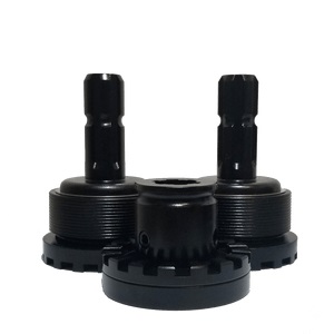

Hello guys, this old man needs some help. I start having some issue connecting the pto shaft to the tractor, I just don't have the strength in my arms and back like I once did.
I have been looking online for something to help and came across this thing call Pto Connect. it seems like it would help but I would like to get some advice before I commit to it.

I'm not sure exactly what I'm looking at. To me the traditional PTO connector has six splines to match the ones on the tractor. You start slipping it on then push a button until your thumb aches while sliding it the rest of the way. Release the button, pull back, and it latches. My new PTO connector has like a big rubber wheel around it. I start the connector onto the tractor then turn the big rubber wheel to unlatch the ball and allow the parts to slip together. Then I turn the big rubber wheel the other way to engage the latch. I learned the hard way you must turn it back to engage the latch or the PTO shaft will work back off when you start to mow. Turning the big tire is easier than holding the spring loaded button. I'm still getting used to it. You can probably get that type yoke for older shafts but be sure to get one for the correct size U joints.

Don't have one but looks like only one on the market where you don't need to have the tractor PTO and implement shaft splines oriented. Plus couples and de-couples very easily. At $370 don't know how many will buy.
Products – Pto-Connect

For those who have difficulties with attaching PTO shafts due to physical conditions, I think the connector system is worth the money.
They are expensive but solve the problem. I’m getting to the point where my arthritic hands are needing some help. I can see me one day, purchasing a system like this.
