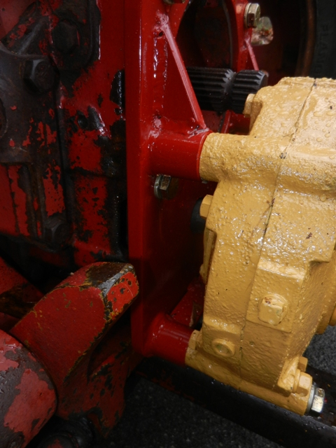

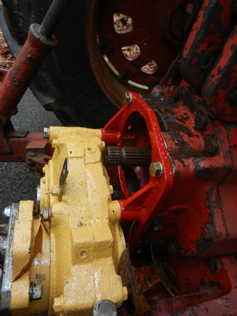

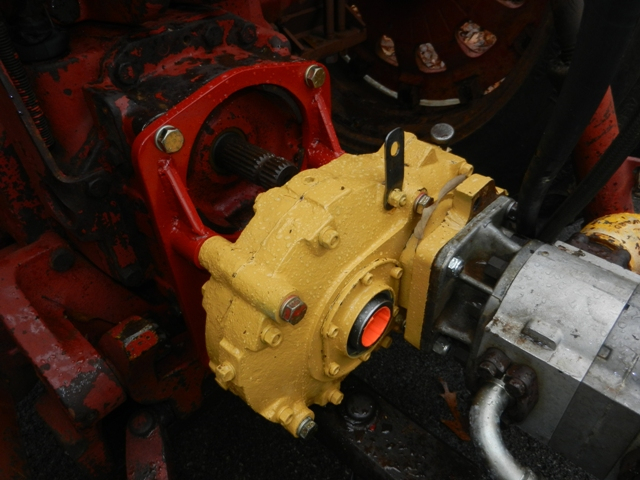

I had some bracketry made for mine. It has available, a plate that interfaces between the increaser and the tractor. I had a local friend fabricate it. 'my' increaser has a vent but, the vent as has been said, can be moved to the side by swapping the vent/plug.
(powers 15' hydraulic flexwing mower)

Does your setup (tractor) have two PTO output shafts?
