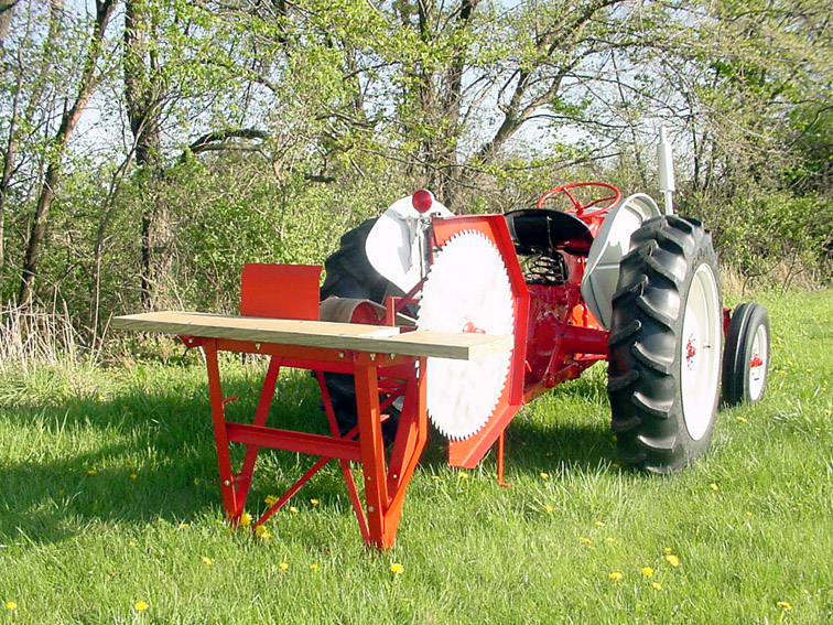

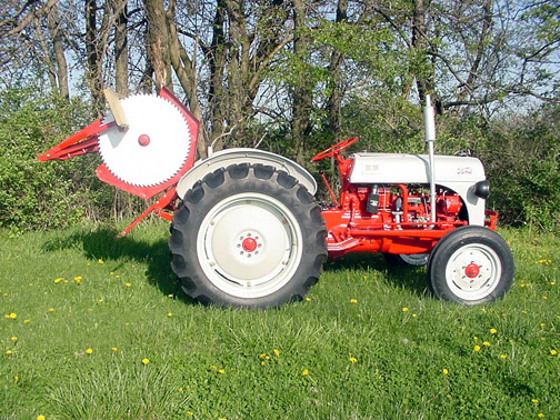

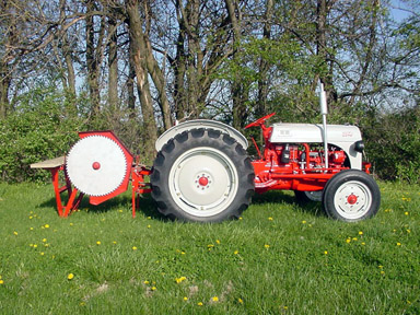

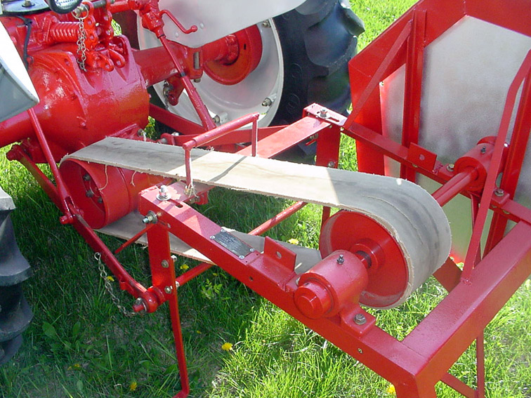

Did someone say belt driven?

I have the "factory buck saw" that was made for THAT tractor...
I haven't used it in years...
SR
That is a Dearborn cordwood saw, so it is period and correct saw for my 8N. The only part I could not restore was the paper pulley on the saw, it is steel now. Philip.
