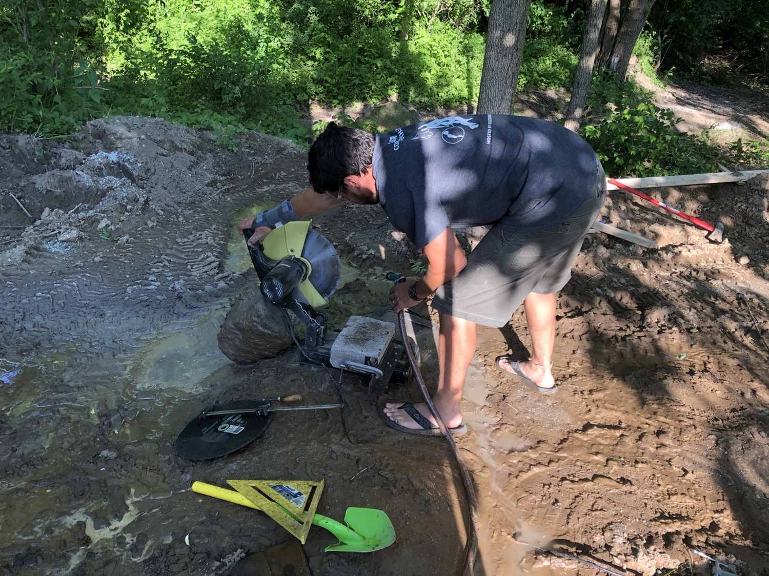

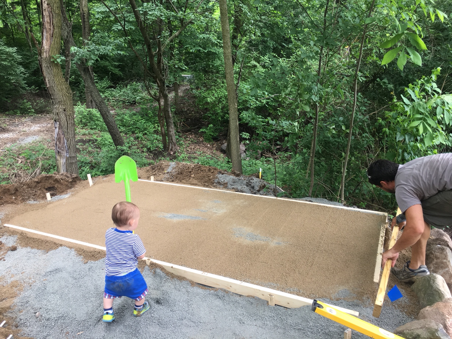

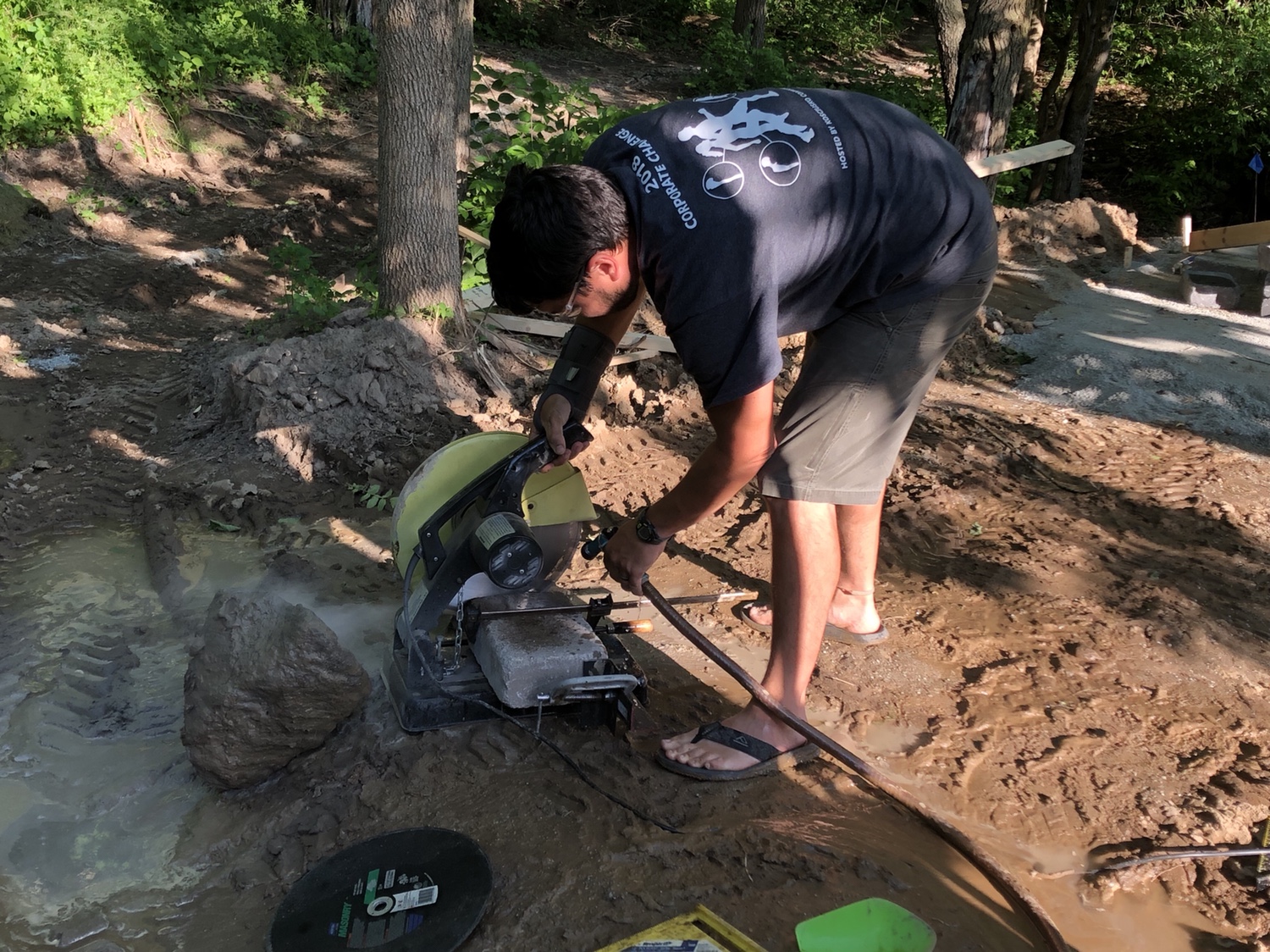

My thread is still going....thought about my safety conscious friends today while I used a $10 auction chop saw with a $100 Bosch blade and a hose to cut 30 blocks tonight for the outdoor fireplace.....Since we have some people with some time let’s go from electrical no-nos to counting OSHA violations....my unprofessional status as a mason has solidified. IMG_4683.JPGIMG_4685.JPGIMG_4680.JPGIMG_4678.JPG
