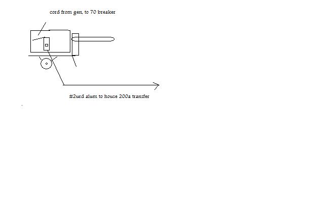

Actually what I was planning on doing was feeding the panel on the load side of the main breaker and making sure the power from the utility was shut off (shut off the 200 amp main breaker when i am using the generator). This would allow me to feed to the panel through a separate 60 amp breaker and appropriate sized 60 amp wire from the generator. Would not really need a transfer switch this way.
Just have to make sure generator was disconnected (or 60 AMP breaker was shut off prior to turning the utility power on or making sure the main 200 amp breaker was shut off before the generator was connected. Not totally fail safe butr if these simple rules were followed I believe it would work.

That is what an interlocked panel does, with the addition of a sliding lock plate that will only allow one of the two breakers(main or generator backfeed) to be on at a time. In order to be legal, you need that sliding lock plate... You can get a lock plate kit for most panels that meet this safety requirement. The lock plate kit is about the most cost effective way of putting in a "legal" manual transfer switch that I have come across...
   / PTO generator attachment to the Home. #27
i agree with ron on this. you need an interlock. it is just too easy for someone to forget to shut off the main line feed or to accidentally turn it back on. you need a positive way to isolate the utility from the generator that can't be defeated without some serious effort.
linemen get killed and injured every year due to systems like what you are proposing despite the homeowner's best intentions.
i know it's tempting to do it this way, but it's not your life you are gambling with. it's somebody else's. then it's your financial future when they figure out what happened and you get charged with the code violation. or, imagine your utility company refusing to hook you back up. just not worth it IMHO.
google transfer switch interlock for some good options. i bought a reliance transfer switch from notherntool that can take a 60 amp generator feed and 100 amp line feed. costs about 150 bucks. and, you can change out the breakers. they just use cutler hammer type ch3 dipoles. i modified mine to take an 80 amp input and used number 4 thhn copper wire to make the short run from the utility pole to the well house. the whole thing feeds a sub panel in the house. and a small subpanel in the well house (18 bucks plus breakers at lowes) will feed the well and a few yard circuits so i'll have light in the generator shed and can charge the generator battery with top charger. i have about 100 bucks in cable and maybe another 300 in breakers and boxes but it is a good setup and safe.

OK. Now im with you. I do the same thru an idle 50A breaker on my house panel that I keep brightly taped to offwhen not used. My experience with 50A 220 breakers is that they will sustain 70A load for at least 30 seconds before tripping. I dont think your steady state load conditions will exceed 50A normally and im sure the breaker would hold 62A for a couple minutes if the occasion arose. I would try your installation straight off the 50A output plug. Get your house running near its max draw and monitor the plug for heat. The whole generator will get warm over time, so you want to check the plug as soon as you start, and for about 5 minutes before the gen heat camouflages the effect. If the plug warms more than a few degrees under full load I would worry. That would suggest a need to clean the contacts, or ultimately hardwire if cleaning didnt do it.

Ok here is what you do. Hook up the generator to your switch. If the breaker on the generator is only 50 amps, all you have to do is dont turn on all the stuf in your house. Like you said the generator has a meter on it and you can turn stuff on until you get close to 50 amps.
Some folks are just making this harder than it should be.
