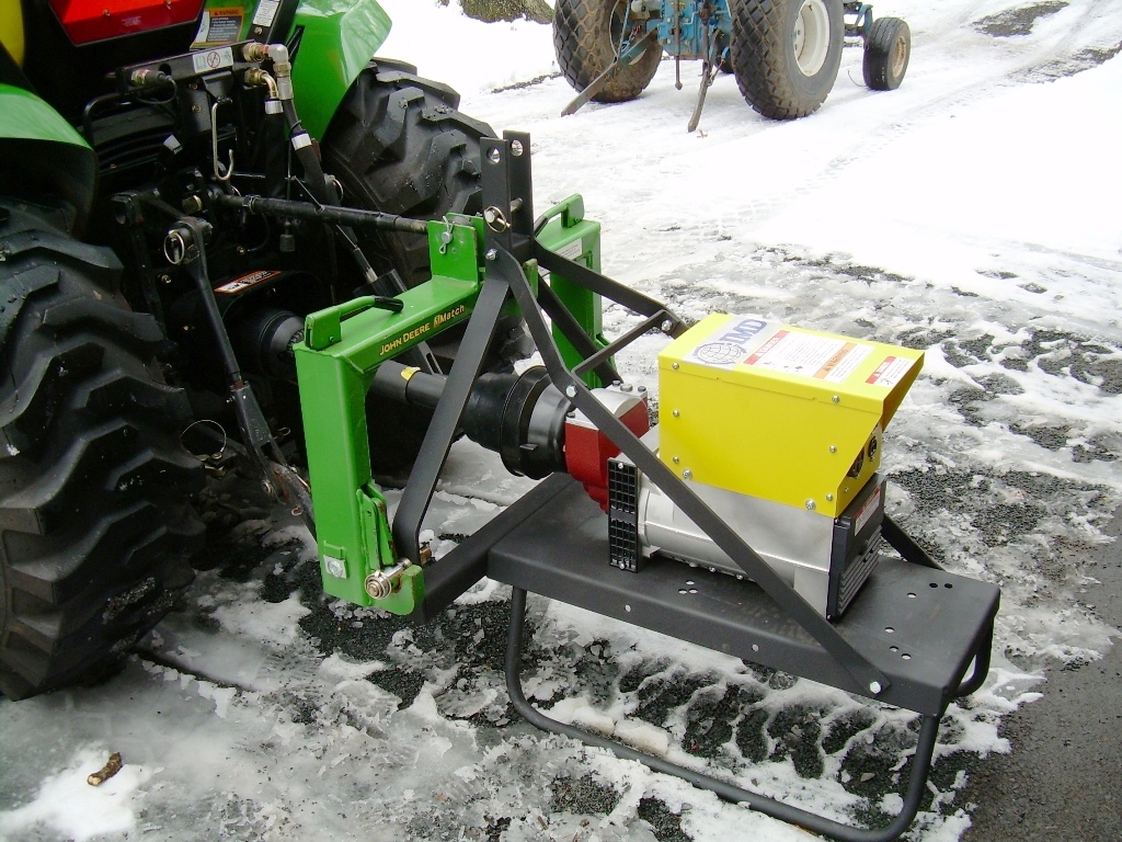

How do the PTO types regulate load?
Do they just leave the tractor running at what ever throttle achieves 540 rpm, (and waste the extra hp) or somehow load the tractor so it can respond?
Based on what little I have observed (Honda size and also factory sized) they all communcate the load applied back to the throttle somehow - that seems like the biggest advantage to a package over an unwatched PTO.
I have a generac 20 KW PTO generator with a 40KW surge and it is more than enough to power our whole house. When we have Ice Storms we can have power out for up to 4 or 5 days..at least so far. The generator works great - I plug the house into the generator , flip the transfer switch and start the tractor and move the throttle slowly to 540 RPM and it sits there just fine. I use my NH TC - 29 and if I need the tractor for another purpose ...I warm or cool the house and then unplug for long enough to take care of the chore and then plug back in ..it is no big deal..I chose this PTO genny instead of a stand alone since I already had the tractor and it always starts as opposed to buying another engine to worry about. My tractor burns about 6 gallons of diesel in 8 hrs at 540 RPM so then I shut it down fill it with fuel and check the oil and gear case oil in the genny and I am back up and running. I do not run the generator when we go to sleep at night..We warm the house up and turn it off and the next morning fire it up again. It works for us.

I run an MF 285 and 1135 powering PTO irrigation pumps pulling guns for literally hundreds of hours. We're talking near max rpm's and near max HP required for the 285. Of course i kept a watch on them and checked all fluids at each refill, along with removing the grill screen to facilitate better cooling. I don't have a PTO genny but would have no compunction about tying one on and taching it up if that's what i need my piece to do at the time. If it's not up to the task, it needs to belong to someone else.
   / PTO generator feedback #48
Aren't most good pto alternators 220-240v? If so, you'd better give it a lot more courtesy. Mine is 240v so I power up both sides of the inhouse box. I usually throw a tarp over the rear of the alternator if there are rain issues. Some people around here park it in a "doghouse" with only the pto shaft poking out.
It also needs to be said that you don't need to run the thing 24/7. In the worst of winter weather, I run it until the house is super warm, then shut it down. Heat lasts 3 -4 hours. That's also when all the toilet flushing, showering and water troughs are filled. Then it gets shut down until we need it again. That means you think about opening doors and using water for good reasons, not for foolish ones.
Same for summer except A/C can be engaged in the afternood until later in the evening. Stupid to run it all the time in my opinion...

my northstar, while not one of the spendier units has served me well, especially during the hurricane years in florida.
soundguy
   / PTO generator feedback #51
Guess I am an odd man out on this issue. I now have both a PTO and a portable. A hand me down 13kW Northstar PTO for long outages when it is hot and we want to run the A/C to sleep and a 6.5kW Silent Diesel for most all the rest of the time. The 6.5 will give me about 12 hours on 3 gallons with our average load, which saves enough fuel to justify running the tractor for 8 hours at night to cool the house for comfortable sleeping. I would never want to have to run the PTO with my 50hp tractor when the small unit will do just fine.
   / PTO generator feedback #52
I bet if you added up the fuel usage per kw generated.. I bet you the fuel cost would be VERY close. especially if it is a modern diesel tractor. Just because it is a 50hp tractor doesn't mean it's putting out 50hp when it's running the genny... a 13kw genny should consume a max of 26hp or actually, a bit less. And,, that will be at max electrical load.. lower loads will mean less hp needed, controlled by the governor and throttle.. less hp will mean less fuel.. modern turbocharged diesel engine are pretty darn efficient.
Look at it like this.. My 70hp diesel ford 5000 uses less 'dollars of fuel' to run my 12.5kw genny than my 33hp gasser ford 660 uses on a similar task, IE.. running my well on my farm property when I had an extended outtage... that diesel isn't even turboed either... but is more efficient than that gasser... I didnb't even attempt to run it wiuth my 850..it's even more gas hungry than the 660 on a bad day...

I wouldnt. The pumping and friction losses in the bigger engine will be a factor as you say. But more importantly, the standalone doesnt have the PTO transmission loss exhibited in the tractor and the genny gearbox. The end to end connection of engine to generator in a standalone approaches 0% loss of power. So, with near equal efficient engines and generators the standalone will be much more sparing of fuel use.
