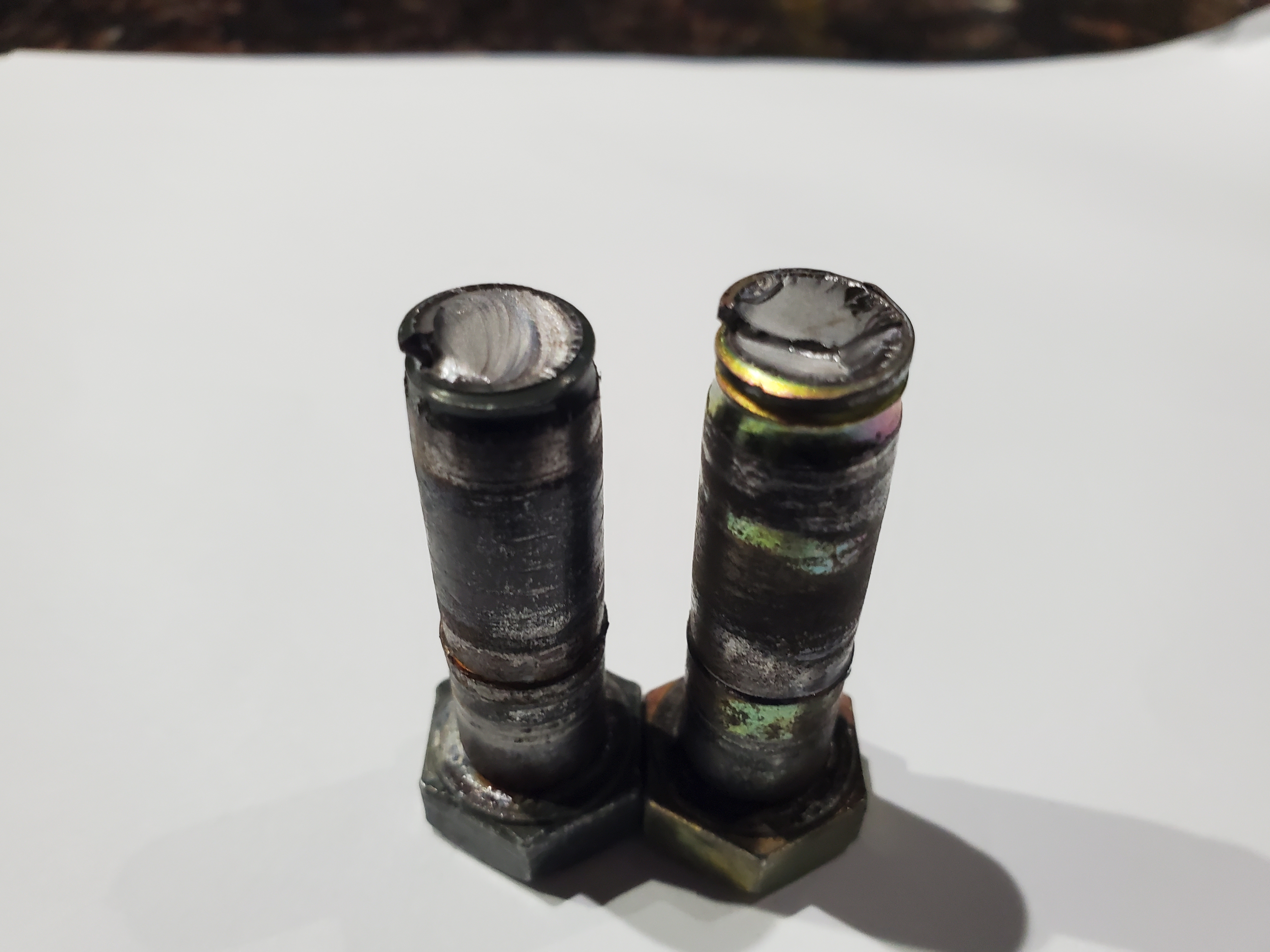

Taking another stab at this.
The PTO only breaks the threaded side of the bolt.
My guess (correct me if I'm wrong) you would pull out the broken bolt and insert another bolt in the same direction (yes? or no?).
Try inserting the bolt in the opposite direction, if it still breaks the threaded side, I'm at a loss...

I dont think he has ever sheared the longer bolt he put in that has a shank spanning both shear points. ???

I'm not sure he ever tried a longer bolt, a bigger bolt (14mm), or duct tape around it to preserve the evidence. Until that happens, these are just theoretical solutions.

I had put a longer bolt in it and it has about an hour or so on it.
Going to take a look once the storms pass.
Thing is though I use the 1/2 by 3 bolts on all of my cutters and this is the only one having issues!
May also swap out the shaft and see what happens.

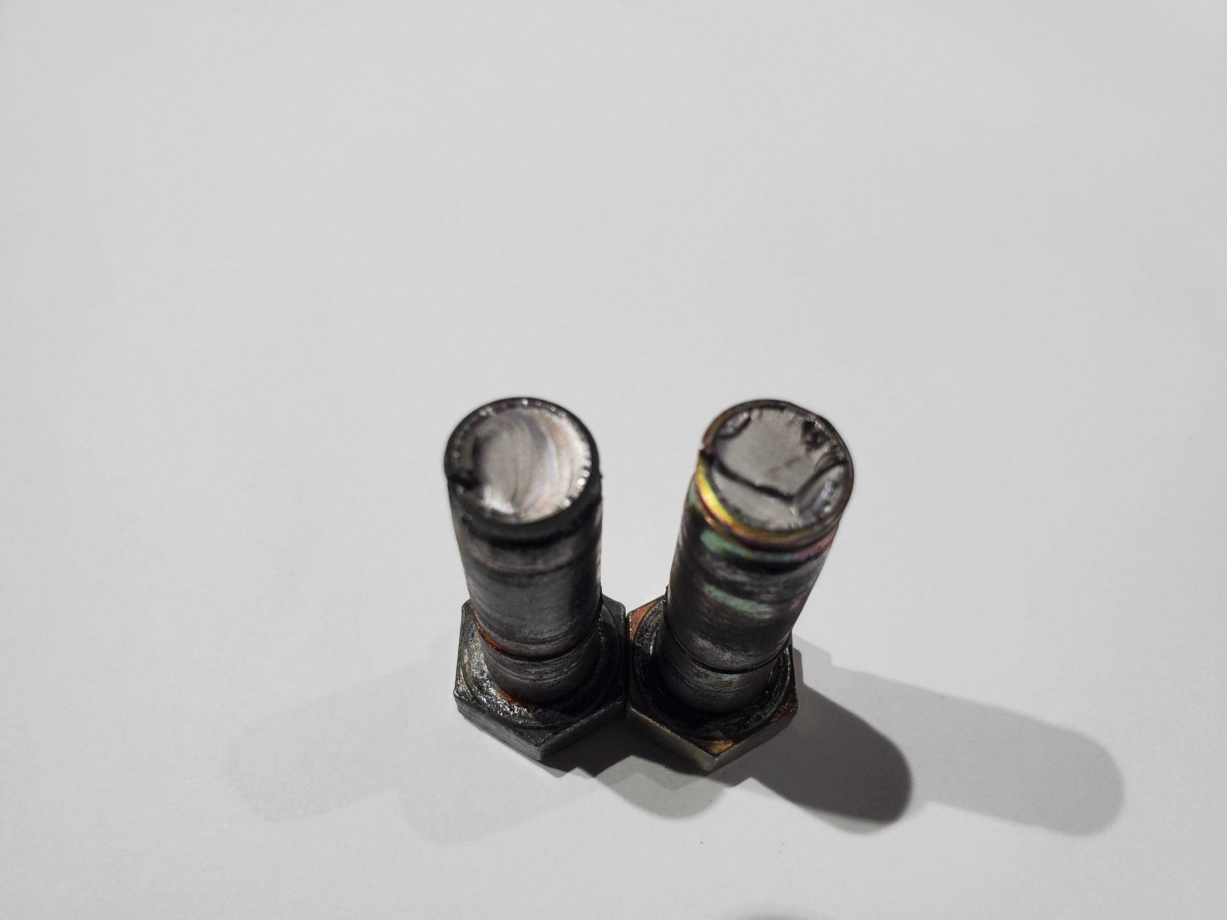

Yup. The problem is fatigue at the stress riser in the thread root.
- The longer bolt should do it.
   / PTO Shaft to Gearbox Bolts Keep Breaking!
#167
Yes, longer bolt seems to be doing better.
Going to pull it when I get time to see how it looks.

Longer bolt is holding up so far. Been busy so not much time to look at it!

I had an Iron Craft customer breaking shear pins and found he was buying grade 2 from harbor freight. We put the OEM bolts in and no problem after that.

Every double shear situation calls for having the bolt shank across both shear lines.

I think yes, the problem was they were Harbor Freight. He brought it to us and the bolts he was using and they broke when engaging the PTO at as it should be. We put in OEM bolts and zero problem. Its been a month now and he has come in several times for other things and he has not broken one of the OEM bolts.
