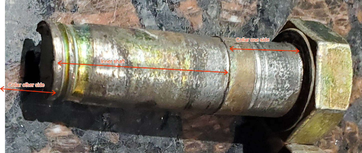

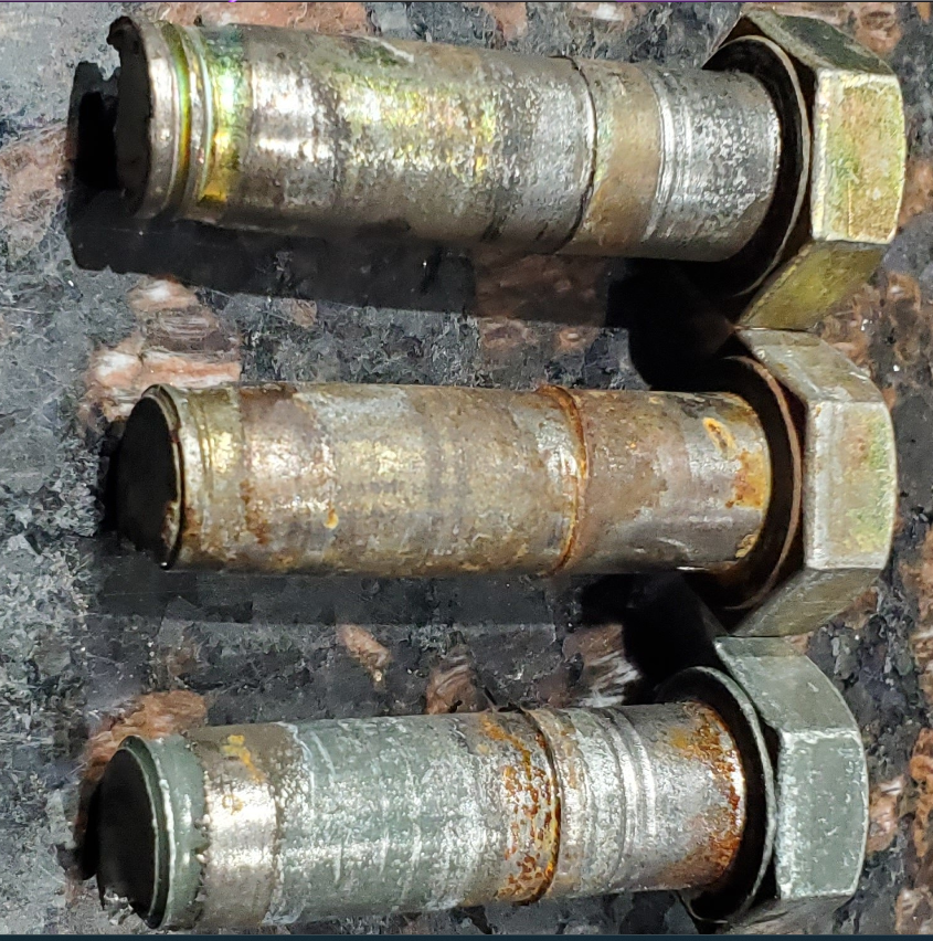

Coming to this discussion late so I have not read the entire thread. Like dicktill said, can you get more pictures similar to post #89 showing the bolt fracture surfaces clearly? There are detail clues on those fracture surfaces that might help sort out what stresses are causing it. (lighting from a couple of different angles can reveal some subtleties on each of the fracture surfaces.) There appear to be differences in the way the Grade 5 bolts are failing and the way the Grade 8 bolts are failing (are these slightly different appearances consistent between all Gr5 and Gr8 failed bolts?), although the differences might not be that great. This also would not be surprising given the difference in strength between the two. There are some features on the fractures here that are suggestive of overload stresses (possible combination of bending, tension, and shear) and there are some features that are suggestive of bending fatigue. (post #36 from WI Hedgehog shows a great example of classic, "one-way" bending fatigue.) Once the fracture mode is known, can work backward from there on "how can the machine impose those loads/stresses on the broken parts?"
Initially I like IXLR8 suggestion in post #84 of using a bolt with an unthreaded body that goes all the way through the assembly, with a threaded section only long enough for assembly washers and the nut. (and, I like washers under both the head and the nut.)

Are you buying your Bolts from the same place? They may not be Grade 5 even though clearly marked on the head. There are a lot of counterfeit grade 5 bolts made in China on the market
and other than buying from a reliable vendor I don't know how to tell.
I have thought about this. Current bolts come from tractor supply.

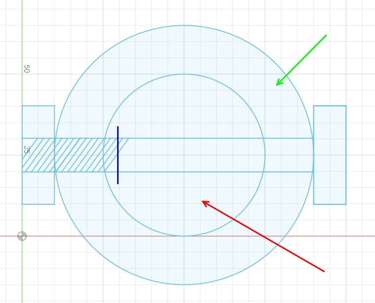

I'm wondering if it's a combination of variables:
  1. The hole in the collar or shaft is slightly oversized or wallowed
  2. The bolt isn't long enough (collar rests on threads)
  3. The bold isn't tight enough - allowing it to spin and degrade
  4. There is some unusual vibration at the gearbox
  5. There are demons at play
First I would use a longer bolt (so no threads in the collar), use a lock washer and tighten it tight. Maybe wrap the nut end with duct tape so you can retrieve it if it fails.
If that fails, see if a 14mm bolt will fit in there snugly.
