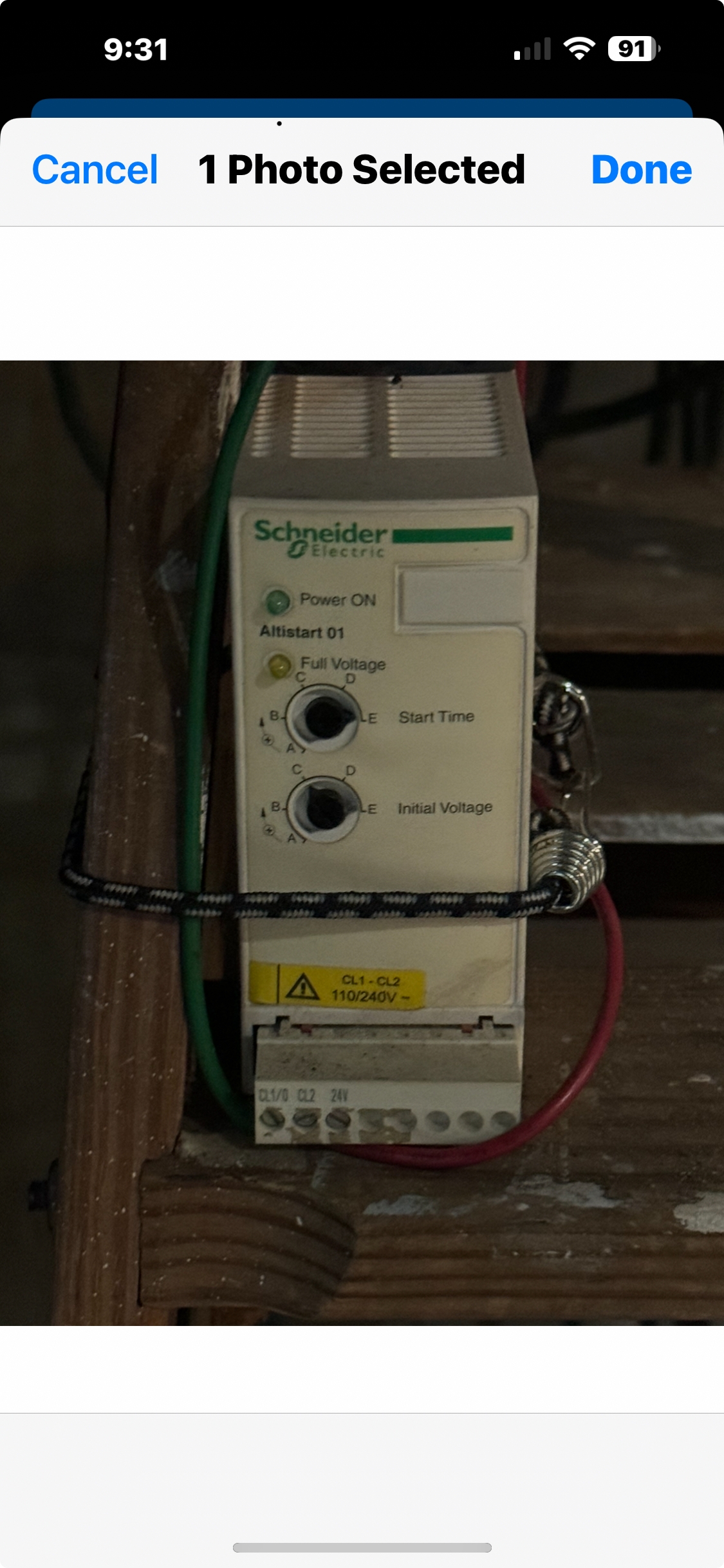

Speaking of soft starts!!!!
Years ago when I was getting all my backup systems in order & synchronized one of my obstacles was finding a soft start device for my wood furnace 1/4hp squirrel cage fan motor.
I have a few generators of various sizes but for a prolonged outage I wanted to use the Honda EU 2000i for long term essential loads which included the wood furnace.
The Honda EU 2000i would go berserk when the fan motor started.
My solution was a soft start module by Schneider electric.
This device allowed the Honda to easily manage the motor.
90cummins
Having a hard time to properly insert this photo.
Hope it posts🙄
