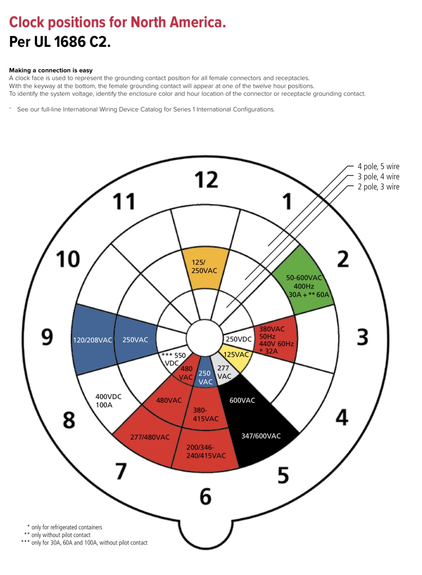

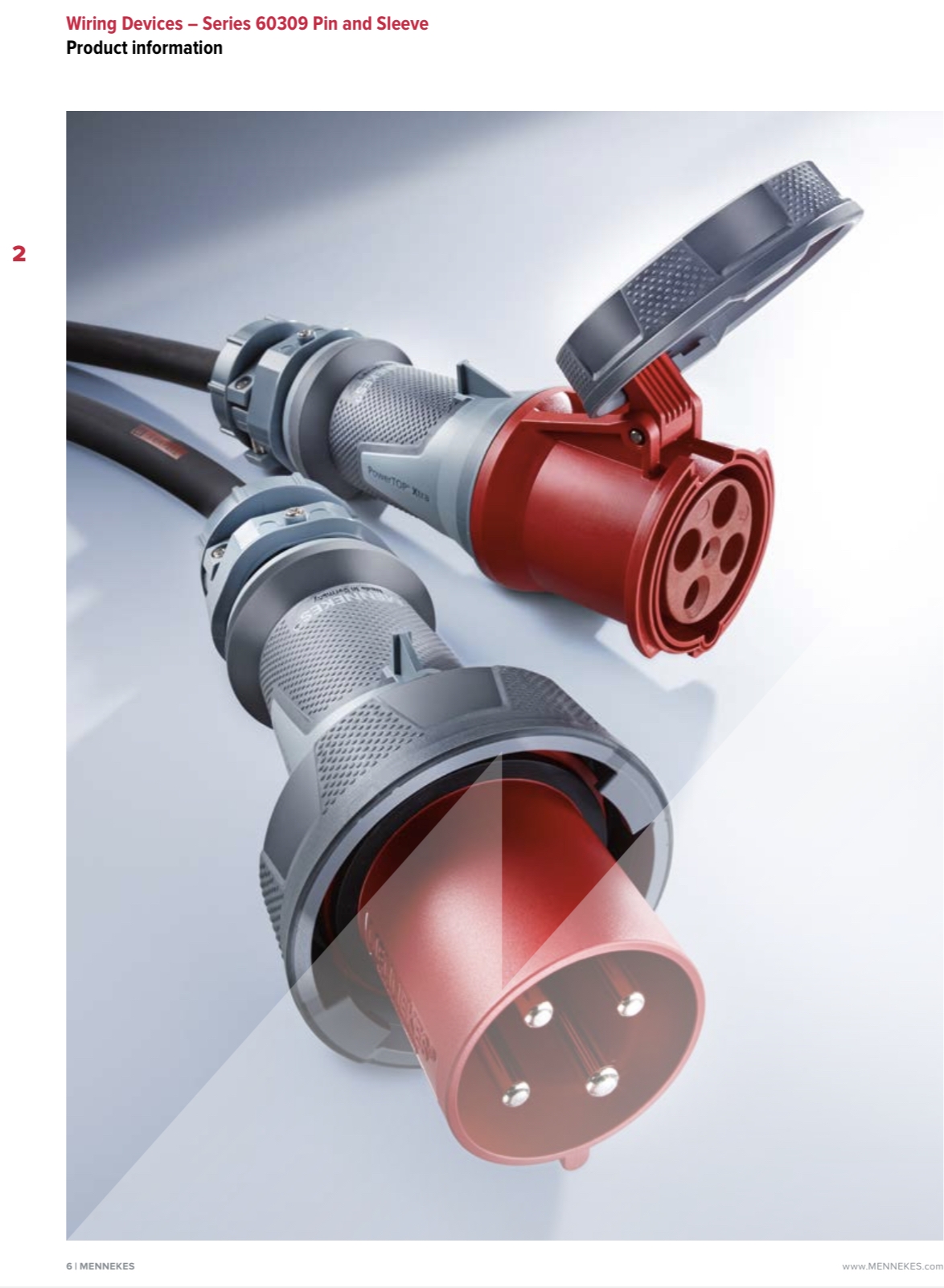

On a slightly different question, for those with 60Amp plugs, how did you connect it to your house? I haven’t found a premade cord and manufacturers want you to buy the plug to install on #4/4 section of cord. That’s fine but what about the other end? Is it wired to the breaker or do you have an external plug?
I looked around for waterproof, locking plug/outlet combinations and came up with pin and sleeve, aka IEC 60309. They come in a wide variety of voltage, phases, and amperage. There are many different manufacturers. Hubbell, Leviton, Eaton, Scame, etc.
The also come with outlets that are only live after the plug is fully engaged in the socket.
The down side is that these connectors aren't cheap.
Here is a graphic for the possible connectors, in 30, 60 and 100A versions;
All the best,
Peter
