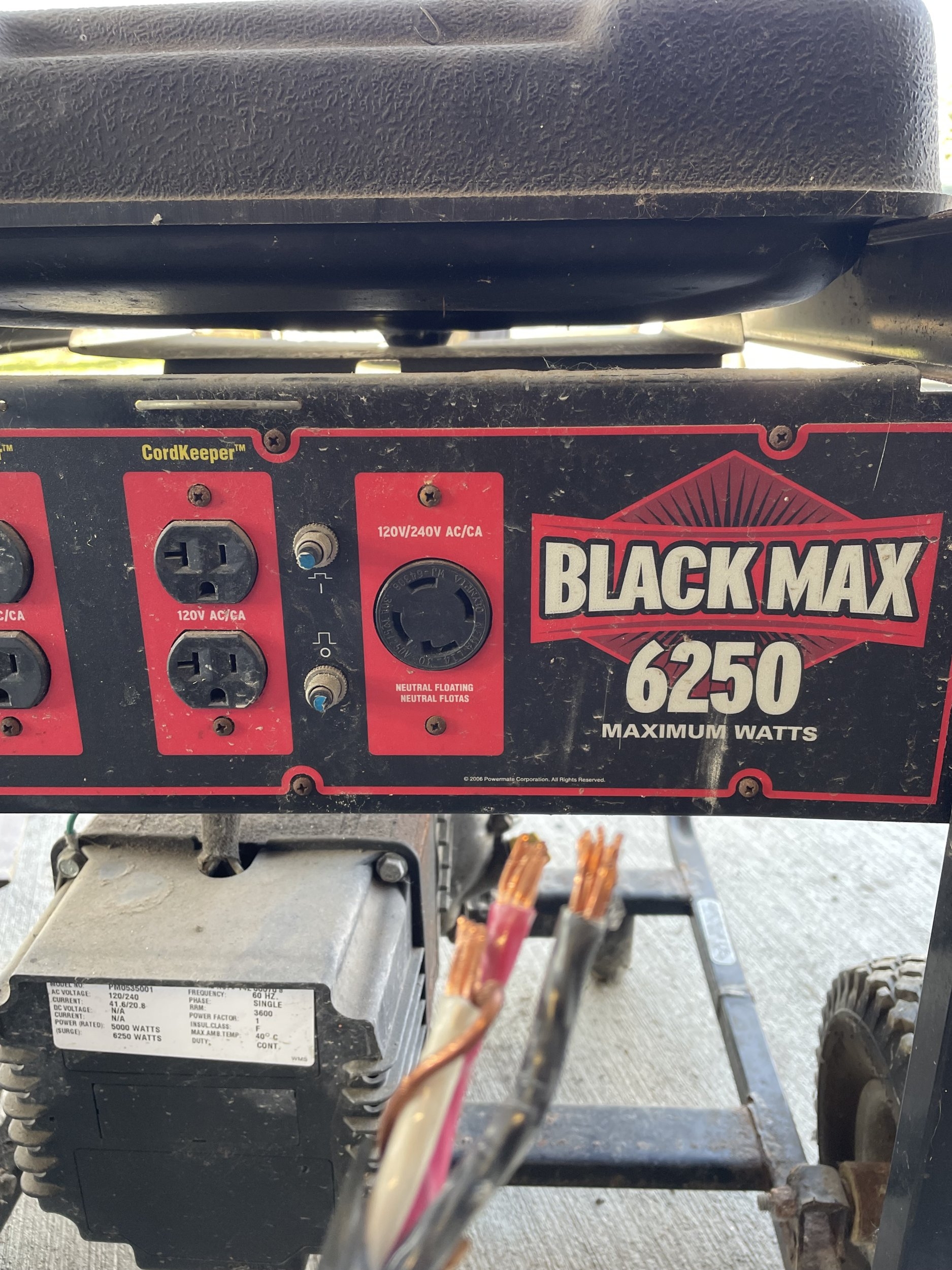

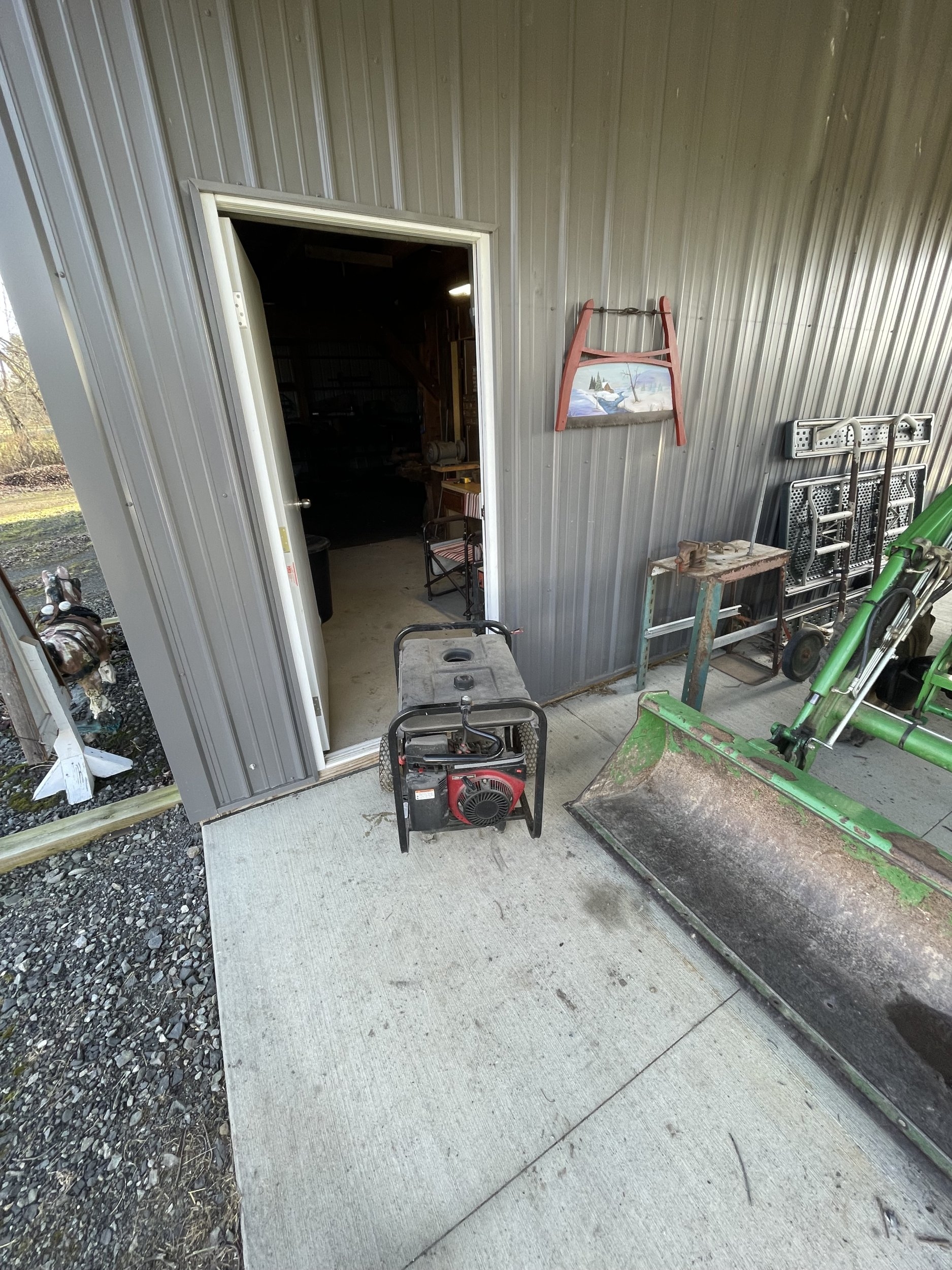

I got to try out my generator hookup a month ago when we lost power for 6 hours. I’ve had this little 6250 peak / 5000 steady Black Max gas engine generator for about 15 years. It’s always been a pain to drag it out during storms, and running extension cords, so I seldom did. Fortunately, we haven’t had any outages longer than 8 hours in that period.
Last winter, I picked up a 30 amp plug from Home Depot, and made up a cord so that I could run it into the 220 volt 30 amp welder outlet, out in my shop. It worked perfectly, during that 6 hour outage, easily running my freezer, (2) fridges, sump pump, several lights, and a tv in the house. I have a wood stove for heat, so I didn’t need it for heat.
I have a porch on the shop, so I could keep it out of the driving rain. It took less than 5 minutes to turn off the main and get all the needed circuits up and running. When I saw the streetlights come back on, indicating that grid power was back, reversing that process took less than 5 minutes.
It seems to me that a larger generator would be overkill for my needs, and a tractor driven pto one would more than double my outage “response time”.
