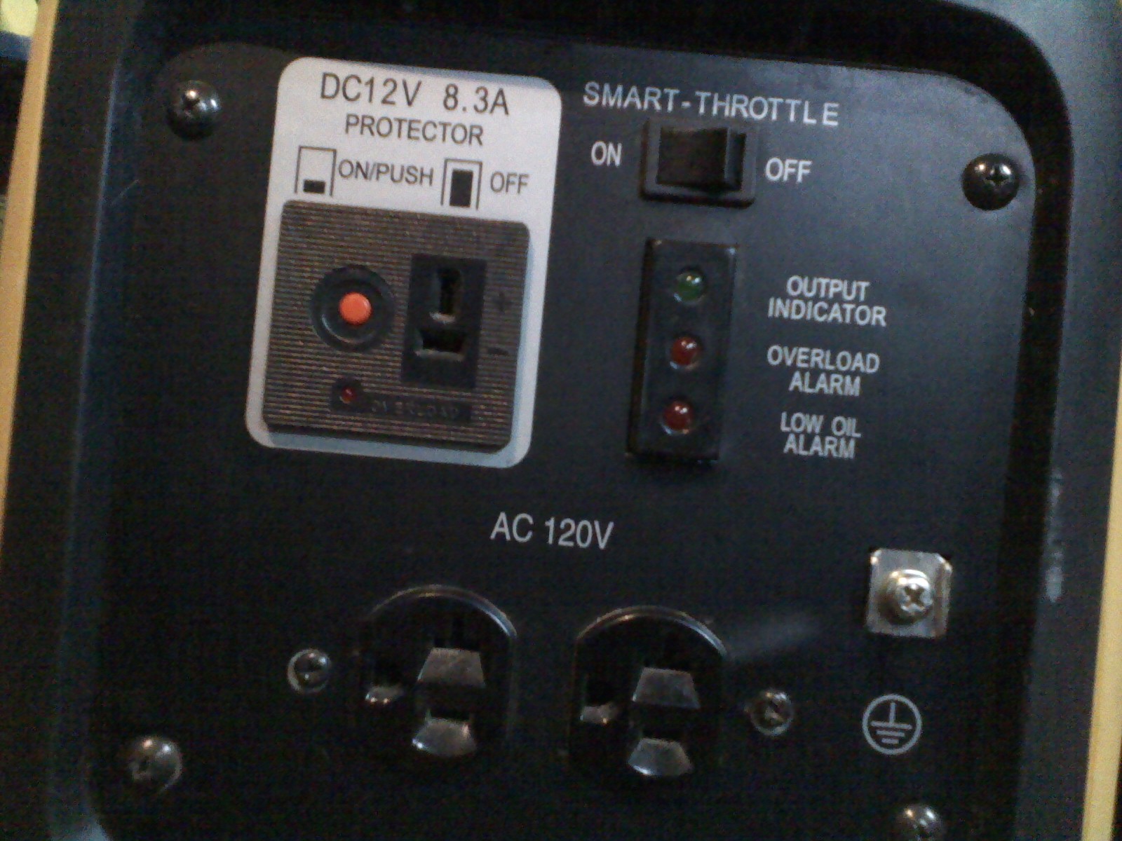

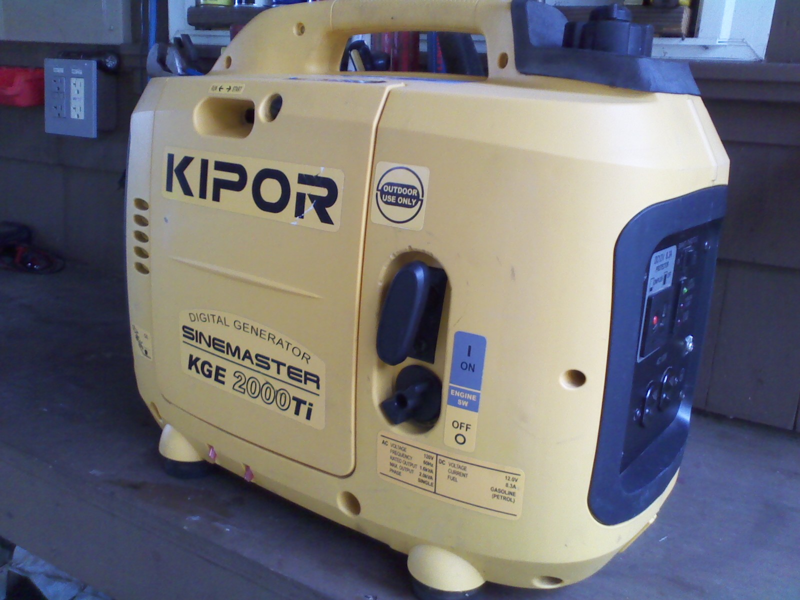

A little hijack, kind of related. I bought a little Chinese Kipor 2kw inverter (1.6kw continuous) generator off craigslist yesterday. The guy told me it was in an estate sale and he didn't know anything about it, but it did not run.
Judging by the picture it looked like new, so I figured someone bought it and never used it. Probably just needed the carb cleaned. I offered $150. for it and got it. Well Now I think I have a nice yellow China anchor, the thing started right up first pull after I replaced some very old gas, only problem is no AC output :mad:
I fiddled with it but no luck, found out the generator is putting out the high voltage ac required for the inverter to do it's thing but nothing coming out of the inverter except 16 to 20 volts DC. Could use it to slow charge 12 volt batteries I guess.
Found an inverter for $350. but am not going to invest that on it. It's to bad since the little thing looks and runs nice. supposedly these are total rip offs of the Hondas. found a storey where Honda won a judgement and seized a boat load of kipors and had them destroyed a few years ago.
Was gonna start a new thread asking for help with it but there is really no use it's just a sad china syndrome :(
