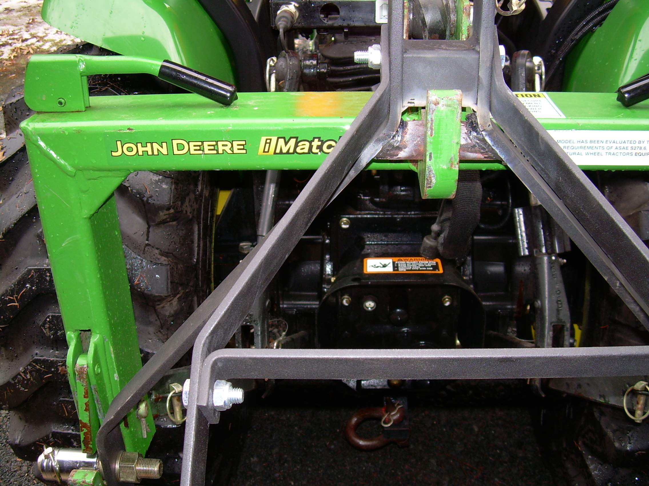

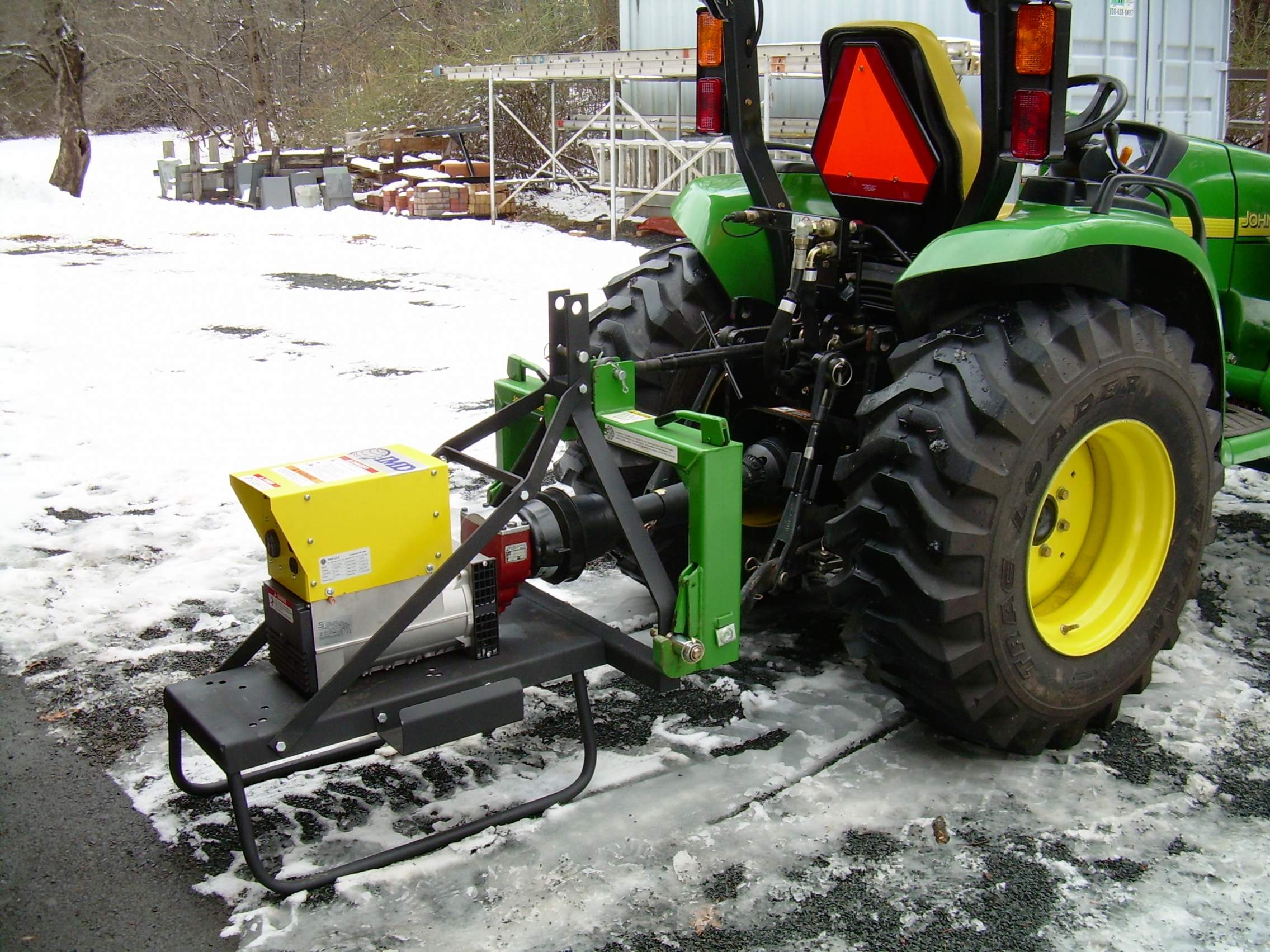

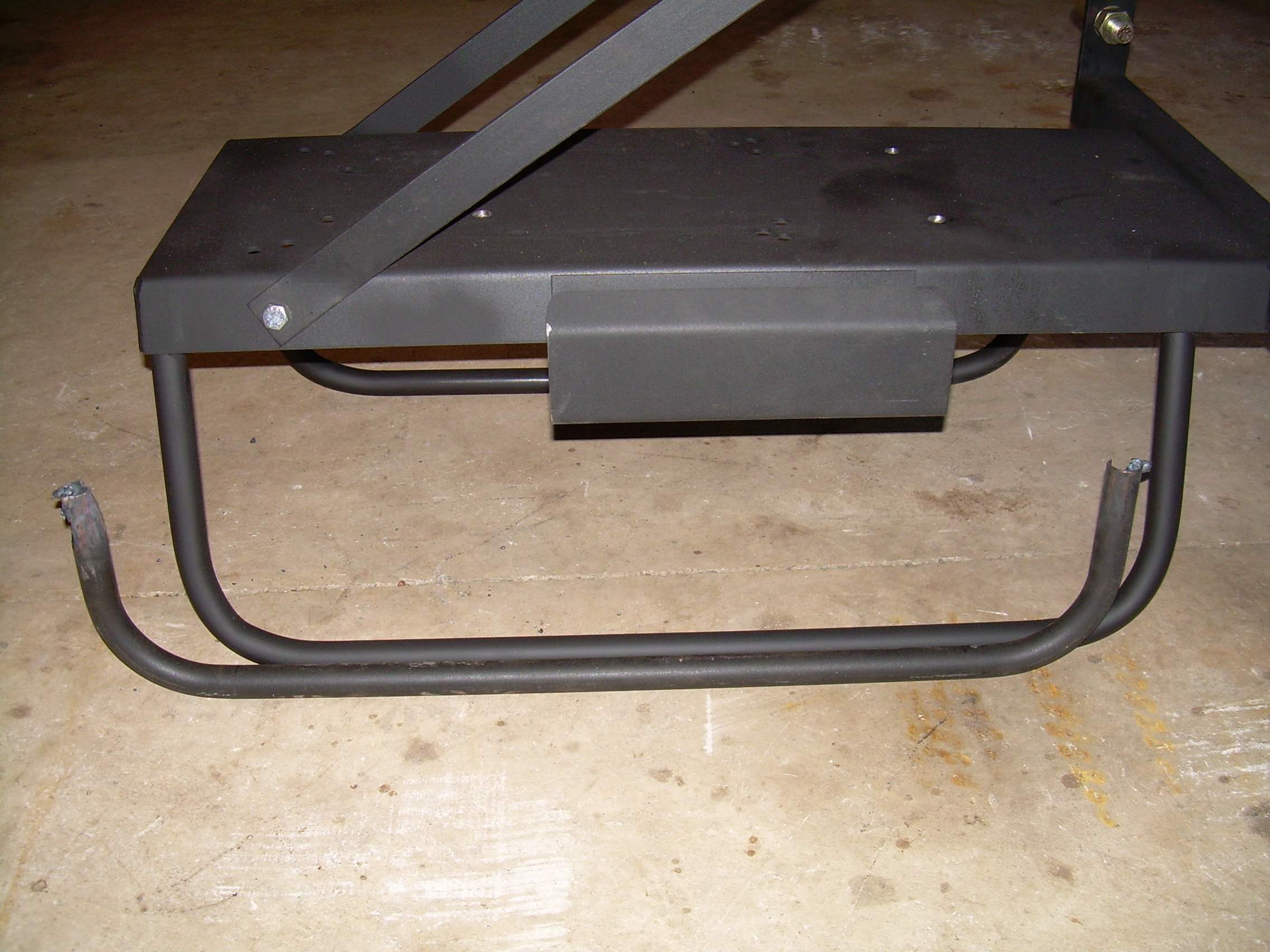

I have the same IMD 10kw AVR
it is not difficult to roll the generator around and line up with the hitch arms.
I modded the 3pt carrier to fit my quick hitch. just a pc of round stock welded in the right spot for the top hook on the QH.
I also made the legs higher, just so the shaft was straighter, probably unnecessary, but maybe it will run a little cleaner yet.
JB
JB
Nice job, JB!!
