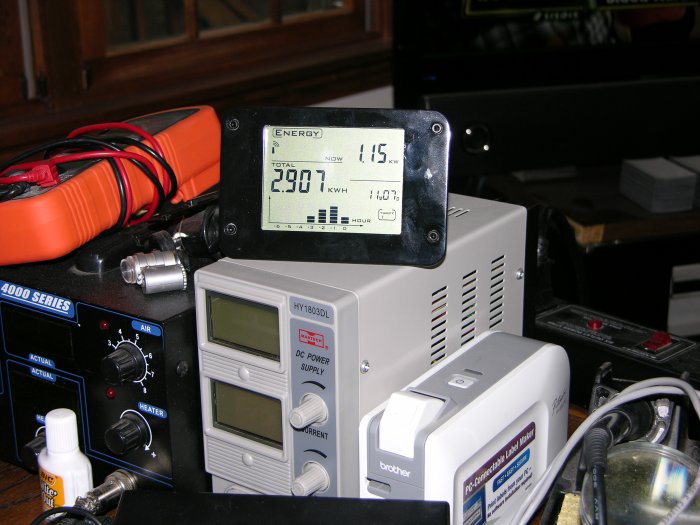

This digital monitor comes with 4 wrap around clamps 2 large and 2 small. I clamped one around each of the incoming load legs from the meter. The probes then plug into the back of a small transmitter that will send the signal a couple of hundred feet to the receiver. It gives a read out in real time and stores a 2 year log I believe. The whole shebang is battery powered.
PineRige
do you have a link this meter sounds interesting
