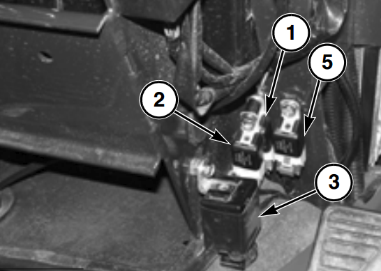

It does sound like a safety switch issues, but seems strange to me. The most likely cause of the engine quitting when engaging the pto clutch would be the seat safety switch. Assuming you are sitting on the tractor when you engage the clutch. But if i was the seat switch the tractor would also quit if you put it in gear. The pto safety switch is normally open, so if that was bad you would not have an issue. This leads me to think that the issue is the engine stop relay.
/ PTO Issues #9
If no bad switch or messed up wires is a safety relay (item 5) that shuts eng off if the pto-seat switches are not correct signals. right side of steering column under the covers.
wondering if relay acting up and sensing not in seat when pto engaged.
The safety start relay (5) is located on the RH side of the
steering column. The safety relay will not let the engine
start if the PTO is engaged or the range lever is in gear.
The safety relay will also shut the engine OFF if the PTO
is engaged or the range lever is engaged and the
operator is not sitting in the seat.
I would think seat switch itself is ok as unit does start. but a jumper can bypass it and fully rule out for testing rest.
EDIT: info is for a 2010 GC24xx, the 23hp version of the 25hp GC26xx. all info should be the same as only difference between the 2 is 200 +/- rpm using the same exact engine.
