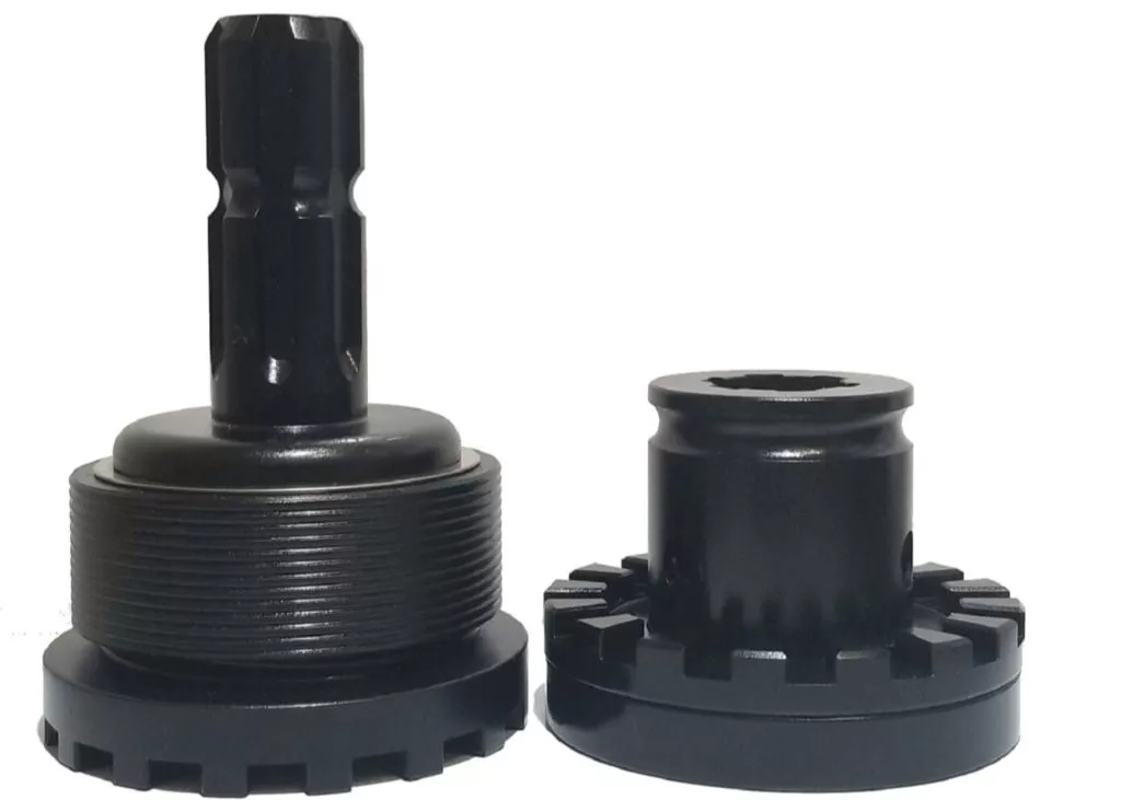

I've been using the PTO quick hitch for 2 years. 2 mowers on/off alot. It's easier than a bare driveline attachment. Plus it gave me a 4" extension which compensated for the Pat's Quick connect. No regrets on this addition. The teeth are about 5/16 wide so shaft rotation is minimal to align and engagement is spring loaded. Pretty simple to use. And it stays clean to handle.
