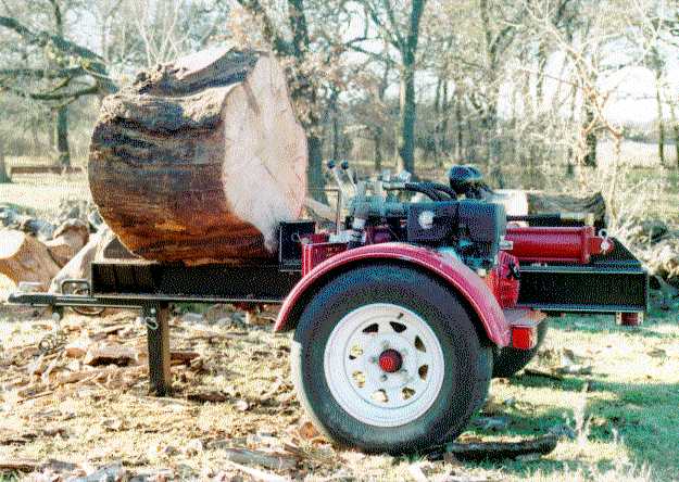

Sounds somewhat like the splitter I built in the late 90s. Log splitter projects are fun.

I must have been a real bear get that block of wood on it.

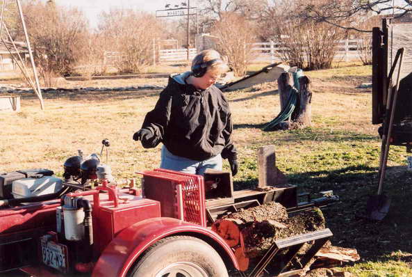

</font><font color="blue" class="small">( I must have been a real bear get that block of wood on it. )</font>
Not really. It has a hydraulic lift arm that you can't see in the original photo. Here is a picture from the other side of my wife running it.
