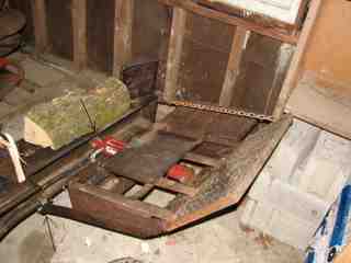

Finally got off my @$_)$& and took some pics while I was welding up the second end plate this morning. Here's the link for a shot of the splitter beam, with gussets and first end plate welded:
splitter
As you can see, I first built the dolly that the splitter will live on when not connected to the tractor. This was because the beam alone weighs 348# and, when everything is installed on it and hydraulic tank filled, will weigh something over 800#. It is much easier to maneuver on the dolly.
Remaining photos follow.

/ PTO Log Splitter Project #51
Mad - you will NOT have any flex in that beam! Wow! Thanks for the pix. Jim
/ PTO Log Splitter Project #53
Mad,
Thanks for posting the photos. Looks good and I agree--no flex for sure. Great dolly by the way.
Ian
/ PTO Log Splitter Project #54
Oh yeah, it's gonna flex. Not like a B52 wing (12' at the tips?) but a little. Very little.
Thanks for the photos!
