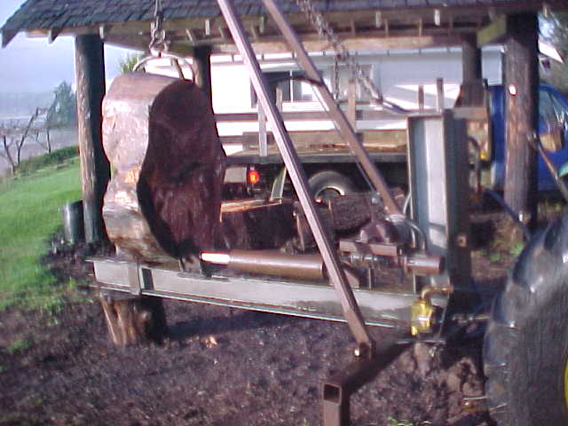

For me and lifting those heavy ones, I put together this one. It has a T type knife so it just takes off two pieces at the bottom with each stroke. The hyd pump is a large one, so the 540 pto speed is ok, but sometimes I hookup the small kubota I have for the 1000 pto speed. Works quite well.
