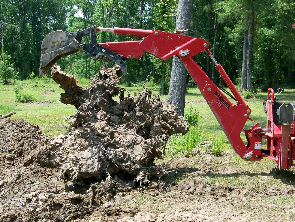

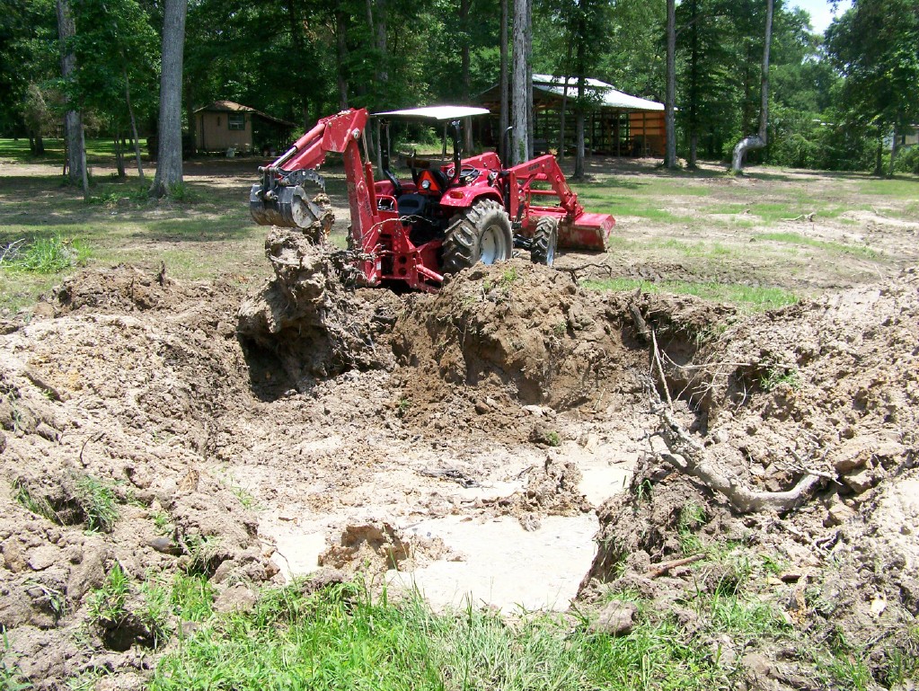

Well, today I passed 100 hours. :) Now I can crank the rpm up when hoeing. :D I had it around 2100 rpm today digging up 5-6 inch oak and youpon and had to slow the swing knob a turn or two. :cool: The 24 inch bucket was just taking one scoop to uproot this size tree. Tomorrow will try higher rpm while cleaing a fence row.
hugs, Brandi

Those poor Texas trees don't have a chance now! :D Enjoy the higher RPMs and higher flow... and let us know how it goes! :) We need a full report! :cool:
Dougster

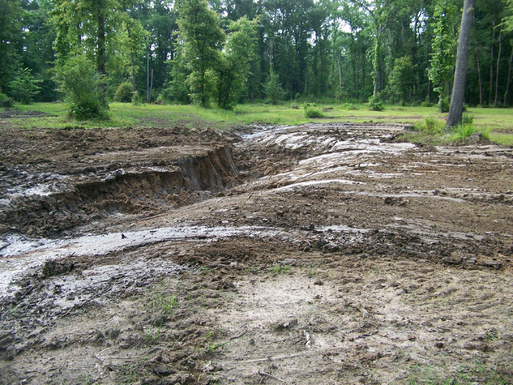

Dougster,
The trees have hired the summer rain storms,so they have a repreive. :( We have had over 4 inches this month already and June was even wetter. :eek:
Just give me two days of sunshine...................:D
hugs, Brandi
