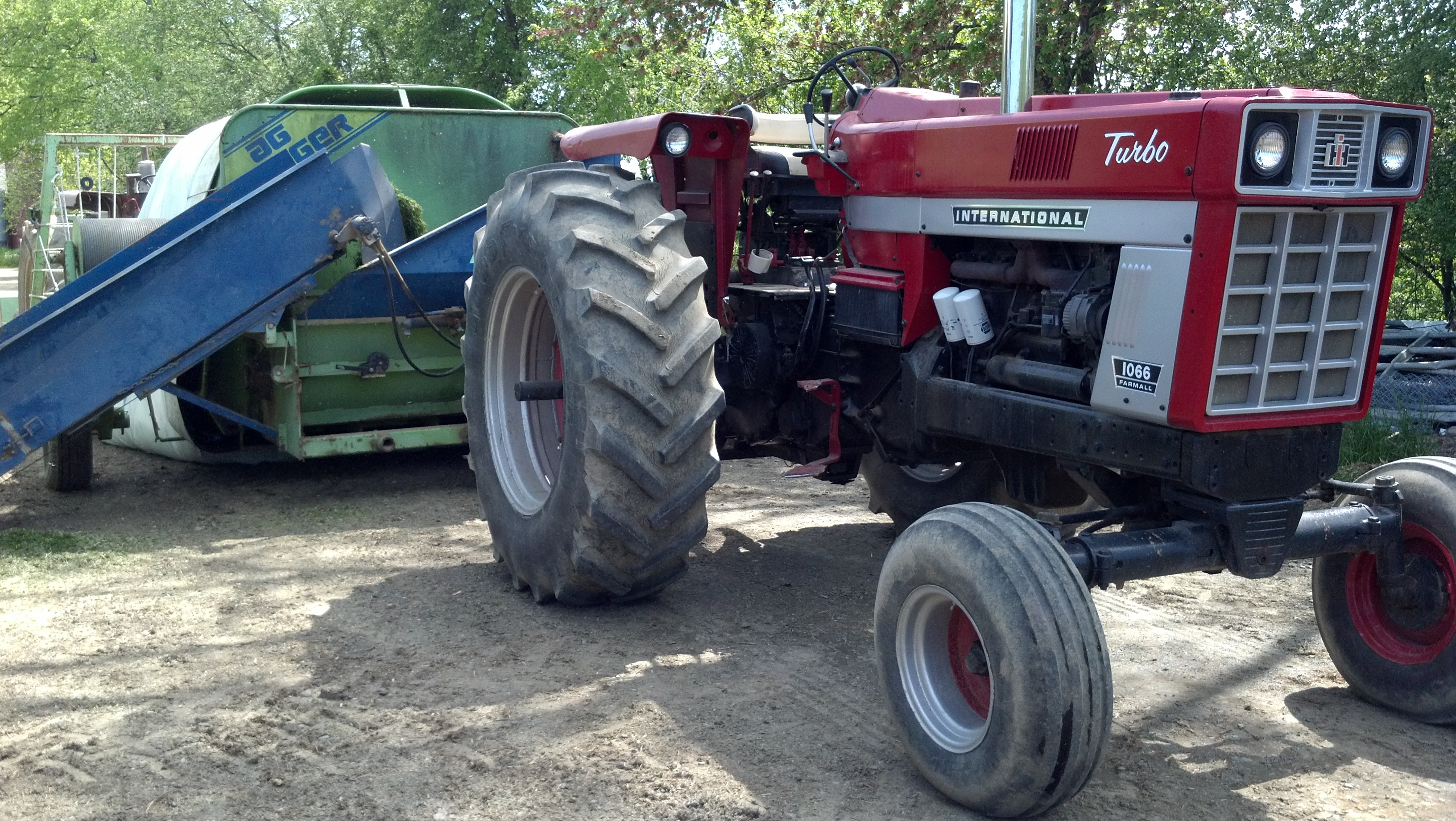

Wow! That is one beautiful 1066! Restored, or just well cared for?
She was a gussied up "stock" pulling tractor in a previous life, turned the pump done considerable for working her. Makes a good road hauling tractor and she's real good on the bagger, she's pushing 175-190 hp on the pto as she sits.

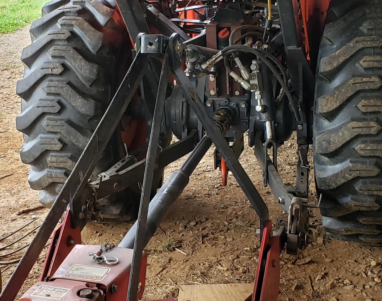

I don't have any shields, all my implements are used and didn't come with any. I'm not going to buy something that I personally don't think I need.
First thing I did to my brand new tractor, removed the PTO shield... Don't worry, Nobody, other than myself, drives the tractor.

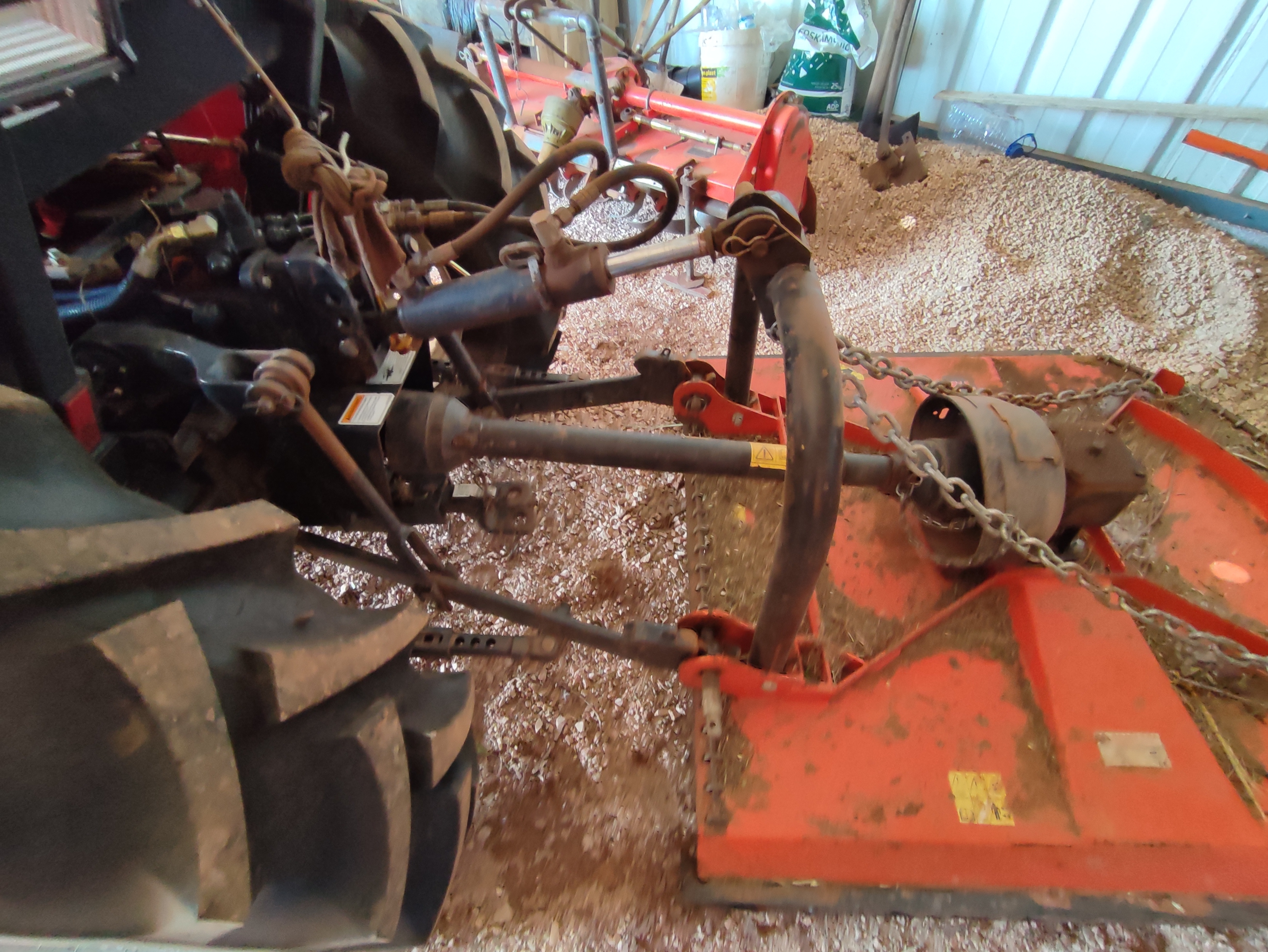

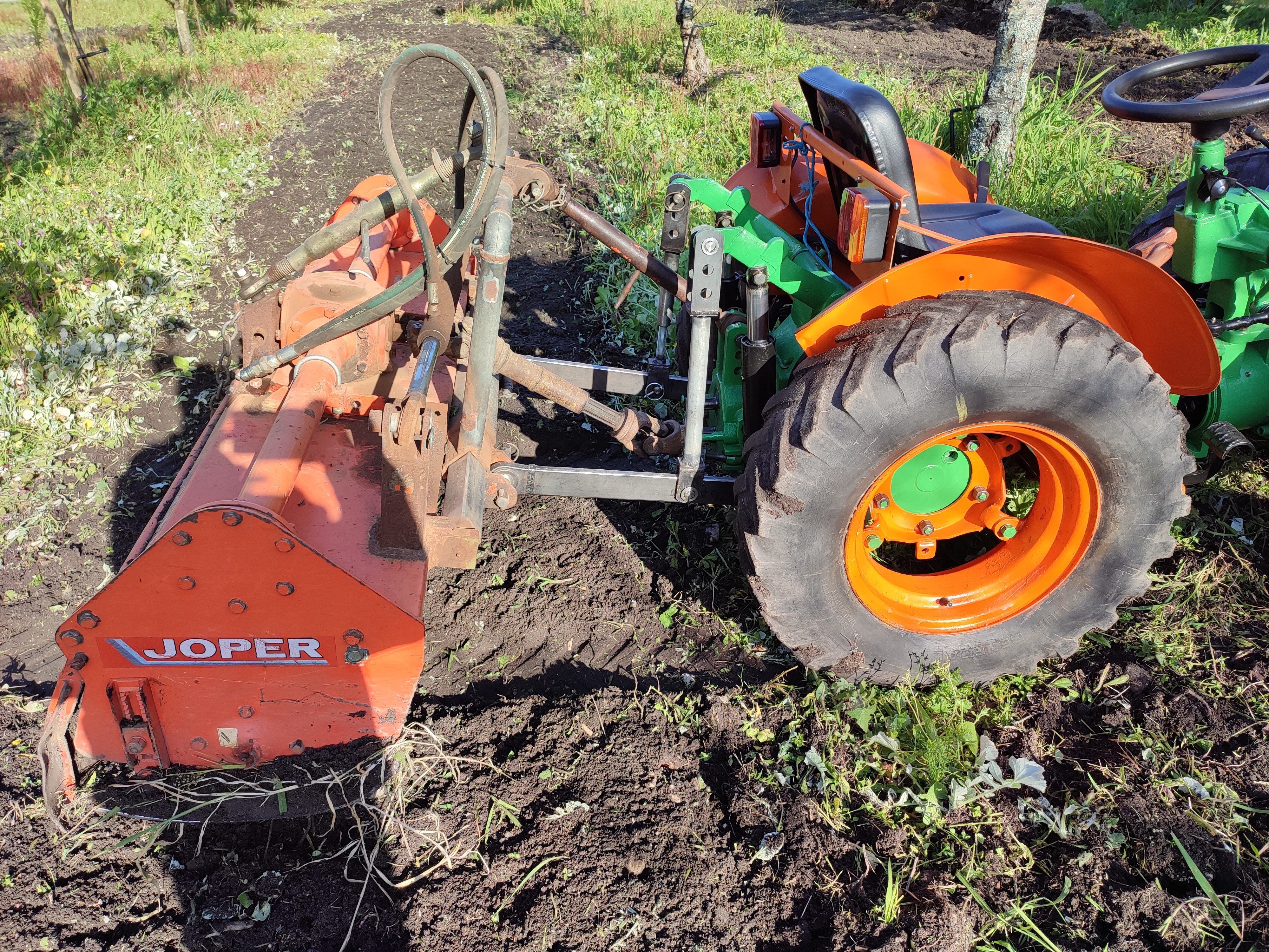

I have two PTO shafts with shields and one without.
Doesn't really bother me having the shields there. I don't know if the shields are less intrusive over here or not but certainly not the end of world that would make me remove them. I can easily hook those shafts without any sort of fight.
If happens to get damaged beyond repair, I'll probably won't replace them regardless.
As far as the tractor PTO stub shaft, the Branson still has the cover there, fixed too. Non foldable. The only reason I had to trim it diagonally about 25 mm on top and 50 mm on the bottoms was because I hooked an attachment with the lower pins too narrow and the side link pin put a nice sized tear on the cover. Way too much work to fix the tear.
The little Agria has no covers at all on either of the two PTO shafts, fairly exposed too. One spins all the time, the other has just gear drag.
