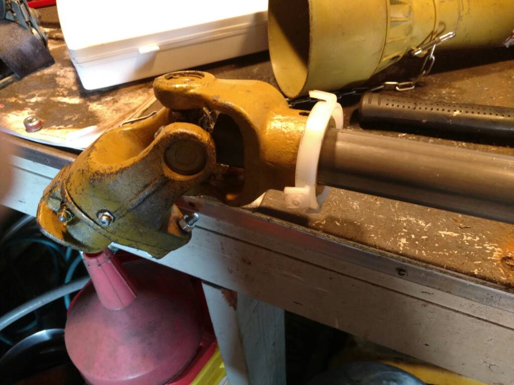

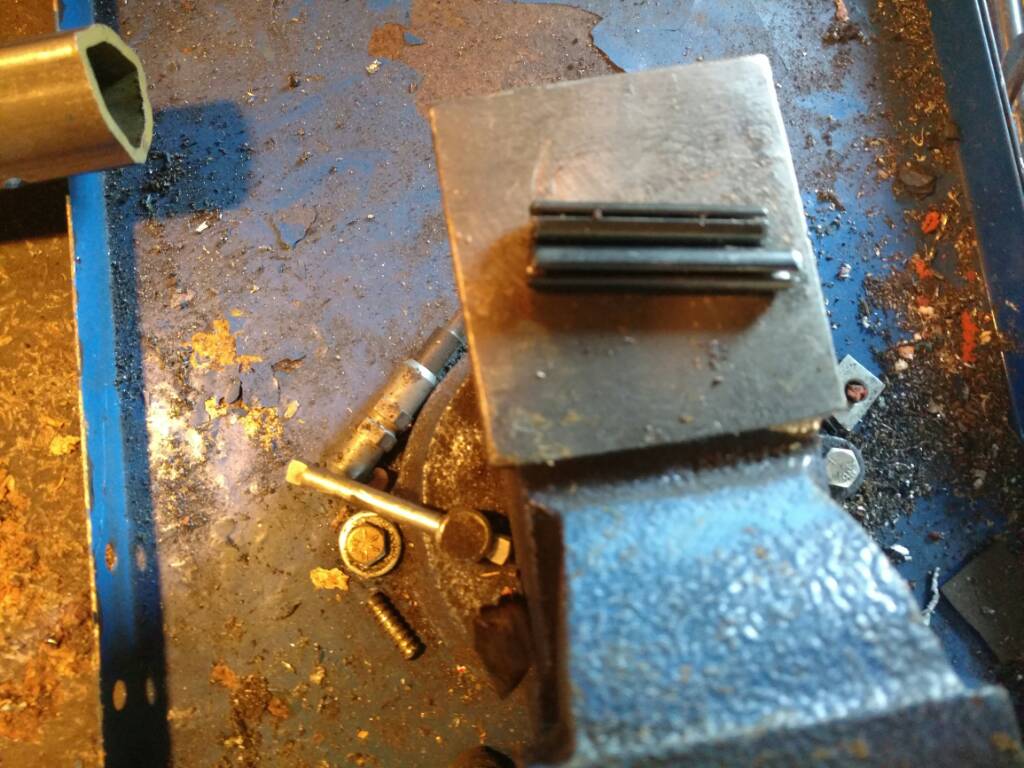

Update folks and again thanks for all the input! Yesterday, I took the PTO shaft apart. Most difficult were removing the plastic sleeves.

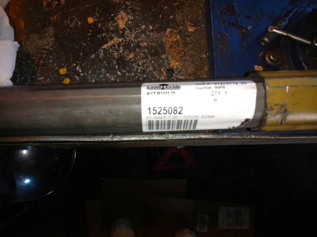

1. I removed the roll pin from the inner shaft portion and took the shaft to my local Kubota dealer. Much to my surprise he had one in stock. Did not know that most of the "quality" PTO shaft parts are made in Italy! $47.00 later, I have a new shaft and roll pin.

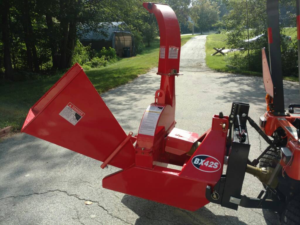

2. Back to the shop, hooked up the chipper and measured the length from the tractor PTO to the chipper's shaft end, 34".

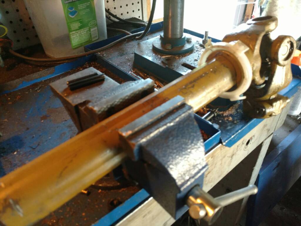

3. Using my cutoff saw, cut the new shaft to length, VERY CAREFULLY, it took 3 cuts to obtain the proper length!
4. Installed the plastic sleeve, the coupler end and the roll pin. Job completed in about a half hour, tested chipper and everything is great for $47.00!
Thanks again guys, you taught me something new and saved me at least $100.00! IMG_20170802_081840.jpgIMG_20170802_081844.jpgIMG_20170802_081850.jpgIMG_20170802_081855.jpgIMG_20170802_092829.jpg

Your shaft is likely a Comer. Youtube has several videos from them.
Great that it worked out.
Now you are the expert for the next guy!!
