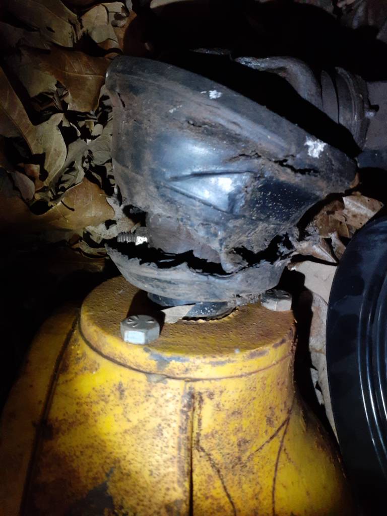

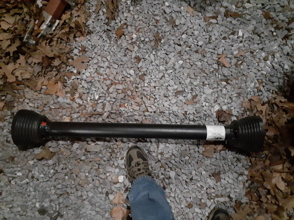

I have a Danuser auger, works great except PTO shaft protector is bad. Tractor Supply had one I got last night will work, but how do I install it? It's shown retracted, it's about 8ft extended.
Next thing is as you can see the attachment piece near digger end is also damaged. I assume that I'd have to order, but how does it attach to protector?

First thing I would do is removed the exposed bolt (under damaged plastic) and see what you get.... IRT may or may not indicate course of action from there....
Dale
/ PTO shaft protector install? #3
I don't know that they all are universal or attach the same way. May need a certain brand/model/style. Like Dale said, start by removing the old and see what you have.
I found out today Tractor Supply is expensive on these protectors. Original one is a Weisler brand, and so is this one. But they were two cheap to include the snap rings and safety chains .
Tractor Supply manager was no help, YouTube videos show installing a kit (easy).
I called Tractor Supply corporate, after an hour on hold girl wasn't familiar with them.
I called Weisler...closed until January 3rd!
I called Danuser 6 times, left message, they must be on vacation.
I saw online Tractor Supply sells clips and chains separately.
Tomorrow I think I'll return it.
