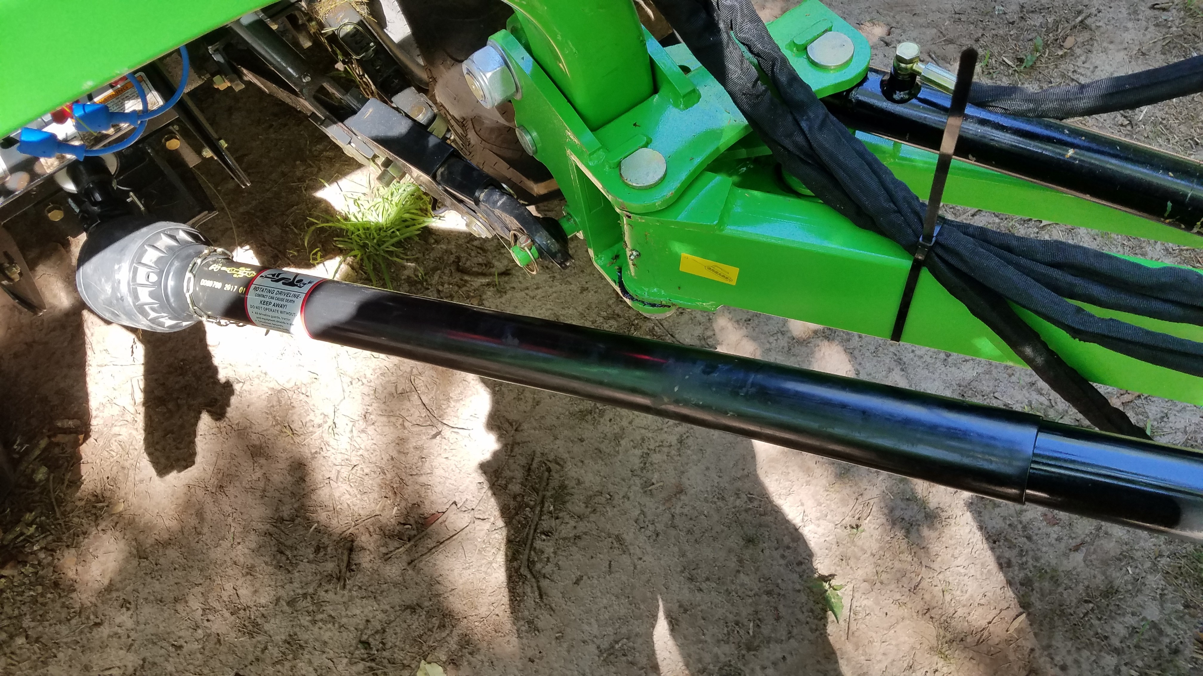

I would agree that as long as the 2 shaft halves slide freely, and there are no cracks just scratches, it should be fine.

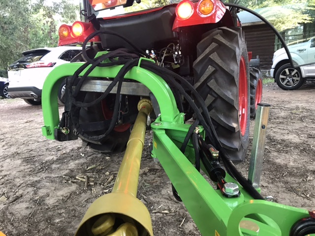

Well mine made it today and I thought I would share a picture of my PTO shaft clearance with you. Keep in mind it is hooked to the quick hitch which makes the angles worse. Also this is without a PTO extension. Most likely I will not be able to use the quick hitch with this mower.

Got new PTO shaft and extender.
Everything works perfectly.Very good mower.
Thanks again for the good advice.

I recently bought a Pheonix mower of same design. Think they and one other company I looked at do not recommend using a quick hitch with the mower. Think one reason is the weight the weight shifts. When mine is shifted all the way to either side you can hit a tapping noise knowing the universal joints it too sharp of an angle.
