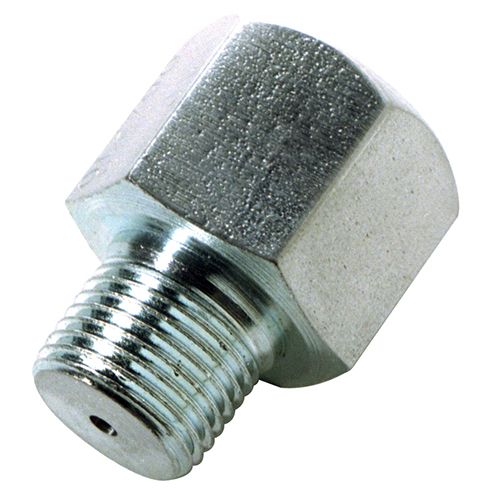

As far as slowing the cylinder movements you can add a restrictor orifice like this.
   / PTO Shaft Safety Shield damaged on Victory Flail Mower #14
Normally where the hose connects to the cylinder. Just have to make sure of what size and type fitting is on the cylinder. I would put it on the return line for when the head is lowering down. That will slow things down.
They also make an adjustable type that can be used. I have one on my Kioti rear remote valve.

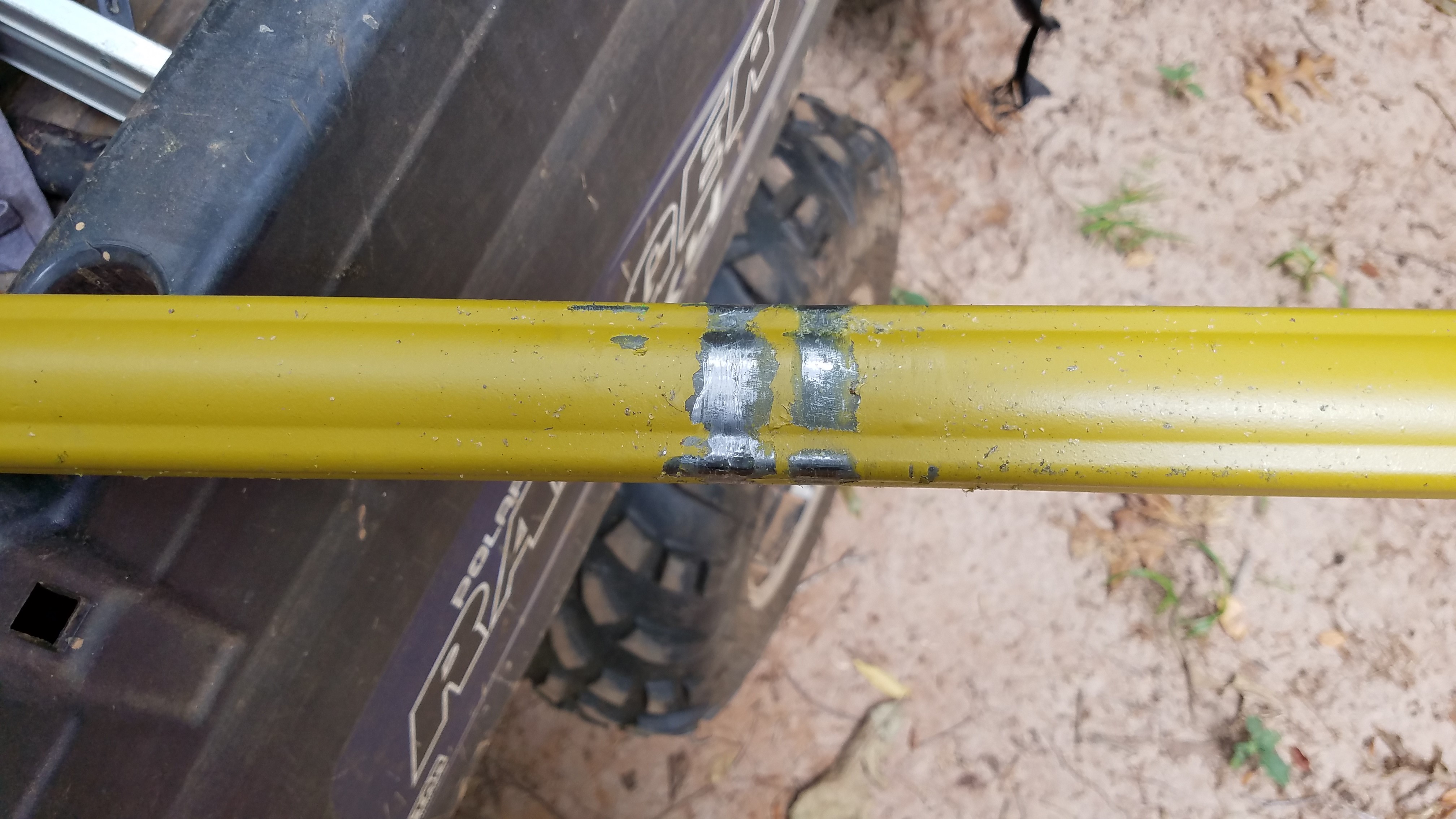

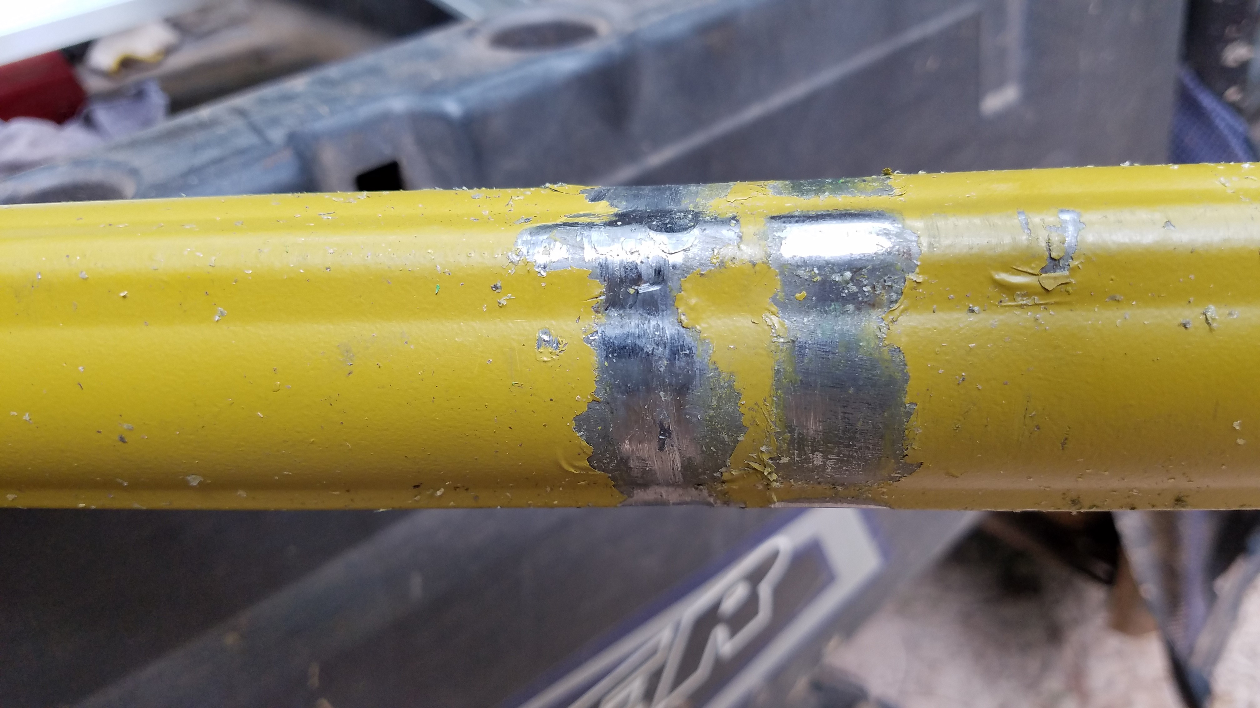

Looks like it got hung up on the off set pivot point. How much clearance is there? Looks like it is in perfect alignment to get chewed up on the grease zerk, there are other marks on the pivot point that are also in line with the damage.

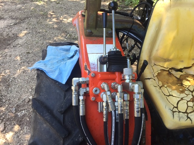

Are you talking about the 3 point raising and lowering too fast? If so, there is a control knob somewhere around / under the tractor seat to slow it down by turning in or out.
Clearance about 1 inch.

How bad does the PTO shaft look?Should I replace it or not?

From the picture I can't tell how deep the scratch is. But if it slides in and out then it is not bent. That would be my main concern.

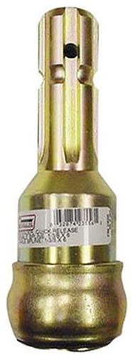

Thank you for help.By the way, the information from his website about mower is incorrect.
Nbr. Of Flails not 18.Only 16.And Flails 400 gr,not 800.
Spoke with owner today.He knew about this problem and will send me PTO shaft extender.Also will refund me for new shaft shield.
