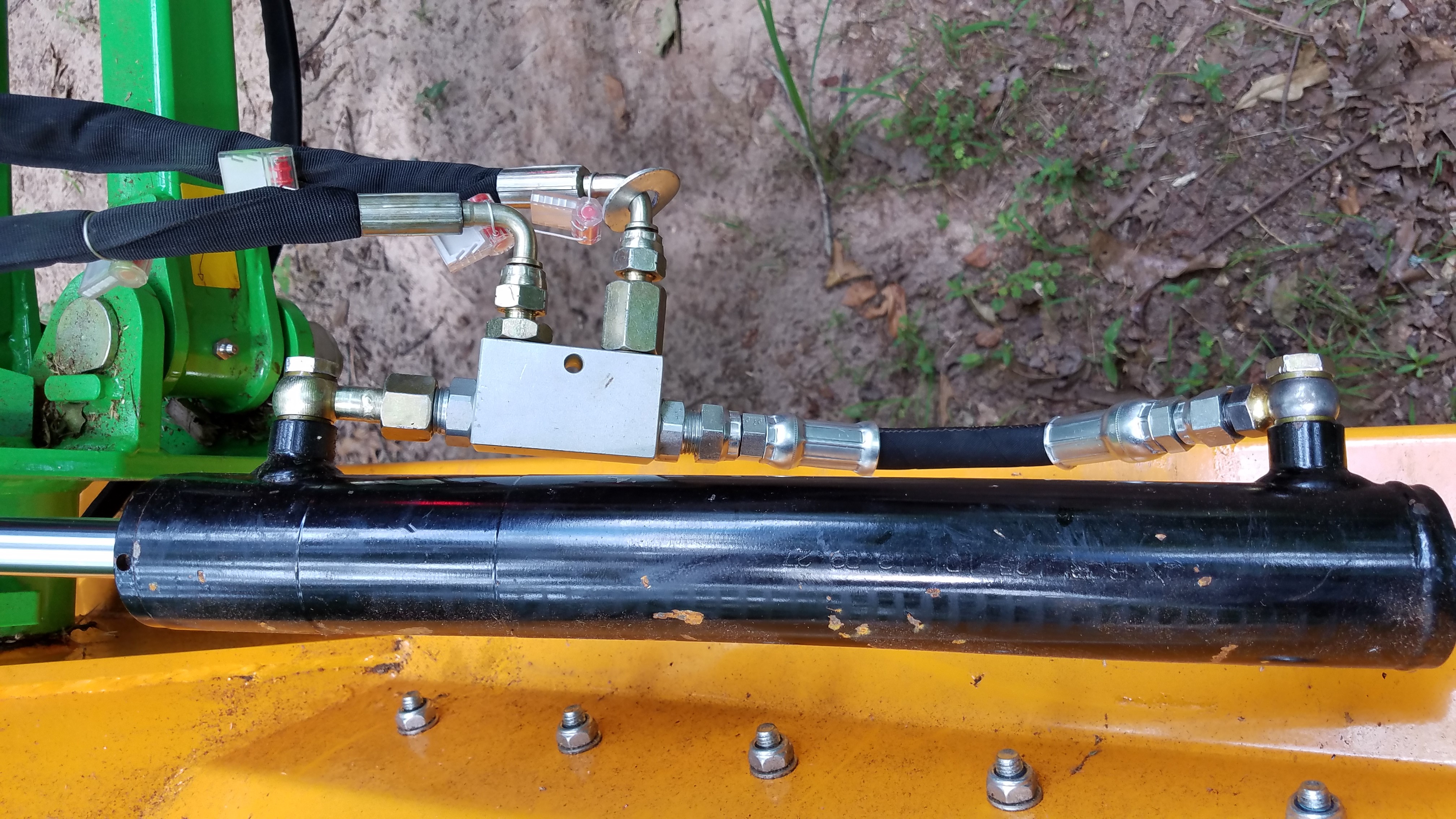

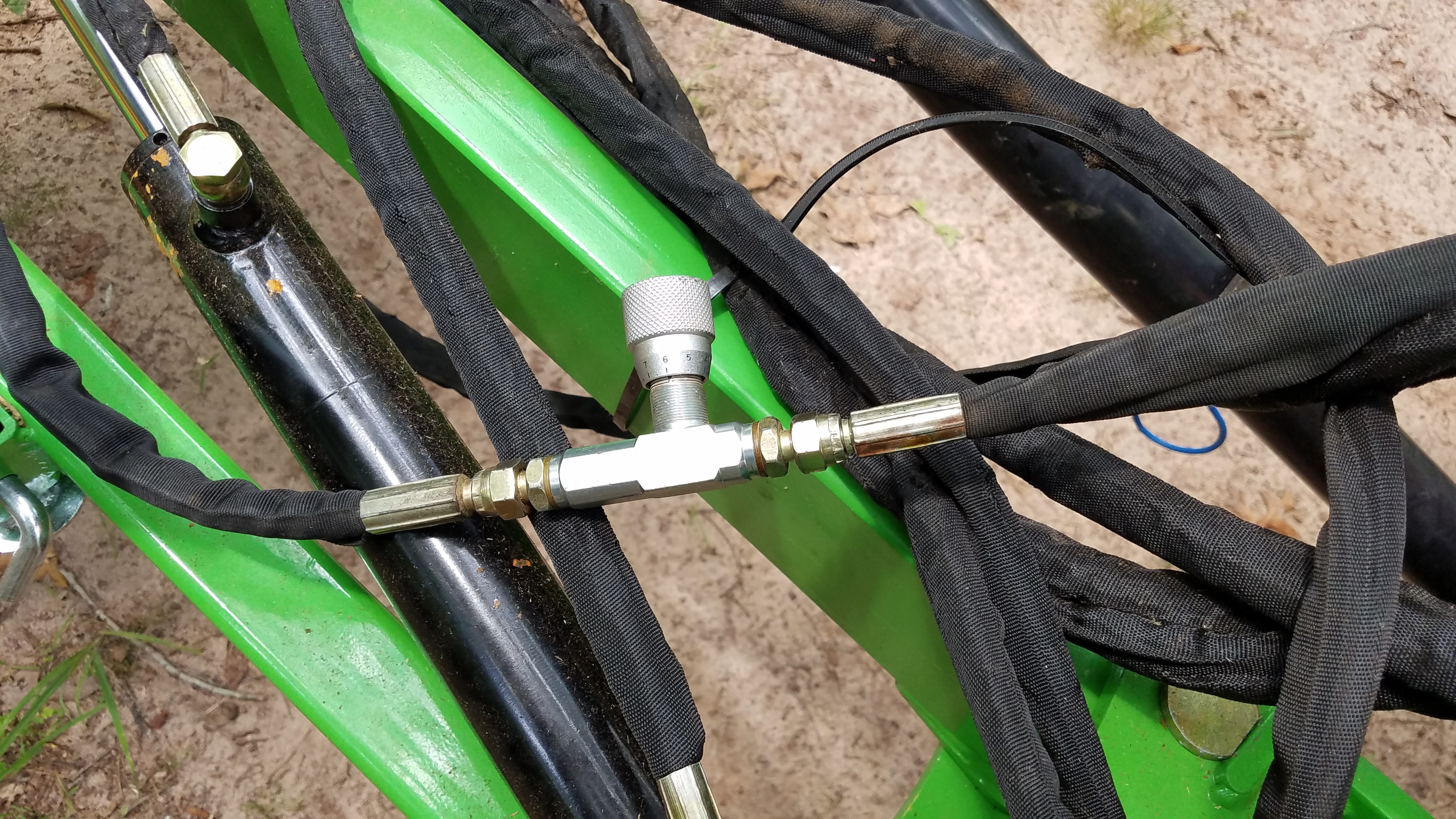

They make simple needle valves that restrict flow in both directions. surpluscenter has them.
   / PTO Shaft Safety Shield damaged on Victory Flail Mower
#33
Much better now.
   / PTO Shaft Safety Shield damaged on Victory Flail Mower #34
Nice job! The orifice restrictors I ordered will be here Tuesday. I am happy with everything else. It would be nice if it had another hole for adjusting the height but I managed to overcome that with a longer top link.
   / PTO Shaft Safety Shield damaged on Victory Flail Mower #35
Thought I would update you with the orifice fittings I used. Made shifting the mower a lot smoother.
