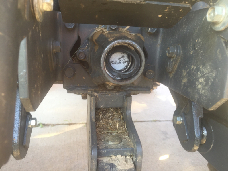

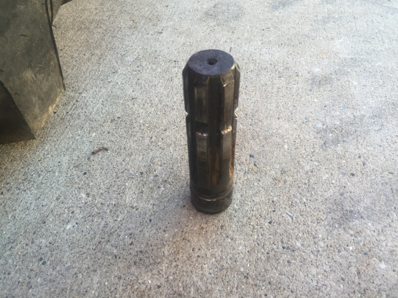

Does anyone have knowledge on this repair? I am having a tough time finding a diagram. Has anyone been through his before?
It's on a Kubota L5240
I know how it happened and why it happened, and it won't happen again. Just looking for advise on how to fix it.
I ordered the part and seals today.
Pat number TD170-23700

Nah, I'll explain later. Just need to get it fixed for now.
   / PTO shaft "stub" broke off

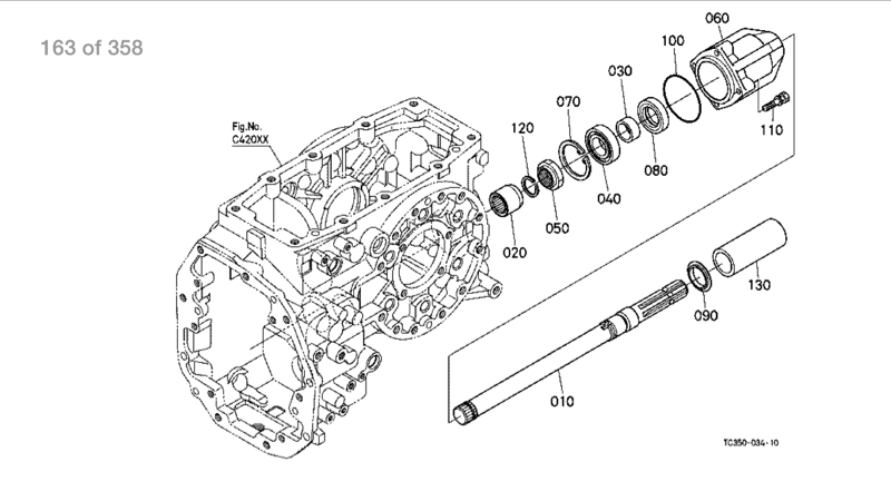

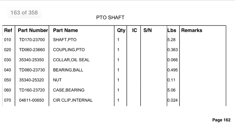

Ok, same part number but different tractor. Possibly the same hook up....
Thinking out load here trying to resolve my situation. Please bare with me as I can also only post one photo at a time.

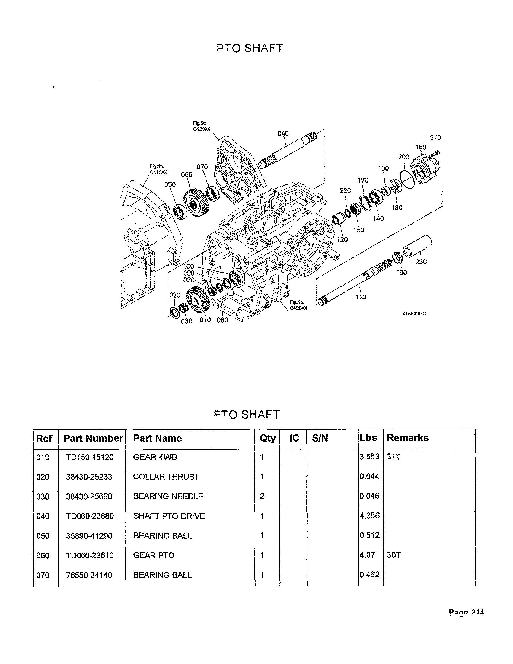

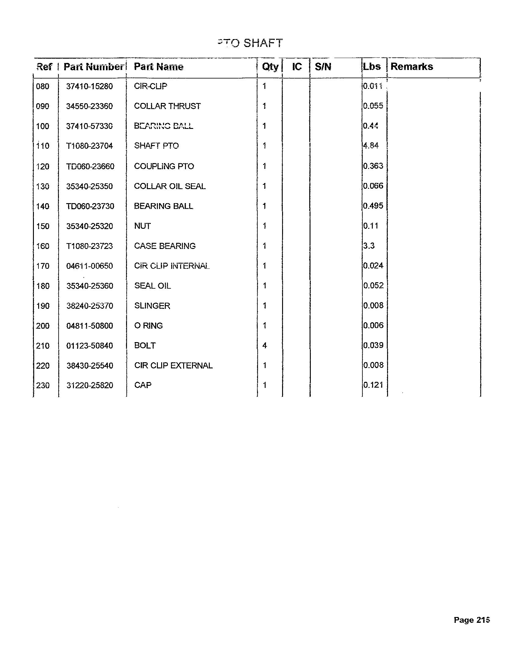

Might not be bad at all. I 'm sending the parts list for my L4240 the part # might be different but you can see how it goes together. There is a nut on the end of the shaft #150, now if the clip #220 is for holding the coupler #120 to the #040 shaft then it well just pull out.
This is helpful. But now looking at your diagram, I wonder how far the shaft goes in. I am curious to know if the shaft slides all the way through to the front of that block or where 040 comes in to play.

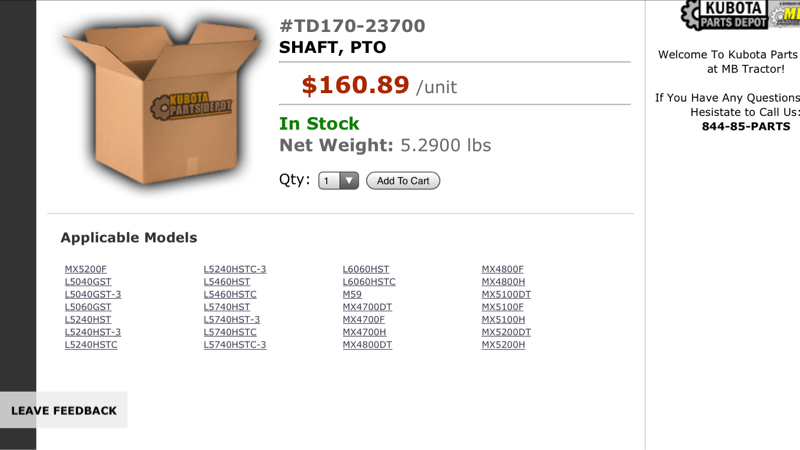

#9
Looks like these are the applicable models for this part number.

Here is the stub that broke off
