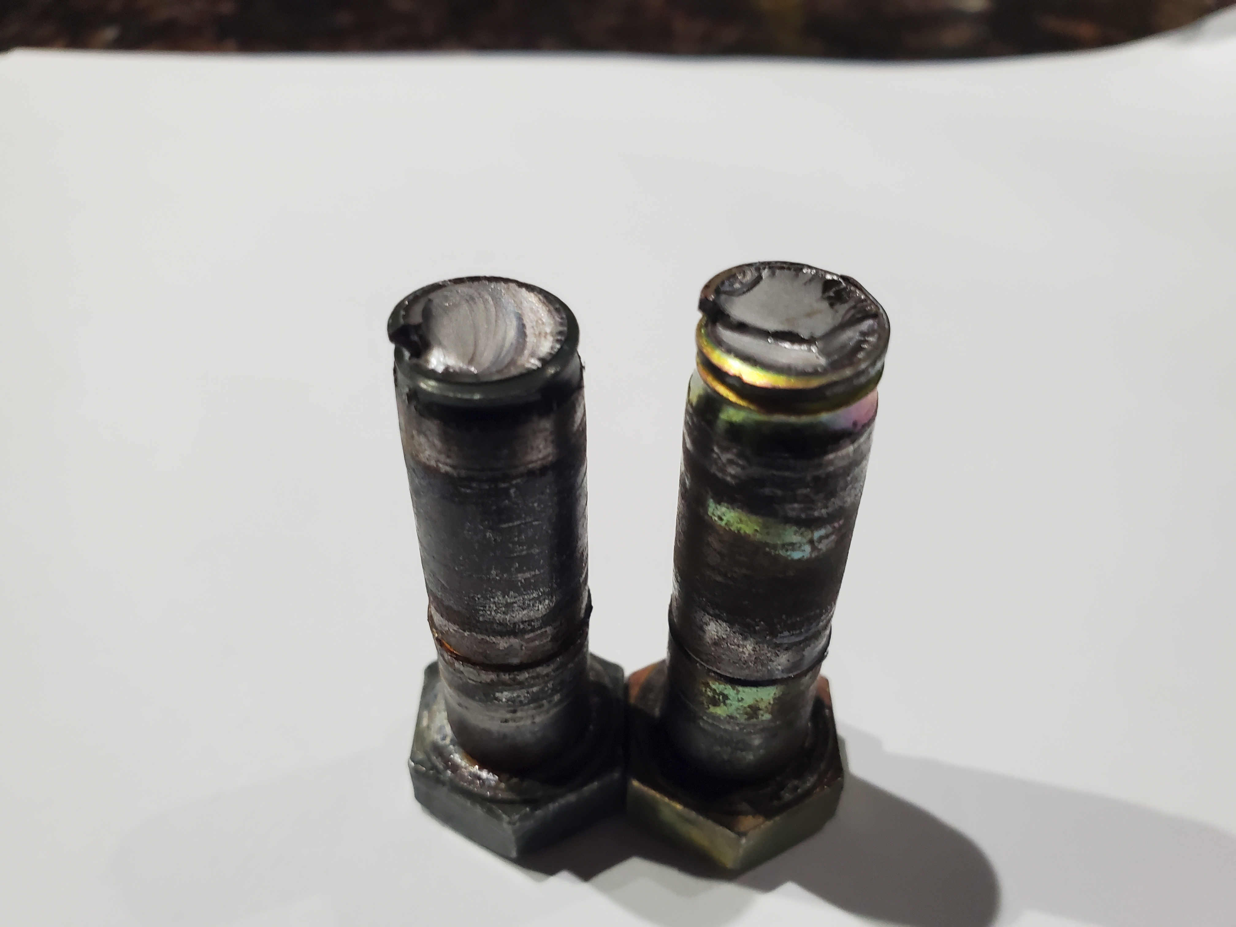

This is something I have asked before and also researched but never got a good definitive answer. Mostly just speculative opinions!
Some say "bolt" should be left loose and other say tighten up good.
What I have been doing is to snug the bolt/nut down so the bolt doesn't slide in its hole.
I am going to tighten them down now and see how that does. Only thing I see this doing is just loading the bolt. It won't make the PTO shaft any tighter on the gearbox input shaft or reduce any movement between input shaft and PTO shaft.
Worth a try.

I understand all of that and understand preload.
What I see though is the only "stretch" force on the bolt is centrifugal force of the spinning shaft which has to be pretty minimal.
Bolt is tightened so there is no sliding movement of the bolt. Just snugged not torqued. Odd thing is that this one breaks bolts fairly frequently but none of my other cutters do this. I have 6, 5 footers and 2, 6 footers.

   / PTO Shaft to Gearbox Bolts Keep Breaking! #45

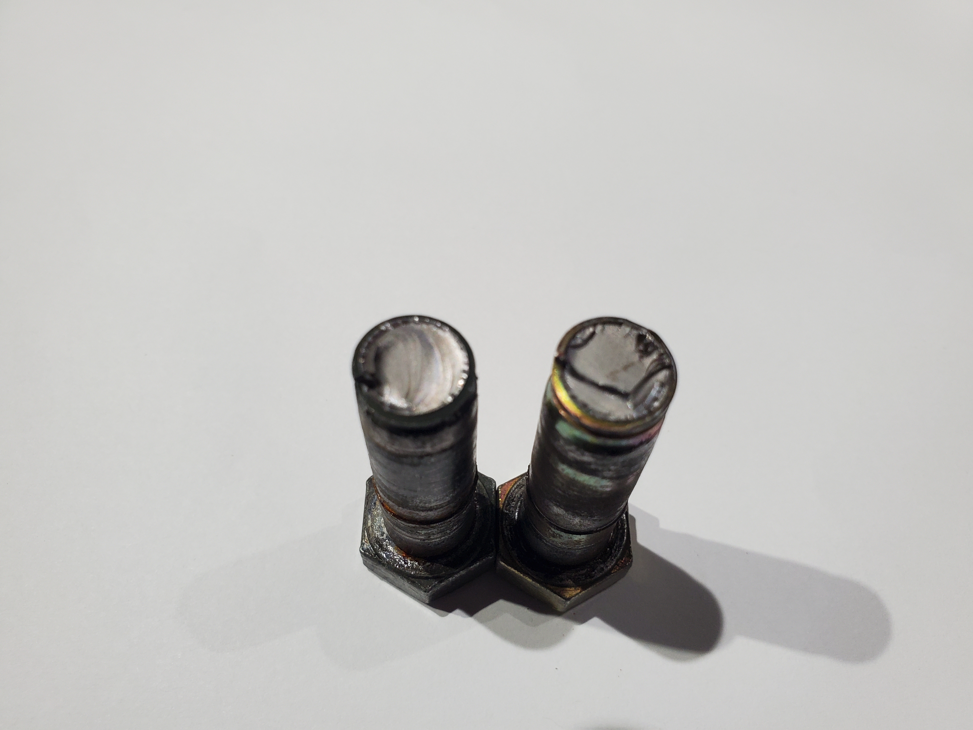

From the posted pictures it appears as if only one end of the bolt is taking the load. Normally a shear bolt shears both ends and leaves the center of the bolt in the shaft with the ends being "lost". Are both holes in the yoke the same size, or is one slightly larger? As for tightening the shear bols I have always tightened them tight and "given them another turn" as the old timers would say. Figuring the extra squeeze put on the yoke would take some load off the bolt and reduce any "hammering".
Some shafts I have seen use a key to drive and a bolt to retain the PTO on the gearbox shaft. Are you missing a key? This is usually used for a slip clutch.
Is the slip clutch too tight or rusted tight? A slip clutch is not only used for overloads but a "shock absorber" too. If tightened too tight or rusted it will have no "give". Tighten the clutch until it will just take the load after loosening it and slipping it to clean up the clutch surfaces.
I agree it is odd that only one side is breaking. Probably a clue. When I used to run a shear pin style shaft on this cutter it would break both side just as you described.
I could tighten the bolt to just before breaking and it would not compress the PTO shaft at all where it goes over the gearbox input shaft. It is a very thick.

Not a great comparison, but if you only snugged your lug nuts down, breakage would follow.
Based on the photos, those bolts have taken some serious shear forces.

That is the thing, they haven't as far as cutting goes. As mentioned, I am cutting field grass, maybe 2 feet high, on flat smooth land. It's just early spring growth, nothing even heavy.
The cutter doesn't hit anything, it doesn't bog down. No indication of any big shear stress. That is what is puzzling.
These bolts are breaking after 6 or 7 hours of cutting. Some of my other cutters will go the whole summer without breaking a bolt and some of those are being used in quite rough areas.
One thing is that the bolt is only breaking on the thread side and not shearing like you might expect from a typical shear force incident.
Once the rain quits I am going to pull the shaft and inspect the bolt holes and see if I can find anything.
Also am going to change to another PTO shaft and see.

As mentioned earlier, it looks like the bolts have been "rattling" in their holes, until they give up due to the shear forces. Work hardened if you will.
I don't think it's one "shear force incident", but repeated abuse from not being tight.
Could be but I do tighten so snug, no play, I just don't crank them down!
I agree they are getting banged up some.
Going to pull the one that is in there and see how it looks. It has about an hour on it.
