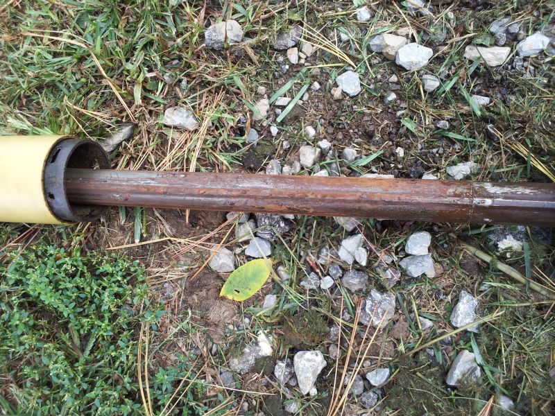

   / PTO Shaft #14
Got mine apart this morning. chained to a tree, and this time pulled with the tractor in 4WD :eek:. The 1/2 can of spray I used had never reached the rusted area. I had left the shaft mostly closed, now I will keep them almost fully apart. Cleaned it up and greased it up good, and good to go. Now I need to get my auger fixed. One of the cutter edges is bent down, from catching on a rock once, and pulling it out instead of turning it backwards. I checked by rotary cutter shaft, it's ok. i keep it outside but under an old truck cap, so it keeps it out of most of the weather.

   / PTO Shaft #15
i like the diesel soak. 5g bucket of old diesel, mineral spirits, paint thinners and reducers, old gas i don't want to run, strained drainings from the parts cleaner... etc. makes for good soak for rusted parts.

Coming in here late on this thread, but that's the same method I use to free up PTO shafts that are stuck together. I figure if I break the cast yoke trying it, the shaft wasn't worth having anyway!! :laughing:

Got mine apart this morning. chained to a tree, and this time pulled with the tractor in 4WD...
Just out of curiosity, did you hook the drive shaft to your tractor's PTO stub shaft, or rig it to the draw bar?
drawbar. I think hooking to PTO could do some serious damage.
   / PTO Shaft #20
I have had good luck with a mix of 25% atf, 25 % marvel mystery oil and the rest with a thinner , acetone, laq thin, enamel reducer etc, although laquer thinner and acetone will destroy paint , enamel reducer insnt near as bad , but all are flammable, I always wire wheel all the rust off I can first, let it soak tapping it as often as possible, I sometimes use a air chisel with a rounded head on low pressure when im lazy lol. then come along at one end, and fastened to something heavy on other end and put light pressure , let it sit over night and give it a shot, if possible I suspend it from a beam on my shop attached to something heavy like a tractor etc. I have only done this once on a pto , but have done it on driveshafts for autos , and many other items that are stuck , works well for me, but be carefull if u use heat the penetrant likes to catch fire. good luck
