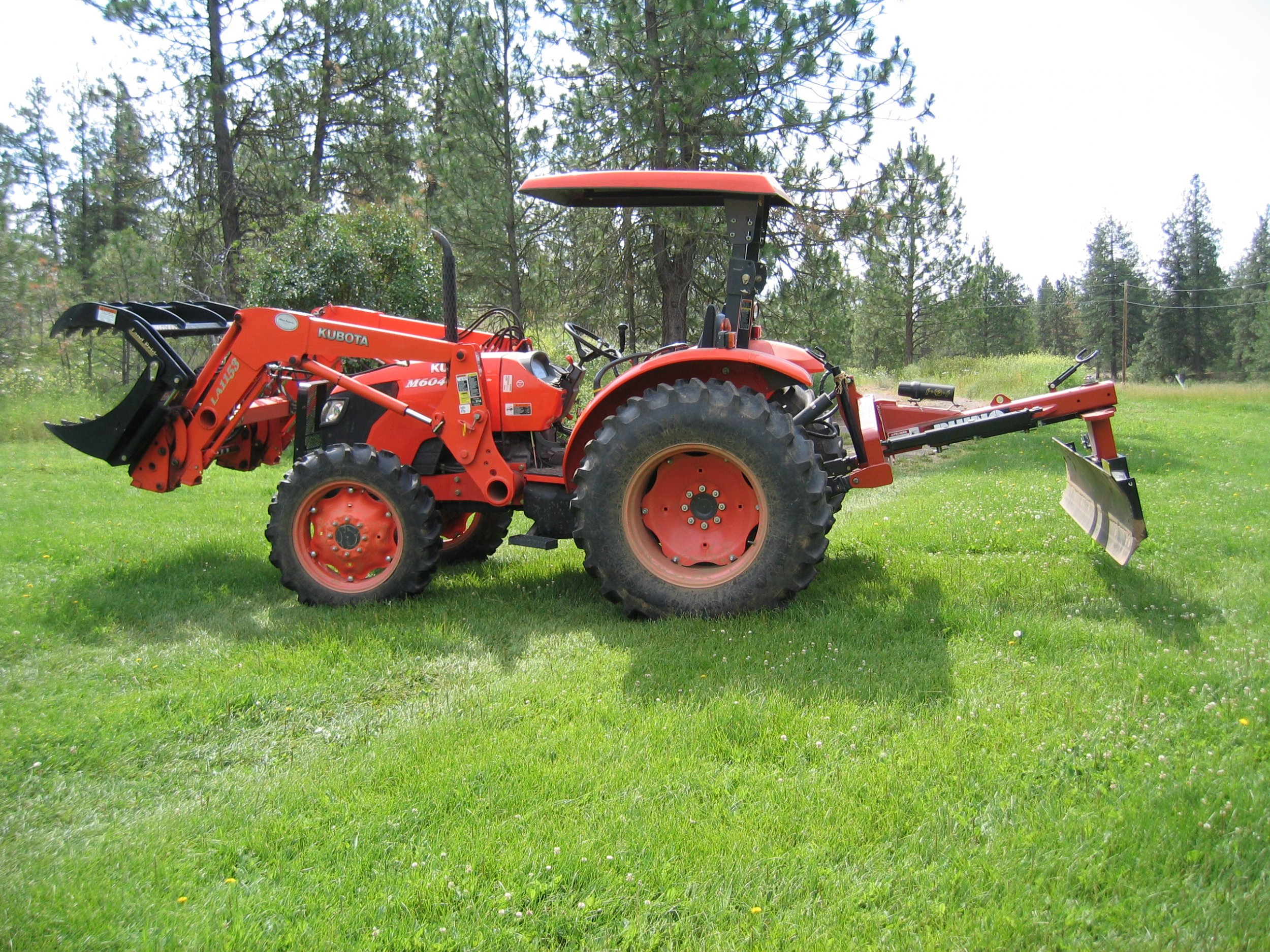

For 25 years I used a PTO driven blower to clear the berms on my mile long gravel driveway. I had a 26hp Ford 1700 4WD. I could easily clear a foot of fresh snow with the rear blade. As the winter went on and I cleared the driveway with the rear blade - the driven path would get narrower and narrower. That's what the blower was used for. Blow those nasty berms.
Man - did that ever get old. Three plus hours with the blower to clear the berms - the mailbox area and the buildups in and around the yard.
Trying to use mirrors never work for me.
If you can go fast enough - 4 to 5 mph - the rear blade might do the job just fine. You have to be able to curl the snow enough to get it off the driven path. Then you have to have the weight to clear the berms that will form. My Ford 1700 had the power - it just didn't have the weight to maintain a straight path as I attacked the berms.
So I upgraded to a brand new Kubota M6040 in 2009. The berms are no longer a problem. With my HD grapple - Rim Guard in the rear tires - HD rear blade - the tractor weighs 10,100#.

There is another consideration. Using a rear blade. When you angle a rear blade to plow snow - you loose effective width. A five foot blade - angled - may only clear a four foot or less path.
The rear blade on my Ford was 84". It would clear a ~ 70" path when angled. The blade on my Kubota is 96" - it clears a ~ 78" path.
Both of my rear blades would angle, offset and tilt. Offset and angle are nice. They allow snow to be bladed off the driven surface and you don't have the tractor right on the bloody edge of the driveway.

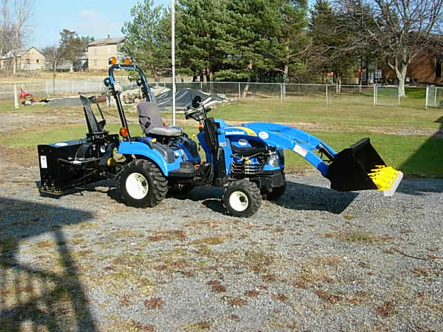

/ PTO snowblower? #7
A smaller machine has many advantages getting around a property. I have the pictured T1030 & also a T1530. The smaller unit is the preferred snow tool.

WoW!! Twisp - Chainsaw. I was raised in Omak. Twisp, the Methow valley, Winthrop were some of my best stomping grounds. And, Yes - you can get some REAL snow up there in the Methow valley.
BTW - don't knock a smaller tractor. Smaller tractor = smaller bites.
