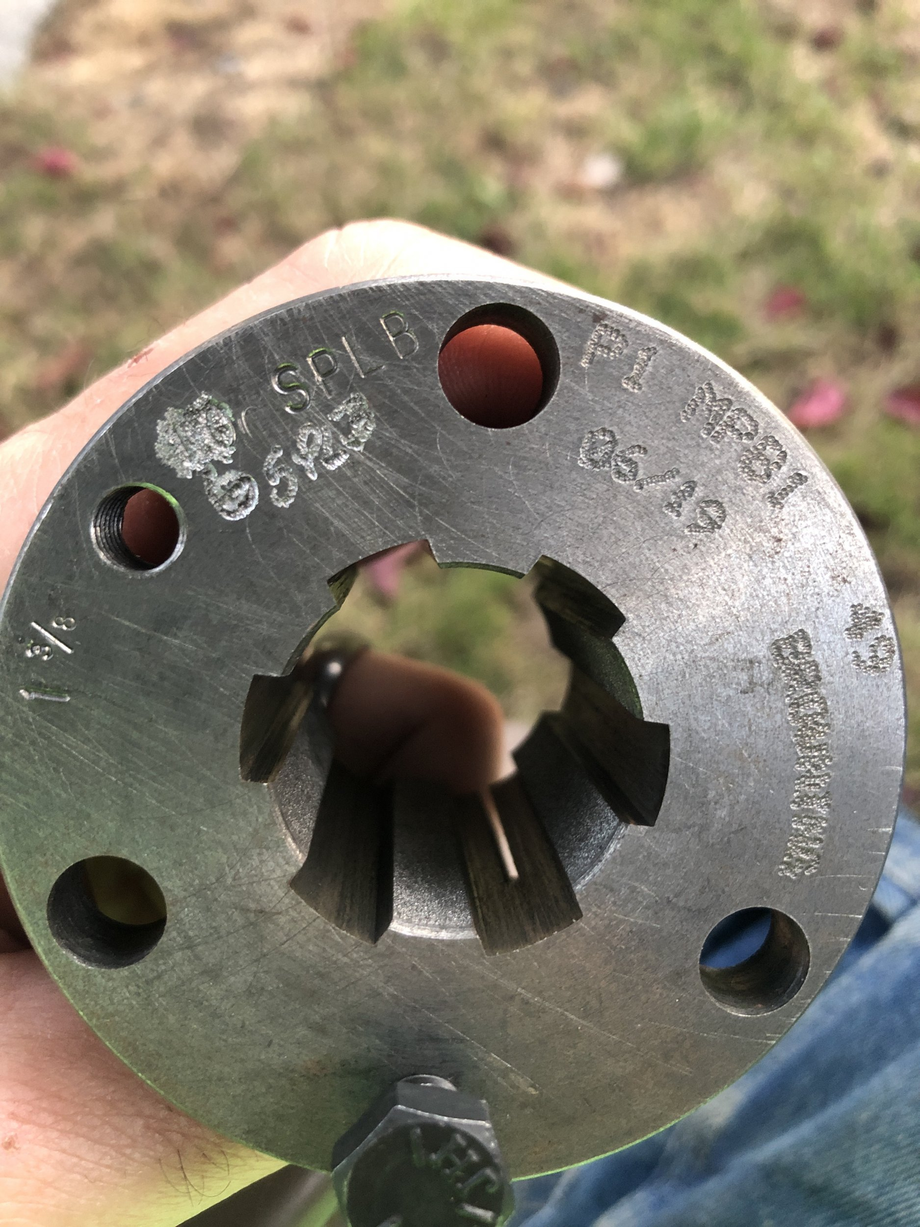

Well I found a bushing cut for the pto splines, its a split taper style. I purchased a belt pulley to go onto that bushing but, it was the wrong size bore for that bushing. Anyone know how the who split taper bushing world works? There are different sizes like H, SK, SX etc etc. I haven’t really been able to find info so I can figure out what alphabetical designation my bushing is.
/ PTO snowblower?
#43
Here’s a pic of the bushing.

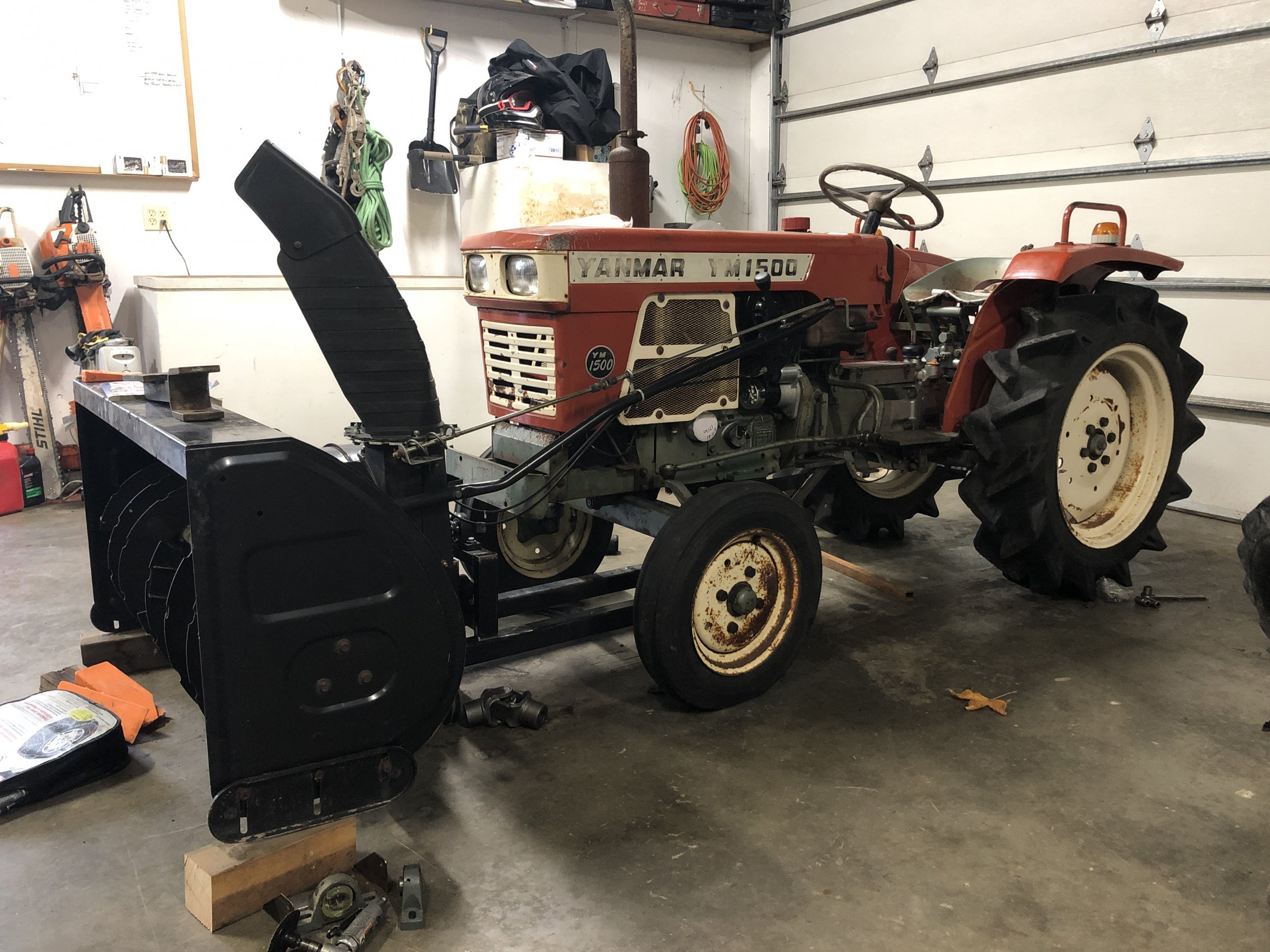

#58
I realized I’ve not post much for build pics so I’ll throw a few up here.
this is the chain drive used to chain the input height into the back of the blower. The top shaft had a pulley on it from when it was belt drive. Well I needed to lower the input so I could run my belly shaft low enough so that the blower could be lifted off the ground. Bottom shaft carries the drive shaft, Top shaft drives the blower.

#59
The home build drive shaft. Runs pretty good for a nit whit building it.

#60
Welp. This here is the report post. IT WORKED! WELL! Finally had a chance to get to the property, we had 14-16” of snow sitting on the ground, still fairly fluffy. The blower worked great! Would chuck snow about 20’ which is plenty for my needs. The only issue I had is where snow is pushed up into berms, and I try to cut those burns for foot paths etc, the blower loads up and the pulley drive in the rear will throw the belt off. I did find if I got into a berm I would throw the trans into neutral and let the blower catch up it work through it. But I’m going to try two belts, and go to a heavier tensioner spring. Aside from that I’m STOKED!
I do think I’ll ditch the 5’ blade on the rear though and just run a weight. The blade was more of a hindrance than anything.
